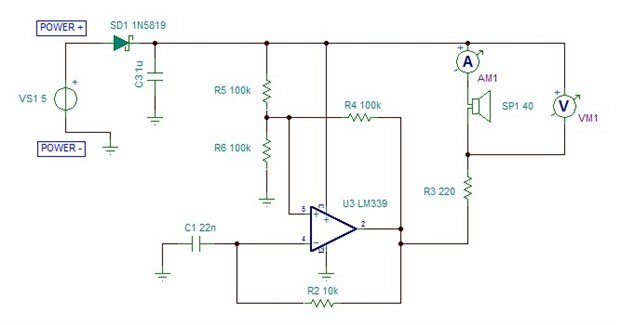

Here is the second half - the oscillator. I've just connected it with the 22nF capacitor. There's a voltmeter to measure the voltage across the speaker and an ammeter to show us the current through it.
Here are the waveforms. The waveform in the middle is computed by the simulator - I just asked it to multiply the volts by the amps to show power. It looks like the average power to the speaker is about 7mW. That's not all that much but we should be able to hear it and it keeps the power consumption of the probe quite low.
