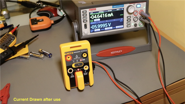

For a little further investigation, I hooked the proving unit up to a 6V DC power supply to measure the current drawn.
                                             1) On initial power up the unit draws circa 16nA
                                             2) Using the finger test button test draws around 105mA
                                             3) Testing the T110 on the proving draws around 160mA
                                             4) After the first test, the unit drops back down to 16nA
                                             5) After a second test, the unit drops back down to 4.5mA
{gallery} PRV240FS Current Tests
The Toshiba batteries don't have an Ah rating on them, but an internet search suggests that AA Alkaline batteries have a rating between 1700mAh and 3000mAh. The intermittent 4.5mA drain observed would therefore fit in with draining the AA batteries over a seven week period.

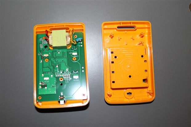

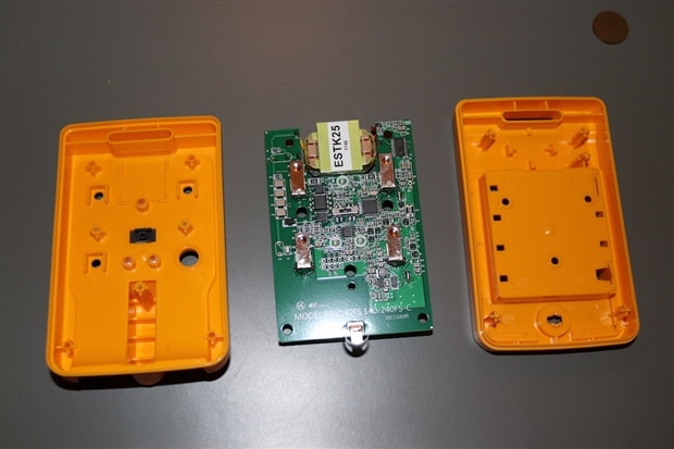

Working with the idea from Gene in the comments below, I have dismantled the proving unit to see what the possibility would be of adding in a small switch. Mechanically, as the pictures show, there would be space at either end, to add in a small switch. Electrically, there are some issues with interrupting the power.
{gallery} PRV240FS Dismantled
PRV240FS opened up
Board in top part of enclosure with base removed
Component side of board
Underside of board showing battery connections
Field sense end of case
Transformer end of case
Case Length
Bottom case height
Battery positive terminal
Component side of battery positive terminal
Battery negative terminal
Component side of battery negative terminal
From the photos, it can be seen that the battery terminals are soldered directly to the PCB and make electrical connections on both sides of the board. However, I believe that the positive terminal just goes to a test point pad on one side and then SNBL1 component on the other side.
It may be possible to cut the track to the SNBL1 component and wire the switch in-between that and the battery connection.
A little bit more investigation required to find a suitable switch and identify the SNBL1 component.

Following on from the useful comments made by members of the element14 community, I had a go at installing a switch into the proving unit that broke the battery circuit and stopped the current drain.
I don't have a huge stock of electronic parts as I am more electrically biased, but managed to find a suitable slide switch that could be mounted in the front case. There is a thin internal web that I drilled to provide the mounting of the switch as seen in the first photo. The switch was a little wide, so I had to carefully cut back a small piece of the ridge, seen in the second photo, to enable the switch to sit correctly and go through the front case enough to allow it to be operated. The cut out can be seen from the front in the third photo and is reasonably unobtrusive, but hopefully prominent enough that I don't forget to use it.
I only had veroboard which seemed to be to thick to put between the one of the batteries and its terminal. I eventually settled on a small plastic piece cut from an old credit card that had just expired. It pushed neatly into the clips that hold the battery terminal in place. It did bend them slightly, but nothing to excessive as seen in the photo below on the left. This held the first wire in place behind the battery contact. The second wire for the switch was held in place using some aluminium foil tape seen in the second photo. I then trimmed down the aluminium foil with a craft knife.
The board sits very close to the back of the battery case, so I had to cut out a small section of the case to allow the wires to pass out of the battery case as seen in the third picture above. I then secure the wires with a little hot glue in the cut out and along the inside of the case to the switch.
The switch was successfully mounted and secured with two screws into the internal web. A slight downside is that the wire crossover form the bottom half of the case to the top half now, so the unit does not dismantle as easy as it did before as seen below.
The case was then reassembled and then using my current favourite insulation tester, I conducted a 20V insulation test with the switch open, which gave a 4GOhm reading and then a 200mA resistance test with the switch closed, which gave a 0.1Ohm reading.
I have a Brother P-touch printer, so made a little label up to finish off the modification shown in the first photo below. The work went reasonably well, the opposite battery terminal is now pretty much crushed up in comparison to the other terminals as can be seen in the second photo, the top battery contains the switch circuit, where as the battery below is unmodified. This may mean that the foil tape is damaged when the batteries are replaced, but with the wires glued into position, it should just mean stick on a new piece of tape when required.

    Donald, Looking at the pictures, there appears to be small surface mount switches under the two lower contact points. I assume that the probe insertion causes those switches to be pressed. Is it possible…

    Looking at the pictures, there appears to be small surface mount switches under the two lower contact points.  I assume that the probe insertion causes those switches to be pressed.  Is it possible to adjust those switches (shave down their buttons), such that they disconnect when the probes are removed?  I don't think that bending the contacts would be a good idea.
    Just a thought.
    Gene

    three-phase over 7 years ago in reply to genebren
    Yes, there are three individual push button switches, one for for each function of the tester.
    When the meter probe is pushed down onto the metal contact plate it operates the push button and activates which ever function is being used. The test voltage is then transferred onto the metal contact plate. Taking the probe out release the plate, which then deactivates the switch.
