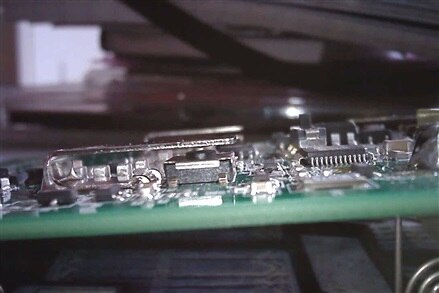

Working with the idea from Gene in the comments below, I have dismantled the proving unit to see what the possibility would be of adding in a small switch. Mechanically, as the pictures show, there would be space at either end, to add in a small switch. Electrically, there are some issues with interrupting the power.
{gallery} PRV240FS Dismantled
PRV240FS opened up
Board in top part of enclosure with base removed
Component side of board
Underside of board showing battery connections
Field sense end of case
Transformer end of case
Case Length
Bottom case height
Battery positive terminal
Component side of battery positive terminal
Battery negative terminal
Component side of battery negative terminal
From the photos, it can be seen that the battery terminals are soldered directly to the PCB and make electrical connections on both sides of the board. However, I believe that the positive terminal just goes to a test point pad on one side and then SNBL1 component on the other side.
It may be possible to cut the track to the SNBL1 component and wire the switch in-between that and the battery connection.
A little bit more investigation required to find a suitable switch and identify the SNBL1 component.

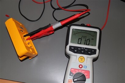

Following on from the useful comments made by members of the element14 community, I had a go at installing a switch into the proving unit that broke the battery circuit and stopped the current drain.
I don't have a huge stock of electronic parts as I am more electrically biased, but managed to find a suitable slide switch that could be mounted in the front case. There is a thin internal web that I drilled to provide the mounting of the switch as seen in the first photo. The switch was a little wide, so I had to carefully cut back a small piece of the ridge, seen in the second photo, to enable the switch to sit correctly and go through the front case enough to allow it to be operated. The cut out can be seen from the front in the third photo and is reasonably unobtrusive, but hopefully prominent enough that I don't forget to use it.
I only had veroboard which seemed to be to thick to put between the one of the batteries and its terminal. I eventually settled on a small plastic piece cut from an old credit card that had just expired. It pushed neatly into the clips that hold the battery terminal in place. It did bend them slightly, but nothing to excessive as seen in the photo below on the left. This held the first wire in place behind the battery contact. The second wire for the switch was held in place using some aluminium foil tape seen in the second photo. I then trimmed down the aluminium foil with a craft knife.
The board sits very close to the back of the battery case, so I had to cut out a small section of the case to allow the wires to pass out of the battery case as seen in the third picture above. I then secure the wires with a little hot glue in the cut out and along the inside of the case to the switch.
The switch was successfully mounted and secured with two screws into the internal web. A slight downside is that the wire crossover form the bottom half of the case to the top half now, so the unit does not dismantle as easy as it did before as seen below.
The case was then reassembled and then using my current favourite insulation tester, I conducted a 20V insulation test with the switch open, which gave a 4GOhm reading and then a 200mA resistance test with the switch closed, which gave a 0.1Ohm reading.
I have a Brother P-touch printer, so made a little label up to finish off the modification shown in the first photo below. The work went reasonably well, the opposite battery terminal is now pretty much crushed up in comparison to the other terminals as can be seen in the second photo, the top battery contains the switch circuit, where as the battery below is unmodified. This may mean that the foil tape is damaged when the batteries are replaced, but with the wires glued into position, it should just mean stick on a new piece of tape when required.
Many thanks to genebren, mcb1 and jw0752 for their suggestions and comments for ideas to resolve this, much appreciated.

    Donald, Looking at the pictures, there appears to be small surface mount switches under the two lower contact points. I assume that the probe insertion causes those switches to be pressed. Is it possible…

    I have updated the blog to include some photos of the proving unit dismantled. There does seem to be a bit of room to physically mount a small slide switch. Connecting in electrically may be a bit awkward and I will need to ensure what PCB tracks I will need to break to wire it in.

    Looking at the pictures, there appears to be small surface mount switches under the two lower contact points.  I assume that the probe insertion causes those switches to be pressed.  Is it possible to adjust those switches (shave down their buttons), such that they disconnect when the probes are removed?  I don't think that bending the contacts would be a good idea.

    mcb1 over 8 years ago in reply to three-phase
    I'd be looking at isolating the negative connection.
    It seems there are 4 small connections from the battery terminal to the ground plane, that seem to be easily isolated.
    The other option I use is a piece of mylar or simialr plastic slipped between one battery and the terminal.
    Yes you have to undo it, but it beats taking out batteries or flat batteries.

    three-phase over 8 years ago in reply to mcb1
    Yes, the negative pad on each side of the board appears to have connections to the ground plane, so I would have to do both sides. I presume you have suggested that method to avoid soldering onto the passive component and possibly causing heat damage.
    I must admit that I hadn't thought of that and just went for the least amount of soldering method!
    I did think about popping the batteries out, which is ok for short term, but the battery compartment securing is only a plastic quarter turn fastener, so I was a bit concerned that clumsy thumbs here would damage it sooner or later with repeated use.
    Thanks for the suggestion.
    Afterwards I had a sudden thought.
    The board isn't 4 layers with a ground plane in the middle is it.?
    The negative terminal suggestion was because it looked like the easiest solution and very easily put back if you wanted to.
    The other crude way is double side pcb between the batteries and a cable with switch wired across the side.
    You could possibly add the switch neatly inside with no modifications to the circuitry.
    I believe it is a standard double layer PCB, I can see a torch shine through from one side of the board to the other and I cannot see any ground plane at any of the edges or at the through holes for the PCB mounts.
    The PCB option may be crude, but may be an easy option for me.
