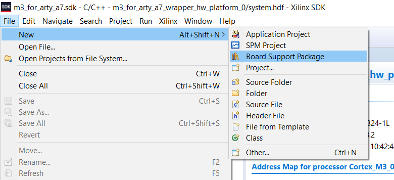

Just like we do for MicroBlaze and Arm A9, A53 and R5 developments, we need to create a Board Support Package. We can do this selecting File->New->Board Support Package
This will open the BSP creation dialog, leave the project name as the automatic name and click finish.
Clicking finish will open a BSP configuration dialog, double check on the standalone tab the stdin and stdout are connected to the AXI Uart Lite.
Clicking OK will now build the BSP, you may see some warning but if done correctly you will see no errors. The next stage is to generate the ELF file which includes this BSP and the Application. However to do so we will not be using Xilinx SDK.
