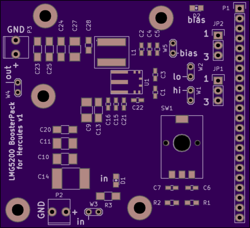

I'm trying to place all components similar to the application notes. This will be my first 4-layer PCB design.

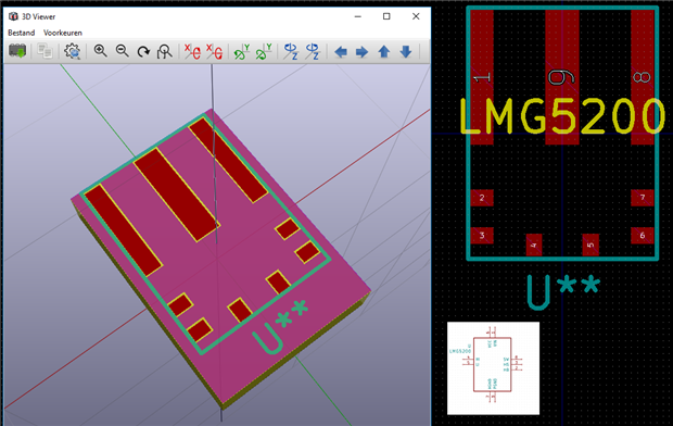

I had to create a few components and footprints (both for LMG5200 and rotary encoder, footprint only for the inductor).
For the PCB, I have a provisional layout. I haven't routed a single trace yet.
But I have uploaded that intermediate status to OSHPark to get an idea of how this device will look like.

    I don't know what you intend for the tracking (please don't say it's going to be a job for an autorouter, entertaining though that might be), but wouldn't it work better if you rotated P3 (the output connector) by 180 degrees. It would then allow you to have the power ground (input gnd - GaN - output gnd) as copper on the top layer. Since all the power tracking could then be copper on the top, you might consider whether it would work well enough as a 2-layer board.

    I'm using the layout advice in  the 'Layout Considerations for LMG5200 GaN Power Stage' appnote from the manufacturer.

    But both of those cases assume the power ground is on a lower layer. In that case the four-layer solution IS better than the two layer solution. But if you can have the power ground on the top, you don't need any vias and that's even better, isn't it?
    Jan Cumps over 10 years ago in reply to jc2048
    In the 4 layer configuration, that lower layer is just underneath the device, in the top-middle layer.
    In the two layer layout, the full PCB thickness is between the two.
    I'm going for the 4-layer option now (I'm no hero, am I?) and try to get that as close as possible to the appnote advice.
    If that works out OK, I can make make a second one with two layer, and have something to compare against.
    I'm not using the autorouter; I'm not even using normal traces for most of this board, but flood filled planes all over.
    I have example Gerbers of the appnote's PCB that I can learn from.
    Only the input part and the rotary encoder block will be normal traces.
