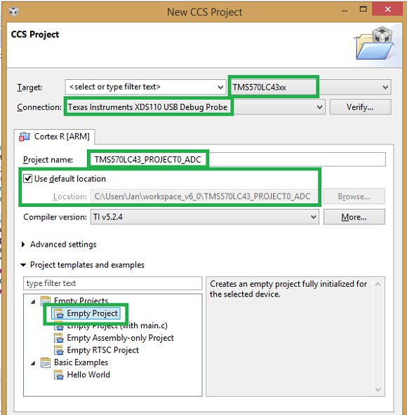

Create new project
File -> New -> CCS Project
Select TMS570LC43xx or RM57L8xx as target.
Use the XDS110 debugger.
Check that the location is the same directory that was used in HALCoGen above.
Choose Empty Project. HALCoGen has already created all source files we need.

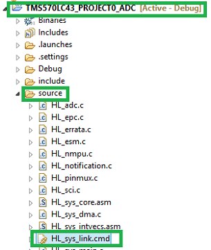

for HALCoGen Versions older than June 2015 only
replace the source/HL_sys_link.cmd file generated by HALCoGen by the one from this url:
http://processors.wiki.ti.com/index.php/LAUNCHXL2-570LC43-RM57L:_LinkerECCRecommendation or check Hercules Microcontroller: Correctly create and load Firmware with Error Checking and Correction (TMS570LC43 and RM57 specific)

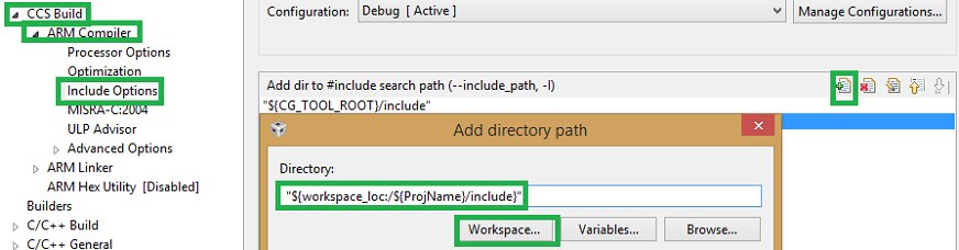

Set the Project Properties
Right click on your project, and select Properies
Add the HALCoGen generated include files to the project include path.
Set the Debug Flash options as documented on the url above.
