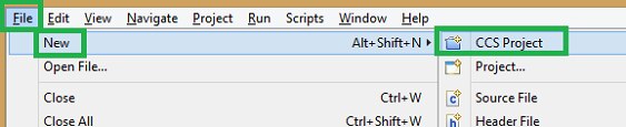

Write your Program in Code Composer Studio
Create new project
File -> New -> CCS Project
Select TMS570LC43xx or RM57L8xx as target.
Use the XDS110 debugger.
Check that the location is the same directory that was used in HALCoGen above.
Choose Empty Project. HALCoGen has already created all source files we need.
