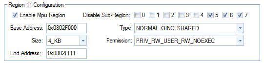

DMA needs some preparation. On the Hercules, the memory is by default configured to maximise caching.
It only writes info from cache to the real mem when it's needed by the core.
That's cool as long as it's only the ARM core that talks to that memory. But in our DMA set-up, that's not the case.
The SPI module will hit that memory in parallel with the core.
Any cashing scheme that doesn't immediately write through to the physical memory, fails. So we have to make special provisionings.
It would be stupid to make all memory write-through. That would impact the performance of our controller badly.
What we can do instead is to reserve a specific piece of RAM for the buffers, and make that shared.
We'll call this memory area SHAREDRAM. We'll steal this are from the normal configured RAM image.
I will create a buffer for one bitmap line. That's 128 colour values.

When we create a Hercules project for the RM46 controller (the one I'm using here), all RAM is in one chunk.
    RAM     (RW) : origin=0x08001500 length=0x0002EB00
And all that RAM has the following attributes:
For our DMA, we'll need better than shareable. So we'll steal 256 positions from the RAM, and make it write-trough.
You'll need knowledge of your linker command file for that. I've blogged about that;
So we'll first nick room for those 256 positions from our RAM (I'm taking room for more here) , and call that chunk SHAREDRAM.
    RAM       (RW) : origin=0x08001500 length=0x0002DB00
    SHAREDRAM (RW) : origin=0x0802F000 length=0x00001000
(see how we decreased the RAM part by 0x01000?)
Let's now refine the cache properties of that little chunk, and make it write-trough.
Both ARM core and DMA will have the same view of the memory from now on. Guaranteed.

    Jan Cumps over 10 years ago in reply to DAB
    DAB, the configurator I'm showing here for the memory set-up is merely a front-end.
    In the end, these settings are converted into instructions for both linker and memory initialisation code.
    I regularly get flack for using a GUI to configure these things. But it helps me tremendously.
    Nothing stays hidden from the designer. In the end this all becomes source code and tool chain config files.
    There are many ways to interfere with the configurator in source code, while keeping the round-trip functionality intact (changes in source don't break the configurator if done properly).
    It's also a great learning tool. You can see directly in the code what a configuration change does.
    The following config:
    Becomes c and assembler code:
    r11Base  .word 0x0802F000
            ; Setup region 11
            mov   r0,  #10
            mcr   p15, #0,    r0, c6, c2, #0
            ldr   r0,  r11Base
            mcr   p15, #0,    r0, c6, c1, #0
            mov   r0,  #0x000C
            orr   r0,  r0,    #0x1300
            mcr   p15, #0,    r0, c6, c1, #4
            movw  r0,  #((1 << 15) + (1 << 14) + (1 << 13) + (0 << 12) + (0 << 11) + (0 << 10) + (0 <<  9) + (0 <<  8) + (0x0B << 1) + (1))
    That doesn't take away my huge respect for people that do everything in source directly. Hats off. But I'm not one of them.
