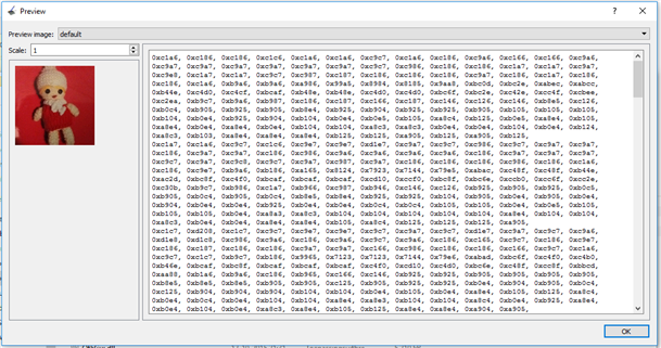

The image will be available in our code as a big array of pixels.
The array contains 16-bit values. Each position just contains the RGB colour of that particular pixel.
My LCD is 128*128. My array has 16384 positions.
I used Vladimir Rioson's LCD Image Converter - I'll have to spend another blog on the process to get the data in firmware
