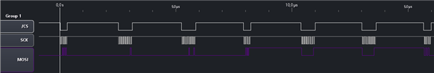

The analyser trace looks like this:
And the protocol analyser tells us:
Almost 20 µS for a pixel. My SPI clock runs at 27.5 Mbits per second.
13 bytes per pixel is 1664 bytes for one line of 128 pixels.
2.6 ms per line (20µs x 128). 328 ms for the whole 128 x 128 bitmap.

We still spend the same time for these activities as in the previous implementation.
16 µS to get the LCD screen initialises. For a whole line now.
Beaming the full line of data, 128 x 2 bytes, took us 360 µS
The total time to draw a line decreased from 2.6 ms per line to 376 µS.
