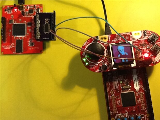

    Here's the test set-up:
    A Hercules RM46 LaunchPad. The RM46 is part of TI's Hercules family. This one is specialised in industrial and medical applications.
    Loads of safety features on that controller, including 2 ARM Cortex cores in lockstep. Each processor instruction is executed on both cores, and then output is compared.
    All peripherals have redundant functionality - also for safe operation under harsh conditions. Memory consistency is checked at each instruction.
    A Educational BoosterPack MKII, with 128  128 full colour display.
    For this exercise, I'm moving loads of data via SPI to that display.
    The BoosterPack has been idle in my lab for months. It didn't work on the Hercules LaunchPad by default.
    It was only when I could lay my hands on a TM4C LaunchPad - where the display works - that I was able to understand its functionality, leading to my port of the display driver to Hercules.
    I have to admit that starting without a working implementation, just with the datasheets, is not my forte. I respect everyone who can.
    The Papilio Pro FPGA board that serves as my logic analyser and protocol decoder. In essence, this is just an FPGA running on its own, doing both the sampling and the communication with the GUI on my computer.
    The only other logic on the Papilio is some flash t store the configuration (although not essential for this application; I could load the config to the FPGA at runtime if I wanted) and a USB chip (affraid to name it, because shabaz would chime in).
    A few humble parts. LaunchPad + BoosterPack less than $50 together. The Papilio around the same amount if I remember well.
    Endless joy and learning power.
