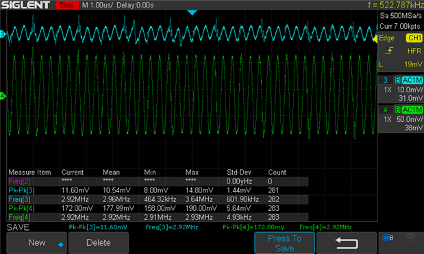

Ch3: +5Vout
Ch4: -5Vout
The board population has had a positive impact on the +5Vout signal although there is still ripple and noise.  -5Vout is being measured properly here and shows how bad it actually is compared to image 2.  The regulator is oscillating and not at all stable - as discussed in this post.
Image 6
Ch3: Output of the DC-DC inverter
Ch4: -5Vout
The -5Vout signal was oscillating because of an assumption I made regarding the ESR of the output capacitor so I replaced the C19 1uF output mlcc for a 10uF electrolytic capacitor and placed a 22uF electrolytic capacitor in parallel to C18.  That has stabilised the output and reduced the ripple down to 800uV with noise peak to peak of 3.95mV (mean.)  The 22uF capacitor also had a significant impact on the ripple output from the DC-DC investor which was 320mV peak to peak beforehand (no image in this post.)

To try and improve this further, I added a 10Ohm/10uF mlcc low pass filter after the -5V regulator (R20 populated with 10Ohm, R22 populated with 10uF and C34 populated with 0Ohm jumper.)  I also removed C18 0.33uF capacitor leaving just the 22uF capacitor for input.  This has reduced ripple to 680uV and noise peak to peak to 2.83mV (mean).  The LPF has reduced the output voltage from -5.011V to -4.85V but given its purpose - the negative input to OpAmps - this is not an issue.

This is a better view of the 12Vout signal which is very noise.  The 5V regulator deals with it pretty well giving a ripple of 1.2mV with noise peak to peak of 3.85mV (mean.)
Image 9
Ch3: 12Vout (+5V regulator in)
Ch4: +5Vout
To try and address the 12V regulator output ripple, I added a 22uF electrolytic capacitor in parallel to C33, it's output capacitor.  Additionally, I added a 47uF electrolytic capacitor to +5Vout in parallel to C16 (a smaller capacitor made no difference and a larger one made it worse.)  This seems to have reduced the ripple to 640uV and noise peak to peak to 2.56mV (mean.)
