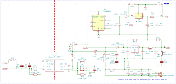

Power Section Circuit
(See this post for the full circuit.)
This is intended to provide the following power rails:
  • +15Vin: to drive the power section.
  • +5V: to power DACs, ADCs and other ICs
  • -5V: to provide a -ve source for Op Amps to enable rail-to-rail operation down to 0V
  • +12V: to provide a source to drive a fan.  It also provides a source for the +5V regulator and the DC-DC charge pump which inverts it for driving the -5V regulator
  • +5Vdd: to provide an isolated +5V source to drive a microcontroller and signal isolation ICs.  This is generated from a DC-DC isolating convertor.
The critical power rails are the +5V and -5V which drive the sensitive ICs.

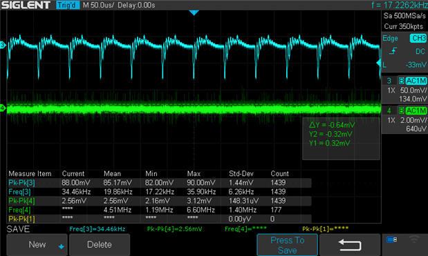

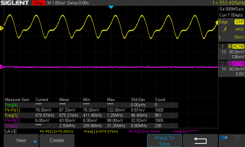

Image 1:
Ch1: +15Vin
Ch2: +12Vout

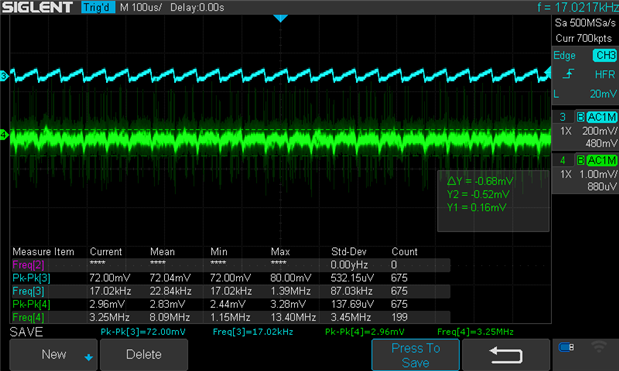

I'm driving the board with a relatively cheap 15V 1.2A switching supply.  Nominally, it has a 150mVpp specification but that's under a very specific condition.  Here, it's not too bad at 87mV.  I should have expanded the 12V signal to better see it but the measurement is showing quite a range on the ripple.

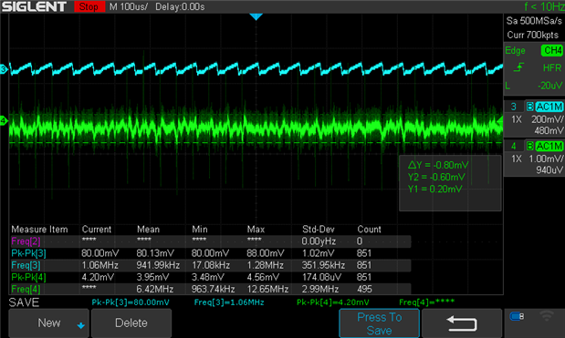

Image 2:
Ch3: +5Vout
Ch4: -5Vout
The +5Vout is picking up what I assume is switching noise propagated through the 12V regulator but has attenuated the ripple considerably.  The -5Vout is a disaster and, in actual fact, is worse than shown as I mistakenly measured at x1 but left the probe switched at x10 - peak to peak ripple is actually 1.32V.  Clearly, something is wrong.

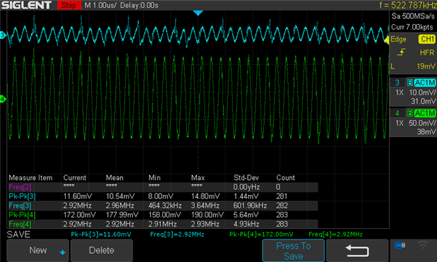

Image 3:
Ch1: +15Vin
Ch4: +5Vdd DC-DC isolator output
Interestingly, the 15Vin measurement is showing noise here which isn't apparent in Image 1.  The measurement in this image is taken at TP10, rather than TP11 in image 1 - I wouldn't have thought it made a difference but I suspect here, it's picking up noise from the RS6 DC-DC isolator.  As above, I should have expanded the +5Vdd signal but the measurement is showing a consistent 24mV noise range with ringing from the isolator and is in-step with the +15Vin signal.

Image 4
Ch1: +15Vin
Ch2: Ignore
The additional capacitance doesn't seem to make much of a difference - it's smoothed out the signal rise but the overall peak-peak measurement is worse.  Still showing noise.

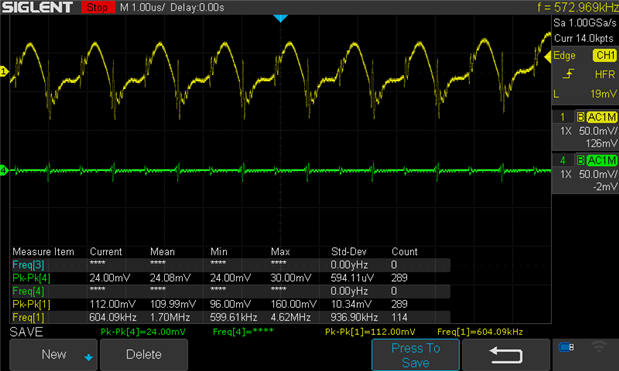

Image 5
Ch3: +5Vout
Ch4: -5Vout
The board population has had a positive impact on the +5Vout signal although there is still ripple and noise.  -5Vout is being measured properly here and shows how bad it actually is compared to image 2.  The regulator is oscillating and not at all stable - as discussed in this post.

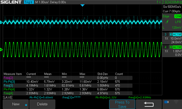

Image 6
Ch3: Output of the DC-DC inverter
Ch4: -5Vout
The -5Vout signal was oscillating because of an assumption I made regarding the ESR of the output capacitor so I replaced the C19 1uF output mlcc for a 10uF electrolytic capacitor and placed a 22uF electrolytic capacitor in parallel to C18.  That has stabilised the output and reduced the ripple down to 800uV with noise peak to peak of 3.95mV (mean.)  The 22uF capacitor also had a significant impact on the ripple output from the DC-DC investor which was 320mV peak to peak beforehand (no image in this post.)

Final Changes
The circuit now looks like this, with the changes highlighted.
