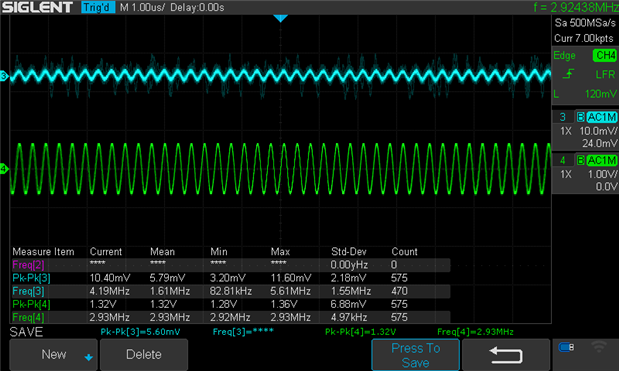

Image 5
Ch3: +5Vout
Ch4: -5Vout
The board population has had a positive impact on the +5Vout signal although there is still ripple and noise.  -5Vout is being measured properly here and shows how bad it actually is compared to image 2.  The regulator is oscillating and not at all stable - as discussed in this post.
Image 6
Ch3: Output of the DC-DC inverter
Ch4: -5Vout
The -5Vout signal was oscillating because of an assumption I made regarding the ESR of the output capacitor so I replaced the C19 1uF output mlcc for a 10uF electrolytic capacitor and placed a 22uF electrolytic capacitor in parallel to C18.  That has stabilised the output and reduced the ripple down to 800uV with noise peak to peak of 3.95mV (mean.)  The 22uF capacitor also had a significant impact on the ripple output from the DC-DC investor which was 320mV peak to peak beforehand (no image in this post.)

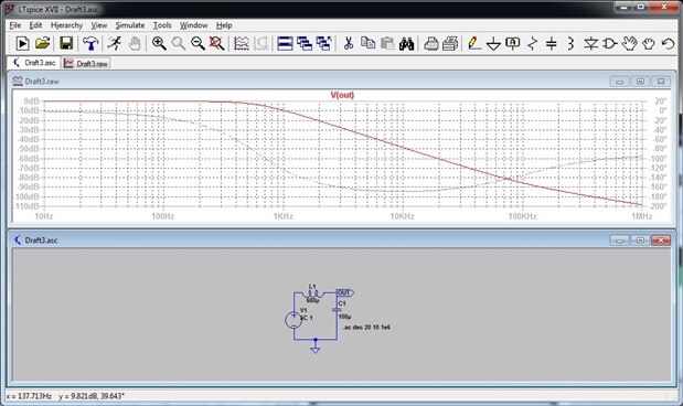

    Despite what I said in my last comment about leaving the -5V rail with a RC filter, and as I'm going to re-do the PCB, I'm feeling inclined to build up two versions of the +5V and -5V rails.  I've been looking at your circuit and I think it would be interesting to compare the two.  I did have some questions though to help my understanding.
    You did say you liked "real filters with big inductors and caps"!  Do such large sizes have any other implications besides the overshoots (and ignoring cost/board space implications)?  The cut-off frequency of the filter is 610Hz and the resonant frequency is also 610Hz - was the values selected to do that?  I assume that any noise at that frequency will be magnified but higher frequency noise is going to be attenuated so where the noise is high-frequency, the low resonance frequency isn't much of an issue?
    The 3.3V regulator is fed from the filtered +5V output so I assume its output has the same low ripple/noise as the +5V output?
    You mentioned "...but beware that there will be a large difference between the zener clamping voltage and its "zero" current voltage".  I don't really understand what you mean and I haven't been able to figure it out by reading about zeners in more detail.  Could you explain a bit more please.
    You'd shown this on an earlier post and gave the values of the output caps on the regulators as 470uF.  I'd not even considered such high capacitance values on the output of the regulators - were these chosen for the requirements of your supply or something you again "like to have"?
    The TPS60403 is an unregulated charge pump inverter and you are feeding it from your 5V regulator (pre filter.)  In my circuit I actual run the +12V through a charge pump inverter and then a -5V regulator.  This is to generate a -5V rail for opamps - a 'typical load' in the TPS datasheet.  Although the output is unregulated, given its purpose I don't see a problem with doing the same with my circuit and saving a number of components (the -5V regulator and its supporting capacitors) - I presume the output LC filter handles the noise and ripple well?
  • michaelkellett
    michaelkellett over 5 years ago in reply to Andrew J
    The design with the 470uF is for a power amplifier which draws a good bit more current.
    The values of 680uH and 100uF are chosen for maximum inductance in a reasonable (quite small) size. The current drawn is low so the resistance of the inductor is not a big problem.
    This is a simulation of the filter, no load, inductor resistance = 4 ohms, capacitor series R  = 0.016 ohms.
    No more time today, I'll try and do the transient response (and explain the zener) tomorrow.

  • michaelkellett
    MK
    • Vote Up +5 Vote Down
  • michaelkellett
    michaelkellett over 5 years ago in reply to michaelkellett
    Here's the transient response:
    A not very alarming 60mV of overshoot. But this is with a voltage source with 5ms risetime, a switching power supply with its own feedback loop may react very differently and would need to be simulated with the filter.
    MK
  • Andrew J
    Andrew J over 5 years ago in reply to michaelkellett
    Thanks Michael.
    Operation of the filter with a cheap smps would be something to test and measure for sure - gives me some ideas for the next PCB iteration.
    The Spice circuit you built for the transient uses a 10uF rather than 100uF cap?
