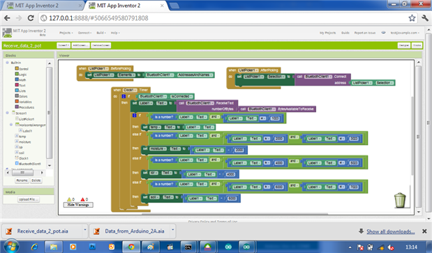

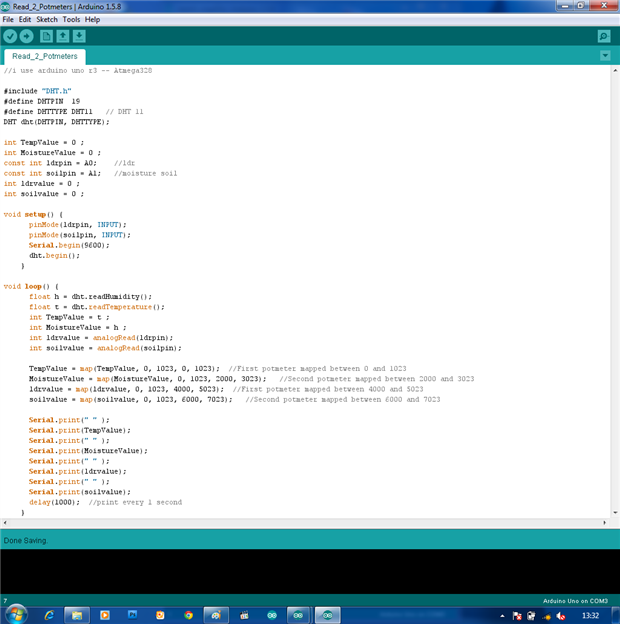

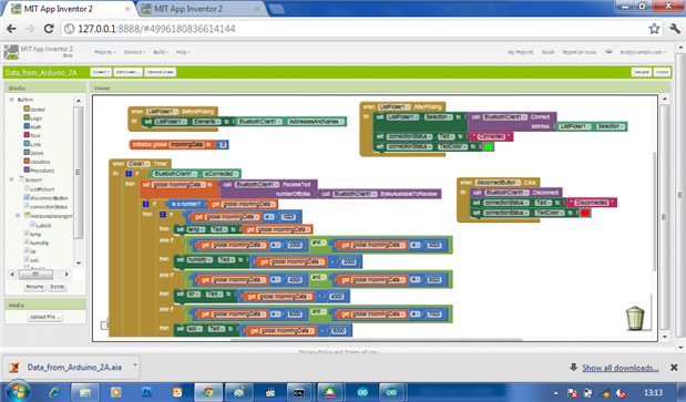

    Hey everybody... Could You Do Me a Favour? I got problem here when I'm trying to make android app using AppInventor2. I'm going to make android app to showed data "TempValue", "MoistureValue", "ldrvalue…
    Hey everybody...
    I got problem here when I'm trying to make android app using AppInventor2.  I'm going to make android app to showed data "TempValue", "MoistureValue", "ldrvalue", and "soilvalue". I'm trying to make it by modified your project namely "Data_From_Arduino_2A" and "Receive_Data_2_Pot" , but none of them working.
    Help me please.
    Regards
    - Jati -
    I used HC-05
    This is my arduino code. I'm going to make android app to showed data "TempValue", "MoistureValue", "ldrvalue", and "soilvalue".
    I modified from "Data_From_Arduino_2A" and I add more 2 sensor's data.
    And this one I modified from "Receive_Data_2_Pot" but none if them showed data. Please help me. Thanks.
    Regards - JATI.
