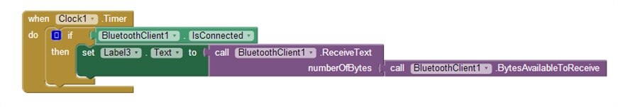

We then add the following new Block to receive and display the data:
In the Design screen, I left the default timer interval on the Clock at 1000mS because we want to have time to actually read the Android display.

Edited on 10 August 2015........problems can arise if the Arduino Transmission and Android Receive delay times are set identically. This wasn't a problem for my set up, but seems to be for others. If you leave the Arduino delay at 1000mS, then reduce the clock/timer delay in App Inventor to 950mS, it should be good image
