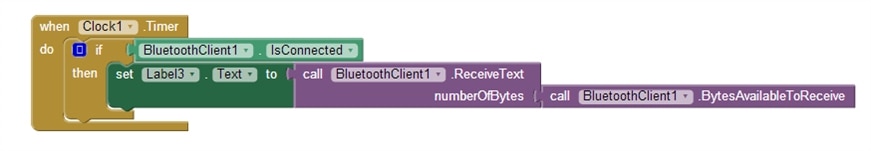

We then add the following new Block to receive and display the data:
In the Design screen, I left the default timer interval on the Clock at 1000mS because we want to have time to actually read the Android display.

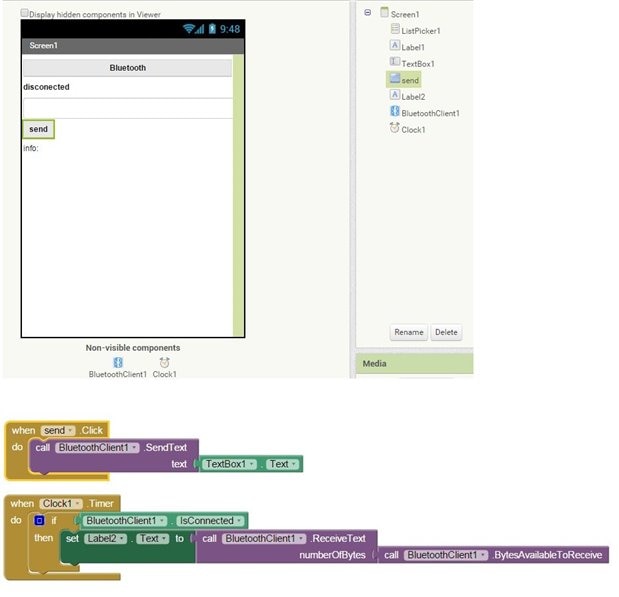

    Hey everybody... Could You Do Me a Favour? I got problem here when I'm trying to make android app using AppInventor2. I'm going to make android app to showed data "TempValue", "MoistureValue", "ldrvalue…

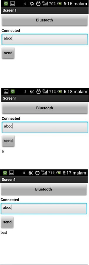

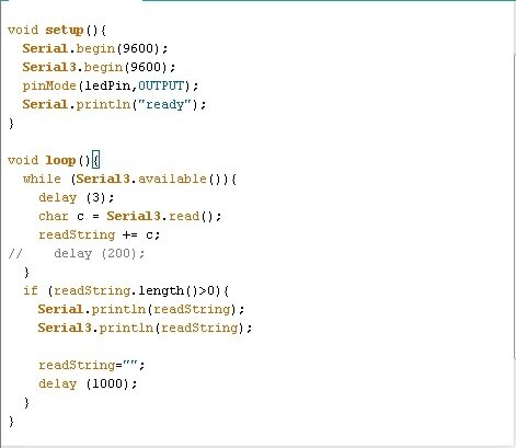

    neil i can solved my problem, i'm adding Serial3.print(" "); in my arduino program and use your arduino system
    thanks for that
    neil i have new problem, to print the string i must click button twice, after that string printed in my aplication
    can you help me, to make print string just once click? using the system above
    neil, i'm try your  system
    it's same output in application, like my figur3,
    im try write "abcd"
    the difference is i'm first click application print "a" and second click application print "bcd"

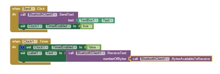

  • neilk
    neilk over 11 years ago in reply to e14 Contributor
    Hi tyas.partogi
    I have seen this problem before - the clock/timer in your Android is "running free", so there is no linkage between sending the data from the Android text box, and attempting to read the reply from the Arduno. This means that you can start to read the incoming buffer before the Arduino has finished transmitting.
    What you need to do is only read the incoming buffer a fixed time after you have sent the contents of the textbox to the Arduino
    First of all, in the App Inventor design window, untick the "Timer Enabled" box in the clock settings and set the Interval to, say, 100mSec
    then try this:
    It worked for me image
    Hope it works for you
    Neil
    Neil, I have problem. . .
    figure1
    figure2
    figure3
    figure4
    i'm make application like figure 1 and 2
    after i try the application serial monitor print string "abcd" like figure4, but my android application in first time print "a" and in second time print "bcd" like figure3
    can you help me to solve my problem? i need aplication can print "abcd" like in serial monitor
    *i use serial3 because, i use 2 communicatiion serial to make some device
    if i can't solve this problem i can't continue my device
