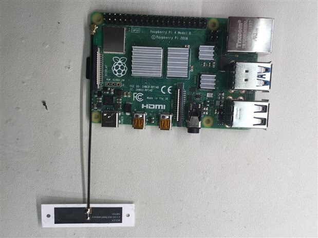

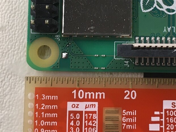

As a leftover from a previous roadtest, I am also the proud owner of a PaspberryPi4 B. This mighty little computer did have bad WiFI performance in the basement, with the router being one floor up and across the house.
= imageimage

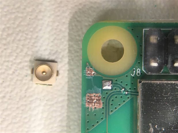

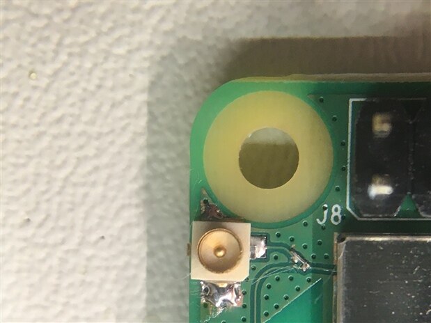

A close look at the board shows a very interesting layout for the PCB antenna. I don't even want to start thinking about, what is going on there in the RF domain.

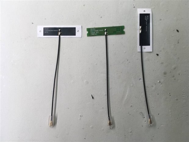

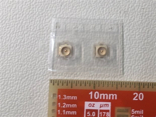

The part that interested me most, was the empty footprint at the feed trace and the single contact, suggesting a mounting option for an UMC connector. The antenna Kit did contain a nice selection of dual band 2.4/5 GHz WiFi/Bluetooth antennas with UMC connections as well. One Digikey order later, a fitting part ended up on my desk. In the spirit of the giveaway, it is a Molex UMC receptable 50 Ohm SMD, part number 073412-0110.
A banana for scale would not work very well, so I used my EEVblog measuring stick.

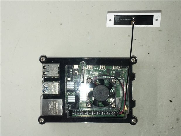

The next steps are: cut trace, add wire bridge, scrape scrape scrape, solder connector in place, plug in antenna, done.

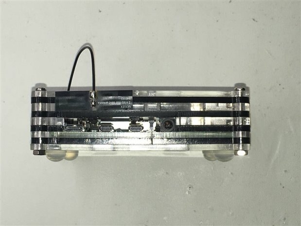

One of the camera connector slots in the housing is a perfect feed-through to get the antenna out. And there is 'plenty' of room to stick it somewhere to secure it.
A quick test, did reveal an improvement in WiFi signal strength.
= image.image
I am sure, there is some programs around to give more detailed WiFi signal strength information, but I am happy as it is. So no 'apt get ..........' session tonight, that would take longer than the hardware upgrade.

    jkutzsch : I have some more results: as expected, unplugging the new antenna really kills the Wifi range. It detects the network up to 2 meters away from the router in line of sight or through a thin North…

    wolfgangfriedrich over 5 years ago in reply to wolfgangfriedrich
    jkutzsch:
    I have some more results: as expected, unplugging the new antenna really kills the Wifi range. It detects the network up to 2 meters away from the router in line of sight or through a thin North-american wall with the router right next to the wall. Everything further away ends up with a un-connected RPi.
    And I learnt another Linux command:
    sudo iwlist wlan0 scan
    outputs a lot of stats about the network including signal strength in dB.
    This can be useful to characterized WiFi coverage.
    The output is in the form of:
    Channel:157
    Frequency:5.785 GHz (Channel 157)
    Quality=45/70  Signal level=-65 dBm
    Encryption key:on
    ESSID:"FibreOP444-5"
    Bit Rates:6 Mb/s; 9 Mb/s; 12 Mb/s; 18 Mb/s; 24 Mb/s
              36 Mb/s; 48 Mb/s; 54 Mb/s
    This is going to help for some future tests. Now let's build a turn table or source the lazy Susan from the kitchen cabinet.
    - W.
