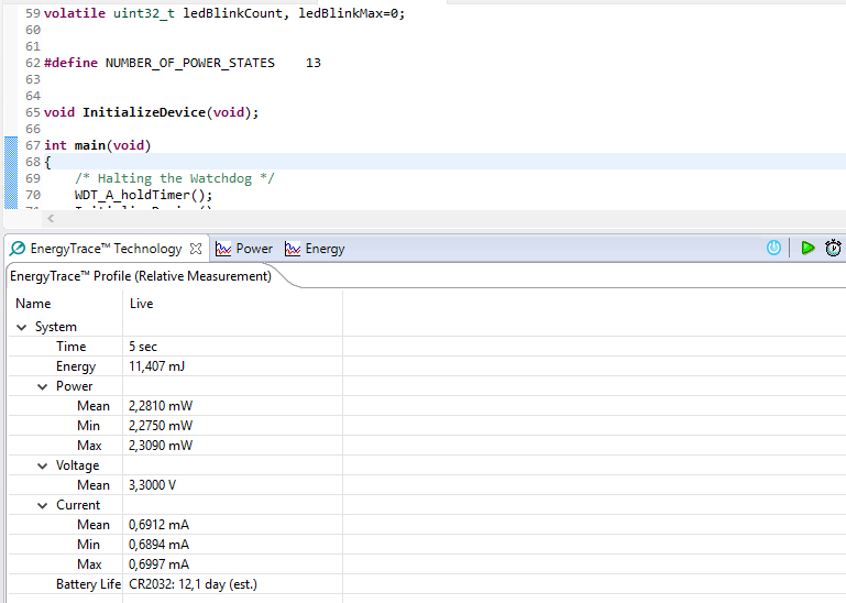

The CCS module is called EnergyTrace. It will sample the current that the MSP432 eats, and display it in some neat ways:
  • You can check how much time (or %) the processor spends in high and low power modes. You can trace watts consumed and energy spent.
  • You can give it a battery profile, and it'll show how your firmware's energy budget fits in the accu's capacities (see what I did there?).
  • And it will predict the battery life.
  • It can beak down your firmware, telling how much energy is burned in each funtion - based on runtime analysis.

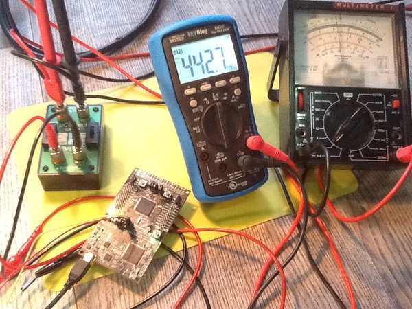

I wired a µCurrent in series with the 3.3 V supply to the controller - remove J3 and connect both pins to the current input of the µCurrent
The µCurrent is put in the 1 mV/µA range. The shunt resistor is 10Ω. The burden voltage never exceeded 8 mV. We can ignore that when the supply voltage is 3.3 V.

For each of the modes, I've written down the value measured on the µCurrent, and the mean value of 5 seconds sampling in EnergyTrace.

Now let's see how the retrieved value compares with my measurements. These data points are taken with the debugger active.
You see that we draw 200 µA more current at each step.
But what we see in these samples is that the figures are close.
The EnergyTrace results are certainly good enough to investigate the controller's power profile in your design.

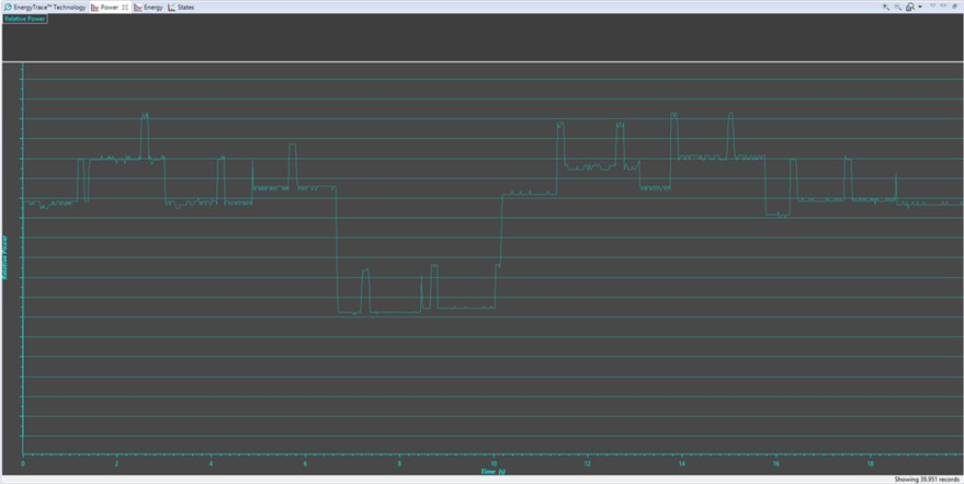

This isn't bad, is it?  On a graph, you can see how close they are:
The EnergieTrace graph capture below is showing a multiple second sample exercise. Each peak is when I push the LaunchPad user button to switch to the next power mode.
