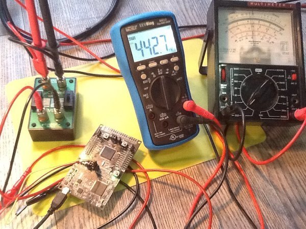

The Testbed
I used the power mode example from the MSP430 Deep Dive tutorial as firmware.
You can load this MSPWare project from the CCS Resource Explorer (Menu: View -> Resource Explorer (examples)).
I wired a µCurrent in series with the 3.3 V supply to the controller - remove J3 and connect both pins to the current input of the µCurrent
The µCurrent is put in the 1 mV/µA range. The shunt resistor is 10Ω. The burden voltage never exceeded 8 mV. We can ignore that when the supply voltage is 3.3 V.
The firmware steps through a variety of power modes.
For each of the modes, I've written down the value measured on the µCurrent, and the mean value of 5 seconds sampling in EnergyTrace.

When you run the MSP432 in debug mode, it automatically consumes more energy - current rises 200 µA (and power is constant at 3.3V).

µCurrent wo debugger
448
558,6
447,1
483,6
95,7
104,5
442,2
453,4
400
423,9
87,9
95,9
499
533,7
The table shows a mix of high and low power modes, some with clock slowed down. 88 µA (290 µW if you know that the supply is approx. 3.3V) was the lowest measurement.
