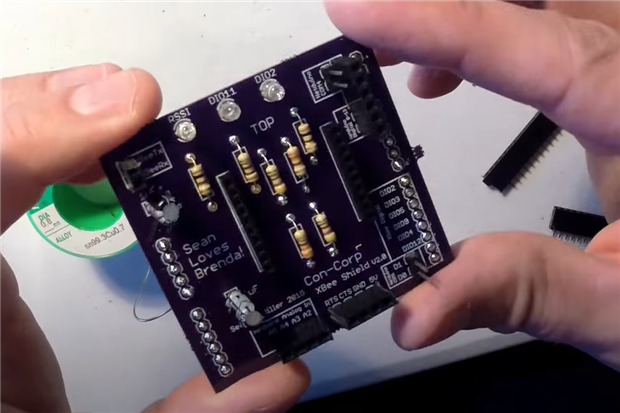

OSHPARK.com Fabricated Board from an Eagle Design - R2D2 Controller
So, you long have jumped from the bread board to protoboard so you can at least try to fit it in your project:

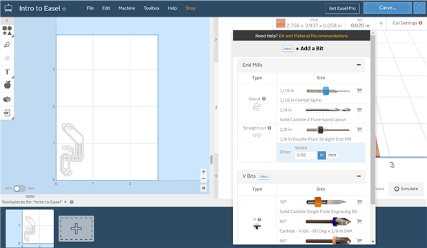

Easel, the CNC software, takes an SVG file.  So, I went to an online PDF to SVG converter called convertio.co:
Convertio.co for PDF to SVG Conversion
Easel is as easy as 123:  add your SVG file, add your material, and add your bit.  There is a one time setup for your machine type so it knows what its talking to - but that takes about 1 minute and for the 3018 mill, it already knew it.
Adding the Dimensions for my Material - PCB is a standard material within Easel
Selecting ones bit - I clicked "other" and set it to .02 in to keep it in the Free Version of Easel
When selecting the bit, I chose "other" set the diameter to 0.02".  That's because I actually had a v type engraving bit, but would have had to upgrade to the pro version to use it.  Close enough for horseshoes - again, I'm targeting mid-design cycle rapid prototyping here.  Not wanting to compete with a fabricated board.
For the depth, I found I'm best to set it virtually to zero (0.0005").  You'll see why once I tell you my trick.  At first I got all precise on setting my zero for Z.  I found that it engraved a little deep.  It made a functional board, but was just too goofy looking even for prototyping.
Setting the cut depth - basically setting the mill to darn near Zero
So, my final trick was when setting the Z, I actually ran the lead screw by hand until my actual V engraving bit poked the copper.  The copper layer is super thin.  Since the software always raises when not cutting, this ensured I'd get a cut regardless of the tolerance of the copper and machine.
