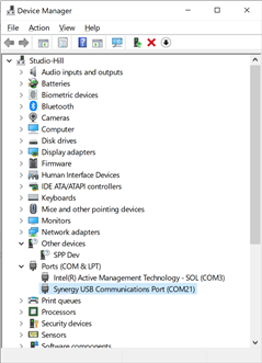

upon plug in with 2 USB cable, it is detected as portable device, which is wrong. by right it needs to be detected as port
In order to do that, need run the segger installation as mentioned above (run the batch file)
The driver is updated by selecting serial port (COM21 in my case) and update driver. point to the USB CDC folder
post installation, the port will look like this

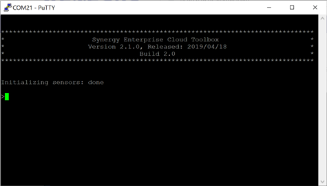

after restarting, it will light up a green and an orange LED. We then use terminal program to connect to it, press any key
and we will get to the screen below. the LEDs are now not lighten up
type ktid to get the device ID and register it with the Renesas Synergy. Following the video is easiest way https://renesasrulz.com/renesas-synergy-enterprise-cloud-toolbox/f/synergy-enterprise-cloud-toolbox---forum/9981/ae-clou…

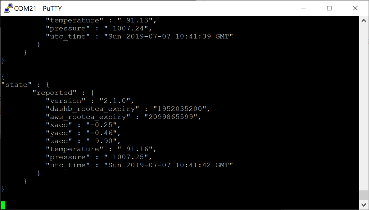

after that, we run turb start

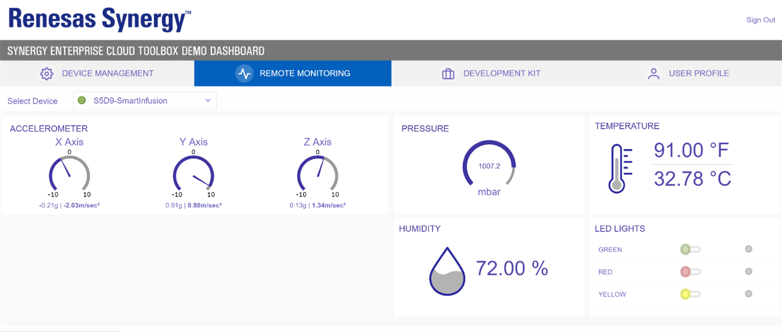

it will start sending data
on the synergy dashboard we will see this
