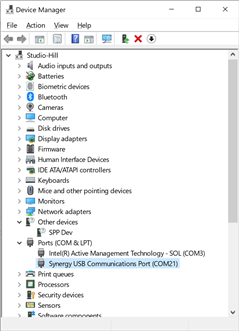

upon plug in with 2 USB cable, it is detected as portable device, which is wrong. by right it needs to be detected as port
In order to do that, need run the segger installation as mentioned above (run the batch file)
The driver is updated by selecting serial port (COM21 in my case) and update driver. point to the USB CDC folder
post installation, the port will look like this
The last step is to restart the board by power cycling it.
