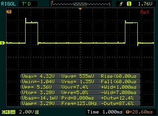

Disclaimer 2: The project doesn't deliver correct Servo signals. The PWM frequency isn't 50 Hz, and the pulse width isn't conform the servo PWM specs.
It doesn't matter. The only thing that I want to show here is that I can increase and decrease the duty cycle of the FPGA output with a rotary encoder.

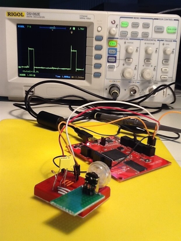

Wiring the Hardware
Look back at my first post to check how to components are wired up.
Then connect the encoder with the Papilio Pro.
CONFIG PROHIBIT=P144;
CONFIG PROHIBIT=P69;
CONFIG PROHIBIT=P60;
NET Clk TNM_NET = Clk;
TIMESPEC TS_Clk = PERIOD Clk 31.25ns HIGH 50 %;
NET Clk            LOC="P94"  | IOSTANDARD=LVCMOS33 | PERIOD=31.25ns;             # CLK
NET Servo IOSTANDARD = LVCMOS33;
NET Servo SLEW = FAST;
NET Servo DRIVE = 8;
NET Servo LOC = P48; # A0
NET QuadA IOSTANDARD = LVCMOS33;
NET QuadA SLEW = FAST;
NET QuadA DRIVE = 8;
NET QuadA LOC = P51; # A1
NET QuadB IOSTANDARD = LVCMOS33;
NET QuadB SLEW = FAST;
NET QuadB DRIVE = 8;
NET QuadB LOC = P56; # A2
Ground to Ground, 3.3V to 3.3V,
PINA to A1, PINB to A2. Oscilloscope to A0.
Load the bitstream to the FPGA and rotate the encoder.
You'll see that the output signal has a constant frequency and that the duty cycle can be controlled by turning the encoder.
