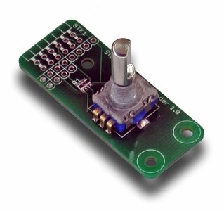

Xess has a plug-in board with a rotary encoder. I'm not using that module (called a StickIt!) - but I'm using the sample project that comes with it.
StickIt!
Hat Shield Cape Wing. All names were taken except the coolest one.
StickIt!s are tiny modules that work togethet with the XuLa.

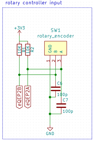

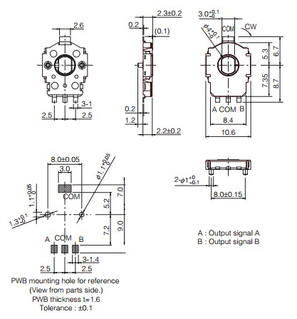

This is the schematic of my rotary encoder. It's identical to the Xess module - except that I've added debounce capacitors.
The encoder is a Panasonic EVQ-VVD00203B Square SMD Encoder.
That's not the same model as the one on the Xess board but it works the same. This one doesn't have a push-button built in.

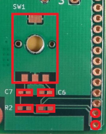

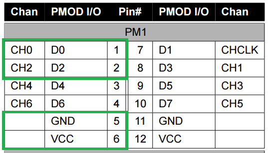

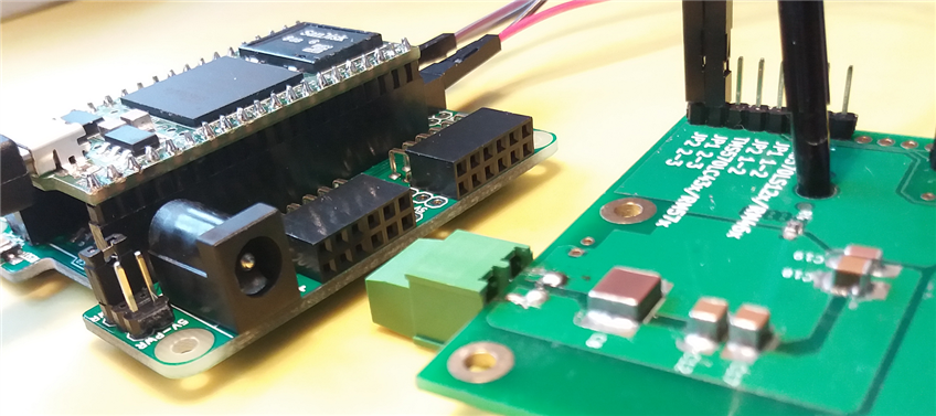

I'm plugging it into the PM1 of the motherboard. The power comes from the XuLA board, so you have to populate the XuLA PWR jumper and remove all others.
On this image you can see where you have to insert the jumper wires coming from the encoder.
Pin 6, VCC, goes to the 3V3 of the encoder circuit.
Pin 5, GND, to the circuit's GND
Pin 1, DO, to one of the encoder's switch contacts
Pin 2, D2, to the other switch contact.

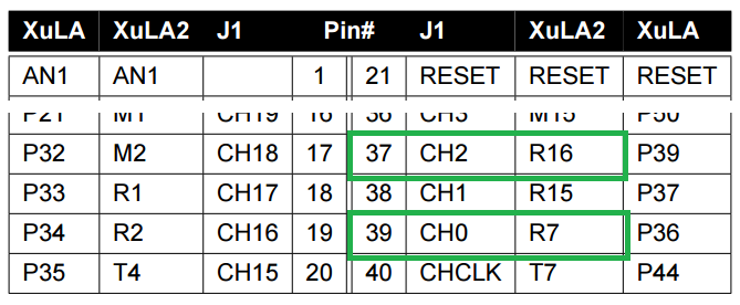

The table also shows the channel numbers. Use these if you work without the motherboard. They represent the XuLA2 pins.
In this table you can find the mapping between the channel number and the FPGA signal.
You'll use that to define the pins in your project's constraint file.

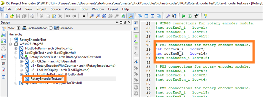

For the pins that I've used, this is the constraint info.
# PM1 connections for rotary encoder module.
net rotEncA_i   loc=r7;
net rotEncB_i   loc=r16;
Update your project's .ucf file to reflect that.

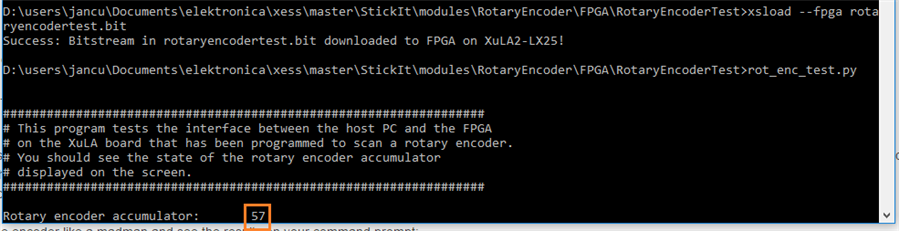

I haven't changed a single line of code. I just went trough the typical FPGA build steps and generated the bitfile.
> xsload --fpga rotaryencodertest.bit
Success: Bitstream in rotaryencodertest.bit downloaded to FPGA on XuLA2-LX25!
Then I used the Python test script that's part of the project. It checks the (defined in the VHDL project)  register that holds the accumulated value, and prints it to the command line.
To start the test, execute this command:
> rot_enc_test.py
Rotate the encoder like a madman and see the results on your command prompt:
