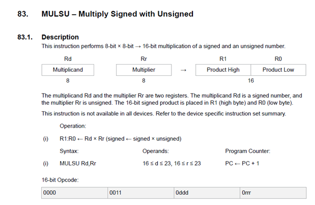

Originally, I assumed that the microcontroller wouldn't be able to do a multiply within the time between interrupts -
multiplying with a software library is time consuming -  however, my assumption was wrong - looking at the microcontroller's
datasheet I realised that it has a built-in 8-bit hardware muliplier that can produce a result in only two instruction
cycles.
The actual instruction I'm trying for is MULSU which multiplies a signed 8-bit value by an unsigned 8-bit value for a signed
16-bit result.
The signed operand will be the waveform data and the unsigned one will be the envelope value at that moment in time. The
result I'll mangle a bit to give an 8-bit unsigned value to send to the DAC port.
First problem, though, is that I'm programming it in C, and not assembler, so how do I make the compiler use the multiply
instruction I want? Is it clever enough to use the instruction when appropriate or will it always use some multiply routine
instead. I'm going to try casting the operands and the result to the appropriate forms and look at the timing to see what is
happening. Much to my surprise, that seems to work - I have an envelope and it still completes easily within the timer
interval.

Here's the end (the 'decay') in more detail. That's fine too. So, it looks like I've gotten all the signs and the
casting right.
My envelope generator isn't very sophisticated - just a ramp up and a ramp down - but I think you can probably see that the
