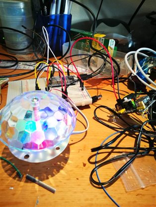

So the I have gotten the code to function as intended. So now for the hardware.

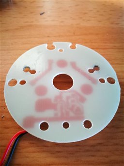

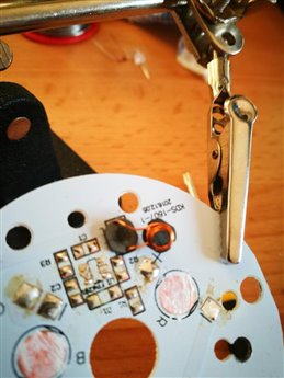

I started by depopulating the pcb that came with the original product. My original plan was to make an acrylic version with just the mounting holes, but realise if i flipped the pcb over, it would have the same effect.
The only component which gave me any trouble was the inductor, the contacts were soldered under the ferrite core, and in the end i just snapped it off, as i was not worried about keeping the PCB traces.
For the neopixels iI purchased some breadboard friendly ones from ebay (same price as most online retailers and no shipping cost) and simply hot glued them into place. The was to be able to replace them if needed.
And that is really all the hardware, the motor was connected through a transistor with diode protection. And it was ready for its first test.

    Hi Duncan, I wouldn't say your design is a fail as titled in your video. It looks good, but from reading your article you are disappointed with the brightness - maybe this is just version 1 in development…

    It looks (from Duncan's previous tear-down) like the case of that product is the heatsink. It would be much better with a metal-clad board, but it's nice that the heat is radiated off the exterior and not internally into the case.
    It's possible, looking at the board, that the person who originally designed it intended it to have an mcb and it's been subsequently cheapened (probably on the basis that something that runs for about an hour on three AA batteries probably won't be run for anything like 60,000 hours to test the LED lifetime).
    Once you get to 1W, there's a good case for a constant-current driver rather than resistors.
