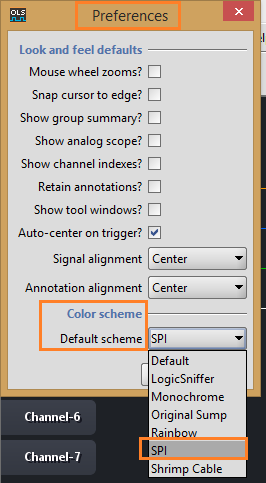

Configuring the Logic Analyzer
My Papilio FPGA board has logic analyzer duty.
As client, I'm using JaWi's Logic Sniffer client. I'm configuring it so that its colors match my drawings abd wires, and I've also labeled the signals to my naming convention.
Setting the colors and labels
The program doesn't save your color settings when you save a project. The easiest way to set the signal colors is by creating a color schema.
Just take one of the existing files in <ols_install_folder>/plugins, edit it as shown below, and save it under a new name.
<ols_install_folder>/plugins/ols.ui.colorscheme-spi

You can then select this color schema as your default:
You can rename the signals by double-clicking on them and typing the new name. These settings are stored when you save your project.
