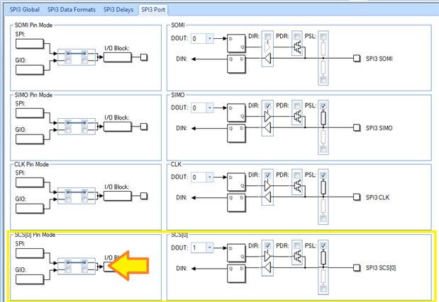

When configuring the SPI Bus HalCoGen, you have SPI_CS0 settings such as automatic so that the internal MCU module generates the control signal CS0 for enabling the external memory module 25LC256 (Microchip).
The result of this configuration, gives a signal CS, which changes state whenever the SPI (Hercules RMx) module finishes sending a byte by its bus.
in other words, send 1 byte and CS value change, this is what creates compatibility problems of Texas Instruments with Microchip series.
In the following Link my partner Jan Cumps explains how the SPI module is configured HalcoGen
Talk SPI to EEPROM with Hercules Launchpad - part 4: First Trial on the RM46
I make some changes to the configuration of the output pins, thus allowing me to my control signal CS, manually by program.
need change the configuration of CS [0], to work as a GIO
Extras configuration for the SPI module:
And
Codes for controlling the memory 25LC256 (Microchip)
As you can in the following example code, the control to the state of CS, and programming is not automatically generated by the internal SPI module.

    Jan Cumps over 11 years ago
    martinvalencia, have you tried the following with Chip Select (from the RM46 Technical Reference Manual):
    27.2.11.1 The CSHOLD Bit in Master Mode
    If the CSHOLD bit is set in the control field of a word, the chip select signal will not be deactivated until the next control field is loaded with new chip select information....
    Maybe if that works, it is not necessary to do the manual CS?

  • martinvalencia
    martinvalencia over 11 years ago in reply to Jan Cumps
    I remember reading this part of the datasheet, don't take much interest for reasons I don't remember :-)
    but I think jumping this much detail was a big mistake, it's time to revisit the documents and improve the implementation of the bus SPI!
    Jan Cumps thank you very much for your help!
    Jan Cumps over 6 years ago in reply to martinvalencia
    martinvalencia, I have been testing this and the CSHOLD works as explained in the spec.
    It keeps the CS low. If you remove the hold, the CS will be released after the next word.
