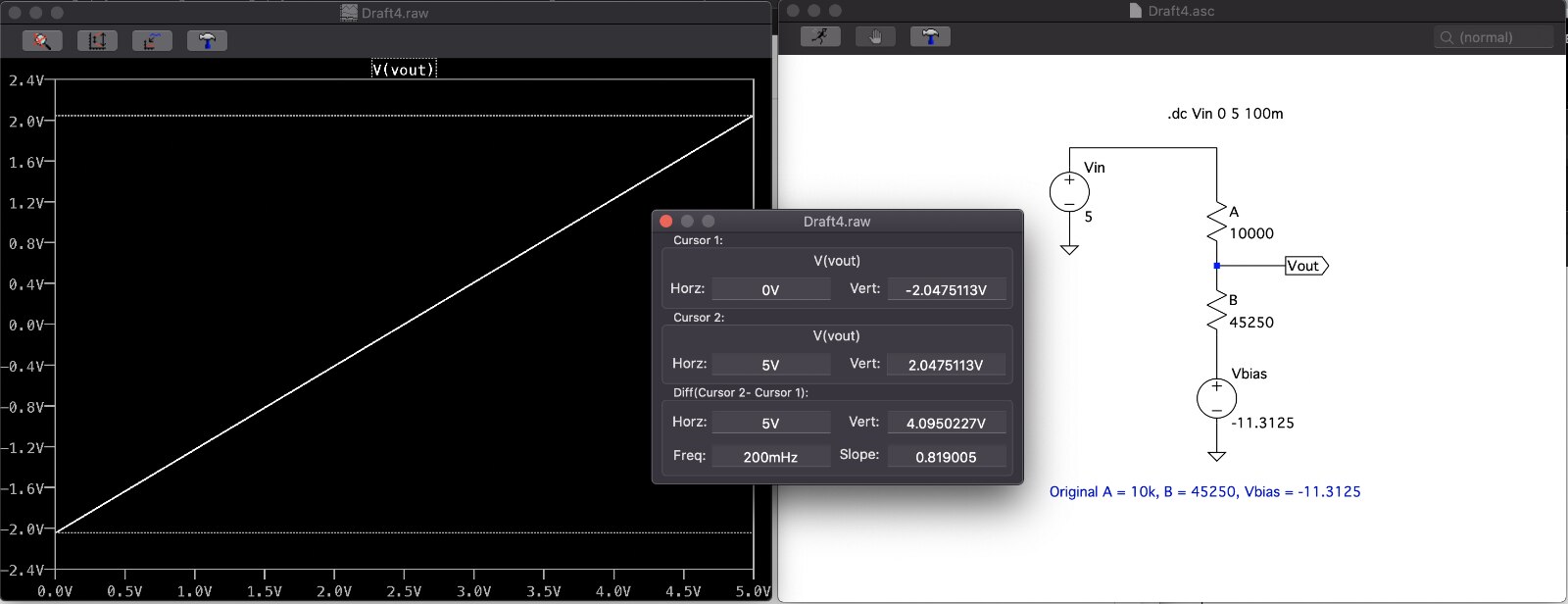

I've been spending some time thinking about best using an ADC and I've done some weighing up of suitable components.  I've half settled on a Microchip MCP3248 rather than a TI ADS1115.  The Microchip has slightly better specs than the TI but it is limited in range on its inputs: -2.048V to +2.047V differential, 0V to +2.047V single ended; the TI has a more flexible option of ranges which expands its single-ended ranges, including a -4.096V to +4.096V, 0V to +4.096V single ended.
Anyway that's not really the purpose of this post per se except in so much that I may change my mind on the Microchip.  Currently, I would be limited to a 0V to 2.047V signal range which is half its available Full Scale Resolution (FSR); this is half that of the TI of course.  The range is fine if, for example, I had to sample a voltage drop over a current sense resistor but not so much if I had to measure a voltage of, say, 0V to 5V.  I'm describing here an option I'm considering to improve the resolution of the ADC and I thought it might make an interesting read.  I want to change an incoming 0V to 5V signal to a -2.048V to +2.048 signal to make full use of the ADCs FSR.
The datasheet has this to say:
The differential voltage at the input pins (without PGA) is:  Vin = CH+ - Ch-.  The differential input voltage range is -Vref <= Vin * PGA <= Vref - 1LSB; essentially the input range is -2.048V to +2.048V after applying any gain.
What this means is that I cannot apply a 0V-4.095V on the CH+ pin with a -2.048V on the CH-.  So if I scaled 5V to 4.095 on CH+ with -2.048V on CH- then Vin, according to the formula is 4.095 - (-2.048) = 6.143V.  I have to scale 0V to 5V to a range -2.048V to 2.047V and apply a -2.048V on the CH- pin.
In software, I could lift the output code up by 2.048V output code so -2.048 becomes 0V.
I'm working from this document which explains the maths and design very well.  I'm summarising a lot here, and missing out a fair bit of the algebraic manipulation so it's worth reading the document for a full understanding.  This is new to me, so here goes.
Scaling and biasing just means creating a new signal from an incoming signal as a linear transformation.  This can be represented by formula Vout = s * Vin + b, where s is the scale and b is the bias; the formula will look familiar to anyone who has graphed a straight line and it's essentially the same formula as the transfer function in a DAC and ADC - scale and bias are just synonyms for slope and offset.  Given two points on a straight line, we can calculate:
Scale = deltaVout / deltaVin
Bias = Vout - scale * Vin
With those two equations we can specify an input and output range and determine the scale and bias.

Specific Calculation
Map a 0V to 5V signal to -2.048 to 2.047 signal
  1. deltaVout = 4.095, deltaVin = 5
  2. s = 4.095 / 5 = 0.819
  3. When Vout = 0 then Vin is 2.5 so b = 0 - 0.819 * 2.5 = -2.0475
  4. The final transformation for my need, then, is Vout = 0.819 * Vin + (-2.0475)
That's easy enough but this transformation has to be implemented through a voltage divider and a bias voltage source:
Vout can be calculated as, Vout = [B/(A+B)] * Vin + [A/(A+B)] * Vbias
Which looks just like the original linear transformation, Vout = s * Vin + b so
s =  [B/(A+B)]
b = [A/(A+B)] * Vbias
This work quite well in general terms.  Make A = B and choose 5V for Vbias and -5V to 5V maps into 0V to 5V.  Not what I need but shows the principle.
From all this, and doing the necessary algebraic finagling between these formulas we can calculate:
ratio of divider, r = deltaVout / (deltaVin - deltaVout) = 4.095 / (5 - 4.095) = 4.525
Vbias = Vout - r * (Vin - Vout) = 0 - 4.525 * (2.5 - 0) = -11.3125V [where Vout = 0 when Vin = 2.5]
LTSpice confirms this:

    shabaz over 6 years ago +2
    Hi Andrew, I was going to say usually ADS1115 is an easy justification because it is low-cost, but it doesn't seem to be that any more, at least for one-offs. I don't understand TI pricing.. a circa £20…
    shabaz over 6 years ago in reply to Andrew J +1
    Hi Andrew, The 0V to 5V would need to be converted into 0 to +2.048V, and +2.048V to 0V to make use of the full range of the differential input. Here's a mapping, assume 2 means 2.048V, note that VP and…
  • Andrew J
    Andrew J over 6 years ago in reply to shabaz +1
    Ah, I’ve completely misunderstood the datasheet haven’t I! Rather than the inputs taking 0 to +2.048 or 0 to -2.048 (giving a range of 4.096 if that full range was applied to the CH+ and CH-), each can…
    Hi Andrew,
    I was going to say usually ADS1115 is an easy justification because it is low-cost, but it doesn't seem to be that any more, at least for one-offs. I don't understand TI pricing.. a circa £20 dev-board for a different chip I was looking at is now over £200..
    There's no need for negative supplies or negative voltages to be buffered (or were you discussing the difference between two positive voltages?), the differential inputs can be driven from dual op-amps, known as a differential driver (example is ADA4941 but there are probably lower-cost alternatives, or it could be formed from two op amps). That will generate differential outputs centred around a value you choose based on an input reference voltage. For example, if your ADC only accepts 0-2.048V on its inputs, then you could use 1.024V as a reference. Then, your input, single-ended, between 0 and any positive voltage, will (theoretically) use the full range, based on the gain value you set (caveat; the op-amps won't completely go rail to rail, so you'll lose some range). By differential output I mean each of the two signals will be positive (i.e. between 0-2.048V for instance) but subtracting one from the other gets you the -2.048 to +2.048 range, and no negative supplies are used.
    However, if you just want to measure between 0V and 5V, it could be easier to just use a single ended ADC and if you definitely need the extra resolution you could choose (say) an 18-bit ADC, if all else is equal (which it rarely is!). I'm not sure I ever end up picking the 'right' ADC. But for 'just a redesign' for the input circuitry or references, something better or cheaper always seems to be missed : (
  • Andrew J
    Thanks Shabaz.  My basic idea was just to convert a 0V to 5V signal into -2.048v to 2.048 to make use of the available range of the ADC.  This isn’t really the way to go: these values work for 0 to 5V but different values are required for a different range. That’s fine when I’m just playing around and I thought it was interesting enough to post about.  I put buffer U1 in because the -ve voltage was sourced from a voltage divider which I thought would change depending on any resistive load on its output.
    I didn’t know such a thing as a differential driver existed but it seems like a more generalised solution to what I describe here.  I don’t fully follow what you say but I’ll check it out tomorrow and have a play with LTSpice.
    There are precious few 16-bit I2C ADCs so choice is limited so I might give them both a go.
    Hi Andrew,
    Here's a mapping, assume 2 means 2.048V, note that VP and VN columns are always positive numbers:
    DIFF   VP   VN
    -2     0    2
    -1     0.5  1.5
    0      1    1
    1      1.5  0.5
    2      2    0
    The 'differential' representation is just a mathematical term, it doesn't mean the the signal ever goes negative, i.e. the DIFF column is imaginary, and I could have written it as 0 to 4 instead of -2 to +2. VP minus VN represents that differential value.  So, you'd need to convert the 0 to 5V into two signals, one which goes high and the other which goes low, but both stay positive above 0V, i.e. the input must not have -2.048V on it, this is also in the electrical characteristics:

  • Andrew J
    Ah, I’ve completely misunderstood the datasheet haven’t I!  Rather than the inputs taking 0 to +2.048 or 0 to -2.048 (giving a range of 4.096 if that full range was applied to the CH+ and CH-), each can have 0 to 2.048.  On that basis, with this ADC I absolutely might as well stick with using a single-ended input, and this is where the ADS1115 has an advantage as it can have different ranges - although that changes the LSB so doesn’t increase resolution it does allow more flexibility at the inputs.
    On the plus side, I did find working out that scaling and biasing fascinating - it wasn’t something I was aware of (well, voltage dividers I was of course.)
