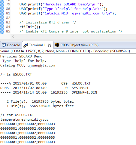

That's it. When you execure the project,
the code will first see if WSLOG.TXT exists in the root of your card.
If it doesn't, it will create it. Then it opens the file in append mode.
If the file is empty, we write a line of header information to it, else we skip that step.
Then we create one line of data, and we close the file.
You can see if this worked correctly by typing
ls
and
cat WSLOG.TXT
in the terminal.
Each time you execute the program from start, the file will grow with one line.
This is how it looks like on my LaunchPad:
/> cat WSLOG.TXT
temperature;humidity;uv
00000001;00000002;00000003
You can import this file in your spreadsheet program, and it'll show nicely in 3 columns
