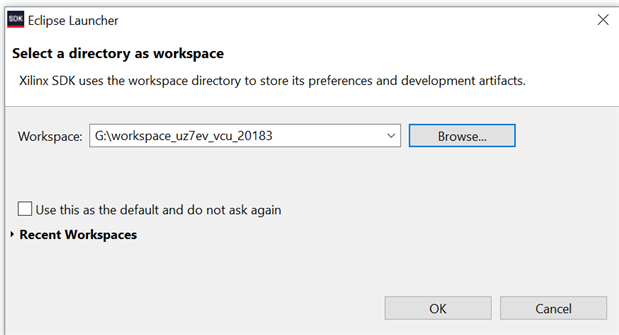

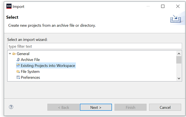

Set up workspace
- clone  https://github.com/mollex/workspace_uz7ev_vcu_20183
- open as workspace with Xilinx SDK 2018.3

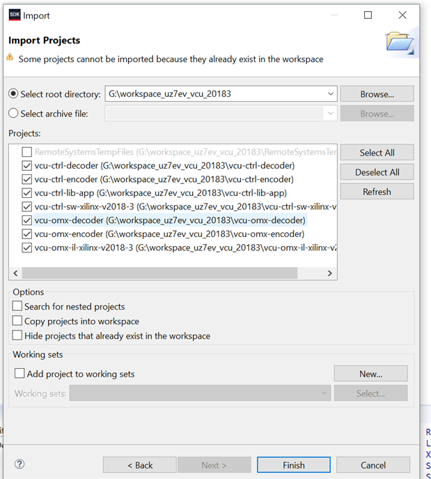

- import projects

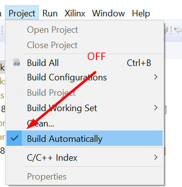

- set off Build Automatically
Menu: Project -> Build Automatically off
Import projects
right click on Project Explorer -> Import -> General -> Existings Project Into Workspace -> Browse -> Finish

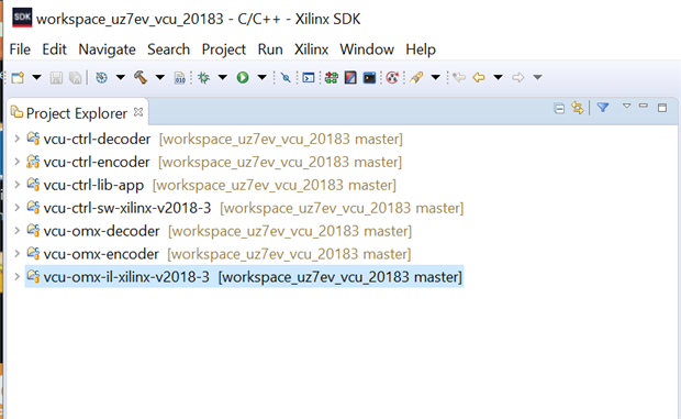

  Workspace consists of:
- vcu-ctrl-sw-xilinx-v2018-3 - main library for control vcu (build first)
- vcu-ctrl-lib-app - library for application  (build second)
- vcu-ctrl-encoder - encoder application
- vcu-ctrl-decoder - decoder application
- vcu-omx-il-xilinx-v2018-3 - omx library for control vcu (build first)
- vcu-omx-encoder - omx encoder application
- vcu-omx-decoder - omx decoder application

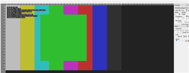

Test v4l2_capture_raw
  Current hardware bitstream for UltraZed-EV does not include any capture port by that reason I have prepared virtual video source module vivid.ko. (use images from Source 2)
- copy dropbox/module/vivid.ko  to /home card
- copy v4l2_capture_raw/Debug/v4l2_capture_raw.elf  to /home
$ cd /home
$ chmod +x ./v4l2_capture_raw.elf.elf
  $ insmod vivid.ko
  $ v4l2-ctl --list-devices  `
      vivid (platform:vivid-000):
    /dev/video
    /dev/video1
    /dev/radio0
    /dev/radio1
    /dev/vbi0
    /dev/vbi1
    /dev/swradio0
$ ./v4l2_capture_raw.elf -o  -m -f -c 10
Files will appear in the folder */home*. Copy to host and open with YUV viewer.
Settings of files: YUV420 planar NV12 1280*720
