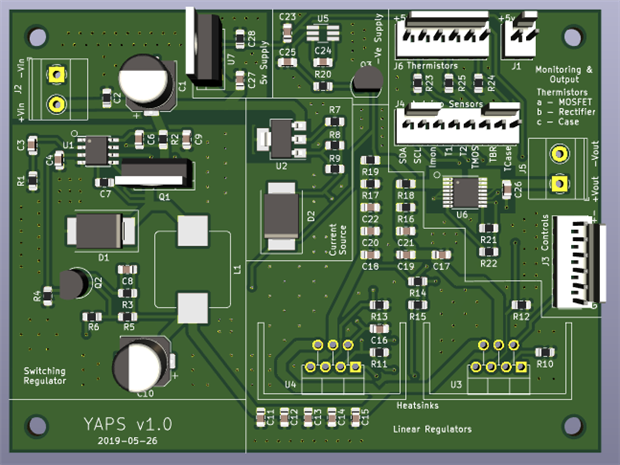

There are two projects, one for the Power Stage and one for the Control Stage (actually called Power Supply.)
I have produced precisely zero PCB designs before - I don’t count the trial one I did of my first power supply I mentioned in Part One which was faintly praised with ‘It should work electrically” image  This is somewhat more complicated and I've added images below.
I set my own constraints when doing this:
  • follow layout guidance given in data sheets
  • use SMD parts, mostly, to keep the size down.  The exceptions were for parts that I don't own the proper tools to solder.
  • fit within 100mm x 100mm dimensions AND 2 layers to keep production costs down.  JLCPCB will create these at around £1.50 for 5 but the price jumps to £22 for a 4-layer board.
  • allow for 2mm between parts to let me to get a soldering iron in and (hopefully not) a hot-air nozzle if I have to rework it.  I really don’t want to buy one of those yet.
  • not split a ground plane by minimising bottom layer routing
  • take account of current capacity with track widths.
A note on the last point re track widths.  The ‘high current’ path is set at 1.5mm - this is greater than the minimum width calculated according to IPC-2221 for a 10 degree C temperature rise and well over the width required for a 20 C rise which I believe it could easily cope with.  It’s less than the minimum width calculated according to IPC-2152 for a 10 C rise but well over the width for a 20 C rise.  In either case, I couldn’t derive a width by specifying a voltage drop: the calculators didn’t allow it and I’m not sure what an acceptable drop would be as output isn't fixed.  It’s obviously not in line with a rule-of-thumb 1mm per Amp.  Ultimately, I traded off space and size against the real likelihood of extended running at 3A which is unlikely for me: for most operation it will be fine and I expect it will be ok at 3A as well.  Even at a 3A output, there isn't 3A flowing through all the high-current circuit (the LT3081s max at 1.5A for example.)  All other signal paths are well over-sized at 0.5mm or 0.35mm for what is small number of milliamps.
I’m also aware that I could have positioned the 5V supply better as its output is daisy-chained (mostly) to the parts that need it.  I didn’t bother to change it (I’d have to re-do the whole board) as the thermistors are single point routed so should get even voltage;  the INA260 can operate from 2.7 to 5.5V so will be sufficiently supplied.  Additionally, I could have laid out the resistors and capacitors aligned in one direction but again I traded off routing as little as possible on the bottom layer.
I had to create custom footprints and symbols but KiCad makes this reasonably easy to do.  It took a long time for me to complete this part, as I was taking my time, and I think that now I have a ‘worked example’, so to speak, I could probably do a bit better.  But actually, I don’t think it’s likely to suffer that much: more likely are other problems that require rework and which may require a new PCB - at that time, I’ll make some changes.

Control Stage PCB
Component positioning and trace routing:
Front and Back ground planes - joined with a net tie:
And a 3D view of the front.  Again, not all parts have a 3D view:

    Always check the Gerbers! I found a few vias that were a little too close to the traces and intruded - not shown in PCBNew but clear as day in the Gerber. 5 each of the Power Stage and Power Control costs…

    Bad news!  I found 3 problems on the Control Stage PCB all of my making.  I'd ordered a NPN in wide TO-92 rather than standard; The LT3081s come pre-bent - 3 legs back,  4 legs forward and I'd got it the other way around on the board; And I ordered the wrong package for the current source - a TSSOP rather than SOT-223.  All my fault, not taking enough care with ordering or reading the datasheet: I spent ages reading them as well, how I missed it I don't know.  I can only put it down to the picture at the front of the datasheet showing flat legs and I assumed I would bend them to fit.
    I can't fix these problems with a drill!  So I've updated the boards and re-ordered them so there will be a delay in progress.  Whilst I'm waiting I might as well work on the 4Duino interface.  I've not updated the images above as the updates don't change things significantly.
