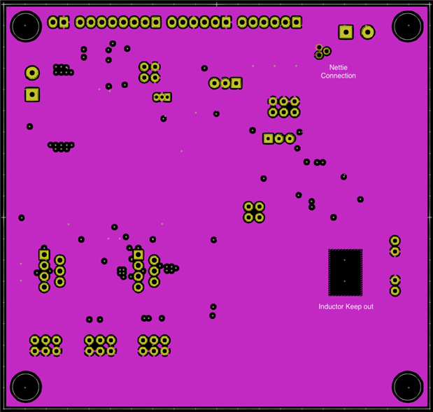

Ground Plane vs Star Ground
Before I get into the layers in more detail, I want to start off with this as it’s come up a bit in comments.   As I researched this it became clear that TI, Analog, Micro-Rohm and others all recommend ground plane; however I cannot also ignore Gene’s comments and advice, which comes from experience, to avoid these and use Star Ground.  So where does that leave me: I don’t yet have the experience of implementations (of both approaches) to determine which would be best nor can I make multiple boards with different configurations - the costs are just too high.
So, I have to make a decision and what I’ve gone with is the advice from TI, Analog, Micro-Rohm:
  • All high current ground traces are on the top layer except for two places where I had to go down to layer 2
  • Layer 2 is a Shield Ground which connects solely by the -Ve PCB terminal for Vin.  There are no other connections to this layer.  However, there are vias and through-holes plus the two high current traces that needed to be routed off the top layer.  There is also a Keep-Out underneath the Inductor (L1).
  • Layer 3 is a Signal Ground layer which connects solely by the -Ve PCB terminal for Vin.  There are no other traces on this layer but there are, obviously, connections for all low-current components.   There are also through-holes and vias and a Keep-Out underneath the Inductor (L1).
How does one avoid creating TH 'slots' (holes in a row) in these layers?  I have no idea.  Quite a few come from the test points I’ve incorporated: even using SMD points would require vias for the ground pins unless I avoided those.
I’ve avoided Thermal Vias as testing to date shows that’s not necessary and it would make more holes through the layers.

Shield Ground Layer
This is intended to keep noise away from the non-power components although I could well have misunderstood the concept.  Nothing directly connects to this layer except the NETTIE so it isn’t directly used by anything as a path to ground.  Should I have limited the area to under the high-current traces only?

  7. The Shield Ground is the full size of the board.  Should I just place this under the high-current routes or does it not make any difference?

    • Layout is completely different.  Also, 4 layers instead of 2 with two ground planes on the inner layers.
    • There are an abundance of test points - through holes for either probes direct or test pins - so that I can measure points of the circuit without interacting with pins directly (and blowing things up which was a too-common occurrence on V1)
    • I put some zero ohm jumpers in a number of places that I could swap out if needed.
      • Between the DC-DC Gate pin and Mosfet Gate
      • Between the Boost Cap and switching node
      • Between the Output Capacitors and the Linear Regulator Vin
      • Between the Linear Regulator output pin and output capacitors
    • Placeholders for a resistor and capacitor for a snubber circuit at the Switch node.  Not populated.
    • Placeholder by each Linear Regulator for a low value capacitor to improve Vin input if needed.  Not populated.
    • Placeholder by the output PCB terminal for a low value capacitor to improve Vout if needed.  Not populated.
    • Changed the Mosfet to a surface mount version of the one I was using.  Minor characteristic changes (all better) except for power dissipation which is significantly less.
    • Changed the Inductor from 10uH to 50uH - based on calculations and improvements observed in the LTSpice simulation
    • Changed the input capacitance from 110uF to 140uF (100 electrolytic, rest ceramic)  From calculations I made - actually, calcs showed 40uF ceramics and 50uF electrolytic but I couldn't find a component with the right ESR at 50uF.
    • Changed the output capacitance from 150uF to 131.11uF (100 electrolytic, rest ceramic).  Meets required ESR plus decade caps for noise.
    • I also added in a 15nF capacitor into the feedback circuit as I bodged this into version 1 and improved output quite a bit (for example, the 15V 3A output with a 5Ohm load was achieved rather than 14V and 2.8A.)
    For the brief time I can run it and measure the output, I'm seeing about 2mV pk-pk noise at 15.5V, 1.55A which is pretty good I think, albeit not very definitive testing (x1 probe, AC coupled)
    I can't see what in those changes could have made such a dramatic difference, any ideas?  I'll think about it over the next week whilst I'm tramping the North York Moors.  I may be inclined to desolder and build up on a fresh board - I have 5 of the new ones - test components as I go (e.g. passives, diodes, transistors, inductor) and take things back to how they were in V1, or at least as close as I can (e.g. 10uH, 110uF input, 150uF output) as a start point.  It feels though there's something more fundamental wrong with it at the moment but I can't tell what and I don't want to keep throwing more money at it without knowing why.
