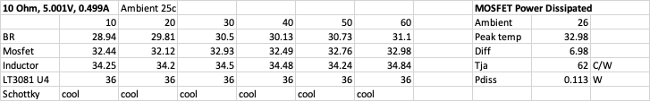

The main concern for the MOSFET was a power dissipation characteristic of only 2W.  I did some soak testing for temperature gain of the existing MOSFET and calculated wattage from that - see below.  The TO220 package doesn’t take up a lot more space than the SMD component (considering just the leg soldering area) but it is a lot more awkward to position and route to.  I did vacillate a bit on this as I know the existing part works : I’ve replaced the existing Mosfet 3 times - once when I blew it up, once when I swapped it for a better part, and once when I de-soldered it for testing when I thought I might have damaged it.
The resistor placeholders R2 and R3 will be populated with a 0 ohm (<5mOhms) resistors initially; R5 and C? will remain unpopulated.  Depending upon what I see during the testing I can populate one of more of these placeholders with actual resistors/ferrite beads and resistor and capacitor in the case of the Snubber.  My understanding is that care is needed with changing the MOSFET timing (BOOST and Gate resistors) as it will increase the switching losses.
MOSFET Temperature Soak Testing
I ran the existing circuit at a range of volts and amps for an hour - 50 mins with the 5Ohm load as I had to leave to do something else and didn’t want to leave it unattended - and captured temperatures at 10 min intervals.  I took the peak temperature for the IRLB8721 MOSFET and using the original Ambient Temperature and the MOSFET’s Tja specification, calculated the power from the temperature rise (temp diff / Tja).  Even in the worst case temperature rise, power dissipation was 0.333mW, well within the replacement's power dissipation rating even after de-rating to 150C.
I’d be very interested to hear feedback on this.  I could switch it back to the TO220 package before I get the board made if I’ve messed up the calculations.

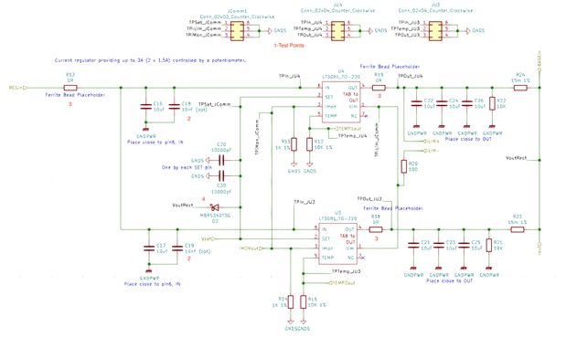

Linear Regulator Circuit
Again, essentially the same but with the following changes (annotated in red):
  1. Test points for the LT3081 pins
  2. Placeholders for addition ceramic capacitors at the input to the regulators, C18 and C19
  3. Placeholders for Ferrite Beads,  R13, R18 and R19, to help with ripple and frequency noise, if necessary.  These will initially be populated with 0Ohm resistors.
  4. Moved the Schottky Diode from the Current Source circuit into the Linear Regulator circuit.
The placeholders for Ferrite Beads are interesting because I have to take into account component sizes as well as their placement on the high-current path.  Scanning around on Farnell, CPC, RS, Digikey, getting a correspondence of size between 0Ohm resistors and Ferrite Beads (at this stage I don’t know if I need them nor what specs if I do) is nigh-on impossible.  So I’ve gone with a 2512 (6.4mmmx3.2mm) size resistor and custom-sized the pads so that 1812 ferrite beads can be used - this seemed to give me the best tradeoff in size correlation.

    shabaz over 7 years ago in reply to Andrew J +4

    I will try a TVS - I can solder it across the PCB terminals on the bottom of the board.
    R2 is a 0Ohm placeholder for a resistor (or perhaps ferrite bead) to help control ringing on the gate if necessary so a 10Ohm could go in there.

    I have the circuit re-assembled and I can now get 15V /1.5A with the 10Ohm load (actually around 15.5V.)  But:
    • When I first turn on, Vout might be as high as 17V.  I've noticed if I turn the load switch off, or pots down then the switch back on or pots back up it goes to 15V.
    • Feedback voltage is 1.5V rather than 1.19V
    • The Mosfet is rising to 90C or so after a few minutes (I've now put a small heatsink on it so it subsequently got to around 65C)
    • One of the Linear Regulators is running cool - 35C or so - and one had reached over 105C after a few minutes
    • The voltage after the Output Capacitors is around 22V instead of around 17V (it should be approx. 1.7V higher than the output voltage because of the feedback circuit)
    • When I turn the load switch off, or turn the Voltage Pot down to 0Ohms, output should be 0V 0A, but it is 20mV 0A.
    None of these were problems in the first version which functionally worked ok - the output was just too noisy.  The circuit is pretty much the same but with some changes:
    • Layout is completely different.  Also, 4 layers instead of 2 with two ground planes on the inner layers.
    • There are an abundance of test points - through holes for either probes direct or test pins - so that I can measure points of the circuit without interacting with pins directly (and blowing things up which was a too-common occurrence on V1)
    • I put some zero ohm jumpers in a number of places that I could swap out if needed.
      • Between the DC-DC Gate pin and Mosfet Gate
      • Between the Boost Cap and switching node
      • Between the Output Capacitors and the Linear Regulator Vin
      • Between the Linear Regulator output pin and output capacitors
    • Placeholders for a resistor and capacitor for a snubber circuit at the Switch node.  Not populated.
    • Placeholder by each Linear Regulator for a low value capacitor to improve Vin input if needed.  Not populated.
    • Placeholder by the output PCB terminal for a low value capacitor to improve Vout if needed.  Not populated.
    • Changed the Mosfet to a surface mount version of the one I was using.  Minor characteristic changes (all better) except for power dissipation which is significantly less.
    • Changed the Inductor from 10uH to 50uH - based on calculations and improvements observed in the LTSpice simulation
    • Changed the input capacitance from 110uF to 140uF (100 electrolytic, rest ceramic)  From calculations I made - actually, calcs showed 40uF ceramics and 50uF electrolytic but I couldn't find a component with the right ESR at 50uF.
    • Changed the output capacitance from 150uF to 131.11uF (100 electrolytic, rest ceramic).  Meets required ESR plus decade caps for noise.
    • I also added in a 15nF capacitor into the feedback circuit as I bodged this into version 1 and improved output quite a bit (for example, the 15V 3A output with a 5Ohm load was achieved rather than 14V and 2.8A.)
    For the brief time I can run it and measure the output, I'm seeing about 2mV pk-pk noise at 15.5V, 1.55A which is pretty good I think, albeit not very definitive testing (x1 probe, AC coupled)
    I can't see what in those changes could have made such a dramatic difference, any ideas?  I'll think about it over the next week whilst I'm tramping the North York Moors.  I may be inclined to desolder and build up on a fresh board - I have 5 of the new ones - test components as I go (e.g. passives, diodes, transistors, inductor) and take things back to how they were in V1, or at least as close as I can (e.g. 10uH, 110uF input, 150uF output) as a start point.  It feels though there's something more fundamental wrong with it at the moment but I can't tell what and I don't want to keep throwing more money at it without knowing why.
    Hi Andrew,
    I think they could all be related to one issue perhaps, because things like the linear regulators should be behaving identically, since it's the same circuit for each of them, just paralleled. I think there's a chance it is either some glitch or overshoot that's damaging parts (e.g. on the supply input to the board, or the output of the DC-DC converter), because 27V is  close to the limit of the ICs and MOSFET. I don't feel all these issues could be related to the PCB layout, if the paths have been shortened (on the earlier PCB, there was a very long path for the ground to the input capacitors, but now it's short). If it is passing CAD tool error and design rule checks, then the board should be electrically identical to the earlier PCB, but just with a better layout. Things like holes for the test points are not likely to be an issue either. Hard to know what to suggest : ( Anyway I'll think on it more too. I hope you enjoy your hols!!
  • Andrew J
    Andrew J over 7 years ago in reply to shabaz
    It certainly passes all the rule checks.  I guess with a LR trying to drop 7V at 1.5A it's not surprising it's heating up, the heatsink wasn't specced for that!  My thoughts veer to the feedback circuit as it isn't maintaining that 1.7V difference and it's pushing 1.5V into the feedback pin rather than maintaining that at 1.19V.  Has a passive blown??  Given the better placing, is the 15nF cap causing problems??  I don't know.
    Anyway, I appreciate your help and input - if you get any ideas, let me know.  Thanks Shabaz.
  • Andrew J
    Andrew J over 7 years ago in reply to Andrew J
    I've worked it out, just needed the break to spot it.  I don't know how I managed it, but I picked a 50nH inductor and not a 50uH inductor.  image  Of course, the footprint on the PCB is way too small for a 50uH so needs re-working.
    I can't see how any of the other changes could impact it, assuming I have got the right parts.  I double checked the Electrolytic Capacitors and they are right; the MOSFET I have is ok too, based on the thermal calcs I did.  All other parts are the same as the first version.
    But in relation to that MOSFET, if I decide to go ahead and rework the board, I'm thinking that switching back to the TO220 package I used on the first version might be worthwhile.  That has a much higher DS voltage and power capability and the footprint, for switching node purposes, isn't that much different, especially as that has to increase because of the package size for the correct inductor.
    This is really frustrating but I suppose everyone makes mistakes.  I was so focussed on layout and SW node size, current loops and grounding that I didn't pay enough attention to other matters.
