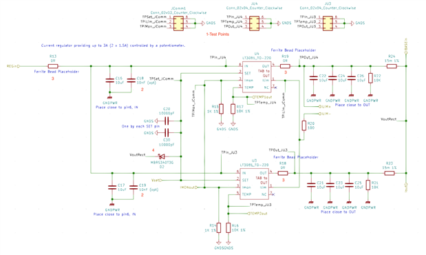

Linear Regulator Circuit
Again, essentially the same but with the following changes (annotated in red):
  1. Test points for the LT3081 pins
  2. Placeholders for addition ceramic capacitors at the input to the regulators, C18 and C19
  3. Placeholders for Ferrite Beads,  R13, R18 and R19, to help with ripple and frequency noise, if necessary.  These will initially be populated with 0Ohm resistors.
  4. Moved the Schottky Diode from the Current Source circuit into the Linear Regulator circuit.
The placeholders for Ferrite Beads are interesting because I have to take into account component sizes as well as their placement on the high-current path.  Scanning around on Farnell, CPC, RS, Digikey, getting a correspondence of size between 0Ohm resistors and Ferrite Beads (at this stage I don’t know if I need them nor what specs if I do) is nigh-on impossible.  So I’ve gone with a 2512 (6.4mmmx3.2mm) size resistor and custom-sized the pads so that 1812 ferrite beads can be used - this seemed to give me the best tradeoff in size correlation.

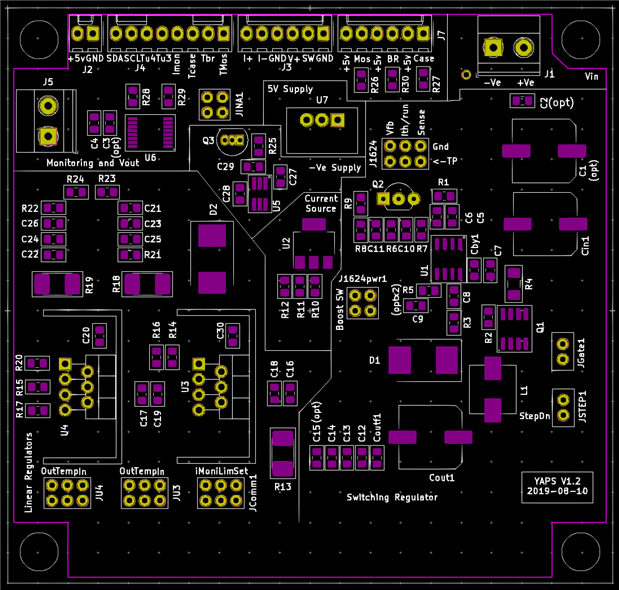

PCB
Hopefully the images I've pasted are viewable but I've attached the Gerbers as well.  With the layout needed, I've gone with a 4-layer board to achieve it - it's a bit more expensive but for the sake of £20-ish it feels worth it given the difficulty of trying to do this with 2-layers, at least that's how I perceive it.  It's also resulted in a slightly larger board at 100mm x 95mm (current version is 100mm x 75mm.)
Layer Stack
Top: components, high current traces, high current ground traces, signal traces
Layer 2: Shield Ground
Layer 3: Signal Ground
Bottom: Signal traces
Test Points
I’ve added in pins for testing of components that have caused me great difficulty in the past:
  • The Switching Regulator pins: I’ve separated out the Switching and Boost pins from the more sensitive pins.
  • The Mosfet gate pin: I will want to be measuring ringing and noise at this point.
  • The Linear Regulators
  • The Current Sense INA260: both Vin and Vout from that chip
I’ve taken the approach of using pins that I can actually either clip a probe to or stick the probe tip into; each has an associated ground pin into which I can insert the short, springy probe ground to avoid have a large ground wire affecting measurements.
Ground Plane vs Star Ground
Before I get into the layers in more detail, I want to start off with this as it’s come up a bit in comments.   As I researched this it became clear that TI, Analog, Micro-Rohm and others all recommend ground plane; however I cannot also ignore Gene’s comments and advice, which comes from experience, to avoid these and use Star Ground.  So where does that leave me: I don’t yet have the experience of implementations (of both approaches) to determine which would be best nor can I make multiple boards with different configurations - the costs are just too high.
So, I have to make a decision and what I’ve gone with is the advice from TI, Analog, Micro-Rohm:
  • All high current ground traces are on the top layer except for two places where I had to go down to layer 2
  • Layer 2 is a Shield Ground which connects solely by the -Ve PCB terminal for Vin.  There are no other connections to this layer.  However, there are vias and through-holes plus the two high current traces that needed to be routed off the top layer.  There is also a Keep-Out underneath the Inductor (L1).
  • Layer 3 is a Signal Ground layer which connects solely by the -Ve PCB terminal for Vin.  There are no other traces on this layer but there are, obviously, connections for all low-current components.   There are also through-holes and vias and a Keep-Out underneath the Inductor (L1).
How does one avoid creating TH 'slots' (holes in a row) in these layers?  I have no idea.  Quite a few come from the test points I’ve incorporated: even using SMD points would require vias for the ground pins unless I avoided those.
I’ve avoided Thermal Vias as testing to date shows that’s not necessary and it would make more holes through the layers.
Check list
Now I have a better understanding of the Switching Regulator, I’ve been able to take a better understanding of layout practices from my reading of data sheet layouts from TI and LT (Analog) as well as the explanation and points presented by Micro-Rohm:
  • Keep the bypass capacitor (Cby1) as close to VDD of the switching regulator as possible.  TICK
  • Keep the loop consisting of Input Cap (Cin1), Sense Resistor (R4), Mosfet (Q1), Schottky Diode (D1) as short as possible.  TICK
  • Keep the loop consisting of Schottky Diode (D1), Inductor (L1) and Output Cap (Cout1) as small as possible.  TICK
  • Traces carrying high currents off the ground plane and away from the sensitive feedback circuit.  TICK
  • Keep the Switching Node - SW pin, D1, L1 and Q1 Source small.  TICK.
  • Use kelvin connections from the feedback circuit connected just after the Output Capacitors.  Vfb should connect directly to the resistors.  TICK
  • Feedback circuit should be connected to the + plate of Output capacitor.  TICK - actually, there are more than one output capacitor and it connects just after the last one as per TI advice.
  • Keep the connections from feedback resistors to the Vfb pin (R6 and R7 - and really also Q2) short and away from the Switching Node.  TICK
  • Gate drive trace should be as close as possible to the Mosfet (Q1) gate.  TICK.  in my opinion - given ‘close’ is relative and I can’t physically get the larger parts any closer!  Part manufacturers don’t help with their pin layout either.
  • Signal and Power Grounds separated.  TICK
  • Does the input capacitor (Cin1) +ve connect to Sense Resistor (R4) as closely as possible. TICK
  • Does Cin1 connect as close as possible to GND pin of Switching Regulator.  TICK - in as much as this makes zero sense as their grounds are meant to be kept seperate!
  • Is ground of Cin1 and Cout1 separated by at least 1-2cm. TICK
  • Is the Inductor (L1) close as possible to the Switching Regulator.  TICK
  • Is the wiring to the Inductor input as small as possible.  Is the wiring distance between the Inductor terminals as great as possible. TICK
  • Are there no ground or signal traces under the Inductor.  Is the Ground Plane kept from underneath the inductor. TICK
  • Are the Inductor and Output Capacitor (Cout1) as close as possible.  TICK
  • Signal and Power Grounds must be kept separate.  TICK
  • Top Layer Power Grounds and Inner Layer Power Grounds must be connected by numerous vias.  TICK (there are only two places where I have routed Power Ground to the inner layer.)
  • Power Ground should be connected to a common ground or signal ground near an Output Capacitor.  NO TICK - grounds and ground planes are connected at one point only near the Power in terminal, based on discussions/advice here.  I believe this point is based on the grounds for the Switching Regulator only, not the 'load circuit' - I have done that with the feedback circuit and IC GND connections.
Quite a substantial checklist but I think I’ve hit them all including the last point.  The grounds are tied at the -Ve pin for VIn but in Kicad I can only do this with a Net tie component - it’s not possible to specify a pin or pad as belonging to multiple nets.  You can see the Net tie in the PCB top layer by the -Ve pin of the PCB terminal.  I think this is ok - any noise from power ground that hits the Shield Ground would route out here.
Silkscreen and Solder Mask
To make it easier to see some of the following images, here's just the silkscreen and solder mask:
Top Layer
(Green traces are bottom layer traces)
High Current traces, shown with green arrows, route along the right, bottom and right side.  Ground traces, shown with cyan arrows route in a similar manner: where I have ducked down to layer 2, dashed cyan arrows, (the Shield Ground) I have used vias to connect the traces - I've just noticed that the fourth short arrow at U3 should be a dashed one.  These are 0.508mm diameter with 0.254mm drill but would it be worth making them bigger?  The check list calls for “numerous” but could I do with fewer of them to reduce via holes through the layers?
Components are placed quite close to each other - much closer than in the last version.  It looks do-able hand-soldering.  In particular, the feedback circuit is well away from the power traces and route through traces to just past the output capacitors.  You can see that I route the GND return under the power ground (on the signal layer) to connect there by the output capacitors as well - it is equally possible to connect at the point it ducks down but I’ve kept the traces together as recommended by the check list.
Shield Ground Layer
This is intended to keep noise away from the non-power components although I could well have misunderstood the concept.  Nothing directly connects to this layer except the NETTIE so it isn’t directly used by anything as a path to ground.  Should I have limited the area to under the high-current traces only?
Signal Ground Layer
This is used as a ground plane by the non-power components - i.e. those not directly related to carrying high-current to Vout.  There are multiple connections on this layer but no traces.  All the cheaper manufacturing companies preclude the use of blind or hidden vias so they all route through 4 layers.
Bottom Layer
This carries signal traces that can’t route on the top layer.  There’s not that many of them really.
Summary
I think I’ve made a much better job of laying out and routing the design this time.  The first version was so bad it wasn’t even worth trying to start dealing with the sources of noise but my hope is this will prove capable of proper measurement and action: the placeholders for ferrite beads/capacitors/resistors can at least allow some modifications to be made as a result and the test points will prevent me blowing components up.  I'm more than happy to provide additional information if anyone is interested.
A summary of my questions:
  1. Would it be advisable to swap the MOSFET back to the TH version I used before which is more capable of dissipating power?
  2. Is the use of TH pins for the GND connection with my test points - so I can use the short GND wire on my probe - better than removing those holes through the planes?  Alternatives would be to use SMD test points with vias (smaller diameter) or doing away with GND test points and using the longer crocodile clipped GND wire.
  3. Layout guidance uses a lot of relative terms such as ‘close’ and ‘as possible’.  Is the trace from the Switching Regulator (U1) to the gate of the MOSFET (Q1) too long?
  4. The GND connections for the feedback circuit, Switching Regulator and the ITH/Run pins route around to connect to PWRGND just past the Output Capacitors (one piece of advice read.)  Would it be better to route these directly to the +ve and =ve pads of Cout1 - the 100uF output capacitor (another piece of advice read.)
  5. They don’t just connect to PWRGND just past the output capacitors, they also route under PWRGRND to do so: I could avoid doing that and connect at the point the trace jumps down.  Is it better to leave as-is?
  6. The PWRGND traces all route back on the top layer to the -Ve pin on VIN.  Very close to this point is the single connection for Shield Ground and Signal Ground.  Would it be better placing this nettie close to -Ve pin on Cout1?
  7. The Shield Ground is the full size of the board.  Should I just place this under the high-current routes or does it not make any difference?
  8. From experience, does this look hand-solderable if care is taken with the order of placement of components.
  9. I have no copper fills on the front or back layers.  If I added these and tied them to the nearest ground plane the vias would pass through all 4-layers.  Ultimately, I don’t know if it would improve anything so I didn’t bother as more holes in the layers seems ‘a worse thing’ but am I wrong?
I’d be very interested in thoughts and observations on my approach so I don’t make the same mistakes as last time.  In particular, given that grounding was a major issue in the current version, what’s your views on how I’ve done this time.

    I have the circuit re-assembled and I can now get 15V /1.5A with the 10Ohm load (actually around 15.5V.)  But:
    • When I first turn on, Vout might be as high as 17V.  I've noticed if I turn the load switch off, or pots down then the switch back on or pots back up it goes to 15V.
    • Feedback voltage is 1.5V rather than 1.19V
    • The Mosfet is rising to 90C or so after a few minutes (I've now put a small heatsink on it so it subsequently got to around 65C)
    • One of the Linear Regulators is running cool - 35C or so - and one had reached over 105C after a few minutes
    • The voltage after the Output Capacitors is around 22V instead of around 17V (it should be approx. 1.7V higher than the output voltage because of the feedback circuit)
    • When I turn the load switch off, or turn the Voltage Pot down to 0Ohms, output should be 0V 0A, but it is 20mV 0A.
    None of these were problems in the first version which functionally worked ok - the output was just too noisy.  The circuit is pretty much the same but with some changes:
    • Layout is completely different.  Also, 4 layers instead of 2 with two ground planes on the inner layers.
    • There are an abundance of test points - through holes for either probes direct or test pins - so that I can measure points of the circuit without interacting with pins directly (and blowing things up which was a too-common occurrence on V1)
    • I put some zero ohm jumpers in a number of places that I could swap out if needed.
      • Between the DC-DC Gate pin and Mosfet Gate
      • Between the Boost Cap and switching node
      • Between the Output Capacitors and the Linear Regulator Vin
      • Between the Linear Regulator output pin and output capacitors
    • Placeholders for a resistor and capacitor for a snubber circuit at the Switch node.  Not populated.
    • Placeholder by each Linear Regulator for a low value capacitor to improve Vin input if needed.  Not populated.
    • Placeholder by the output PCB terminal for a low value capacitor to improve Vout if needed.  Not populated.
    • Changed the Mosfet to a surface mount version of the one I was using.  Minor characteristic changes (all better) except for power dissipation which is significantly less.
    • Changed the Inductor from 10uH to 50uH - based on calculations and improvements observed in the LTSpice simulation
    • Changed the input capacitance from 110uF to 140uF (100 electrolytic, rest ceramic)  From calculations I made - actually, calcs showed 40uF ceramics and 50uF electrolytic but I couldn't find a component with the right ESR at 50uF.
    • Changed the output capacitance from 150uF to 131.11uF (100 electrolytic, rest ceramic).  Meets required ESR plus decade caps for noise.
    • I also added in a 15nF capacitor into the feedback circuit as I bodged this into version 1 and improved output quite a bit (for example, the 15V 3A output with a 5Ohm load was achieved rather than 14V and 2.8A.)
    For the brief time I can run it and measure the output, I'm seeing about 2mV pk-pk noise at 15.5V, 1.55A which is pretty good I think, albeit not very definitive testing (x1 probe, AC coupled)
    I can't see what in those changes could have made such a dramatic difference, any ideas?  I'll think about it over the next week whilst I'm tramping the North York Moors.  I may be inclined to desolder and build up on a fresh board - I have 5 of the new ones - test components as I go (e.g. passives, diodes, transistors, inductor) and take things back to how they were in V1, or at least as close as I can (e.g. 10uH, 110uF input, 150uF output) as a start point.  It feels though there's something more fundamental wrong with it at the moment but I can't tell what and I don't want to keep throwing more money at it without knowing why.

    shabaz over 7 years ago in reply to Andrew J
    Hi Andrew,
    I think they could all be related to one issue perhaps, because things like the linear regulators should be behaving identically, since it's the same circuit for each of them, just paralleled. I think there's a chance it is either some glitch or overshoot that's damaging parts (e.g. on the supply input to the board, or the output of the DC-DC converter), because 27V is  close to the limit of the ICs and MOSFET. I don't feel all these issues could be related to the PCB layout, if the paths have been shortened (on the earlier PCB, there was a very long path for the ground to the input capacitors, but now it's short). If it is passing CAD tool error and design rule checks, then the board should be electrically identical to the earlier PCB, but just with a better layout. Things like holes for the test points are not likely to be an issue either. Hard to know what to suggest : ( Anyway I'll think on it more too. I hope you enjoy your hols!!
  • Andrew J
    Andrew J over 7 years ago in reply to shabaz
    It certainly passes all the rule checks.  I guess with a LR trying to drop 7V at 1.5A it's not surprising it's heating up, the heatsink wasn't specced for that!  My thoughts veer to the feedback circuit as it isn't maintaining that 1.7V difference and it's pushing 1.5V into the feedback pin rather than maintaining that at 1.19V.  Has a passive blown??  Given the better placing, is the 15nF cap causing problems??  I don't know.
    Anyway, I appreciate your help and input - if you get any ideas, let me know.  Thanks Shabaz.
  • Andrew J
    Andrew J over 7 years ago in reply to Andrew J
    I've worked it out, just needed the break to spot it.  I don't know how I managed it, but I picked a 50nH inductor and not a 50uH inductor.  image  Of course, the footprint on the PCB is way too small for a 50uH so needs re-working.
    I can't see how any of the other changes could impact it, assuming I have got the right parts.  I double checked the Electrolytic Capacitors and they are right; the MOSFET I have is ok too, based on the thermal calcs I did.  All other parts are the same as the first version.
    But in relation to that MOSFET, if I decide to go ahead and rework the board, I'm thinking that switching back to the TO220 package I used on the first version might be worthwhile.  That has a much higher DS voltage and power capability and the footprint, for switching node purposes, isn't that much different, especially as that has to increase because of the package size for the correct inductor.
    This is really frustrating but I suppose everyone makes mistakes.  I was so focussed on layout and SW node size, current loops and grounding that I didn't pay enough attention to other matters.
