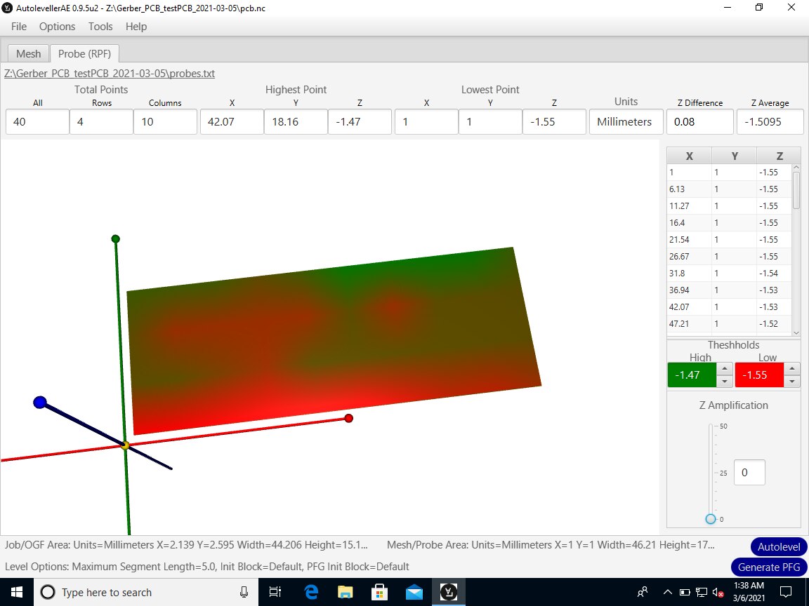

Then I used the Autoleveller to generate g-code for collect the information about the PCB plate.
Here is output from Autoleveller with collected probes from my PCB plate.
With this information I was able to generate corrected g-code and perform milling. From my initial observations it looks like that I need to spend now more time on finding proper settings e.g. cut depth to get best results. Additionally it will be nice to rewrite this script to other language code e.g. C/C++ with adding more strict checks during performing. Below sample results and video (was speed up 4 times) from probing and milling.
