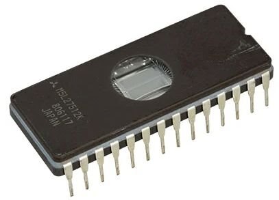

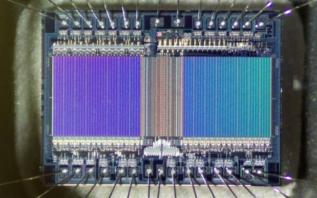

This is a digital microscope image of a 27512 EPROM. It took a lot of digging in my archives to find this chip, but I wanted a chip with a ready-made window so the microscope could image the actual silicon.
Click on the image for a full size view.
Here is what a typical EPROM looks like with its window to allow UV light to erase the memory:

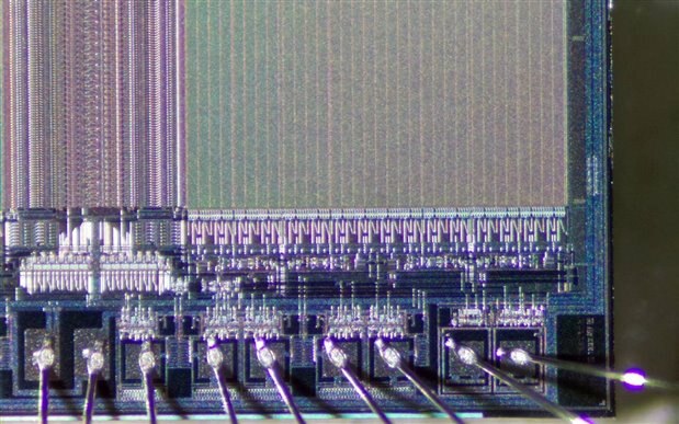

I also took a a closer image just to see what this microscope can do....

    My guess would be that the metallization on the surface is too dense with a Flash part (presumably the UV parts were deliberately designed with a clear area above much of the storage well for the light to get in), but I could be wrong.
    BTW thanks for the pictures. The one that shows clearly the welds of the bond wires is particularly nice. You can see, from the variation in the placement of the tack point, why they needed the landing pads the size they were.
