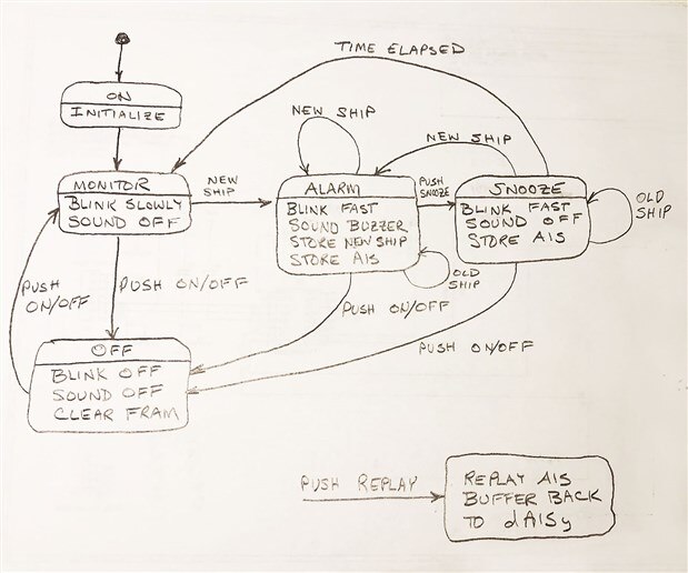

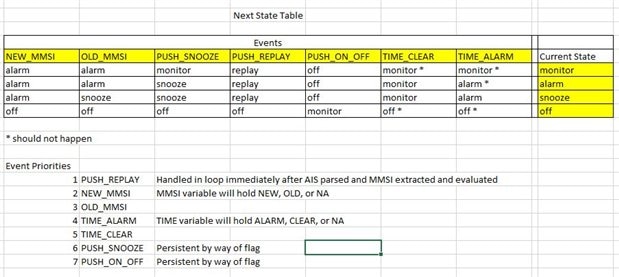

This is the simplified state machine both as a diagram and a table showing movement from one state to the next.  In the old design there were LEDs for on/off, alarm, and ship detected.  Now it is done with one LED.  This is probably close but I have to keep stopping myself from adding features (KISS).

    fmilburn over 8 years ago in reply to gecoz +4
    Hi Fabio, Thanks for examining my work critically - it is appreciated. You have found an omission in the state diagram. Also, I am a self taught enthusiast programmer so my work may not reflect standard…

  • gecoz
    gecoz over 8 years ago in reply to fmilburn
    Hi Frank,
    Thanks for explaining to me, now I think I understand what the snooze state does and how you are using it.
    I think you probably can get away using only one event for the timer, the TIME_CLEAR event. The reasoning behind is that, while in the SNOOZE state, which I assume will start the timer, you can only exit the state if a new ship is detected (NEW_SHIP event), in which case you move back to the ALARM state, or if the time is elapsed, in which case you either move to ALARM, if the old ship is still detected (OLD_SHIP event), or you move back to MONITORING if no detection occurred (TIME_CLEAR event).
    You are doing a superb job with this project, and definitely you should not underestimate your programming skills.
    Keep up the great work.
    Fabio.
