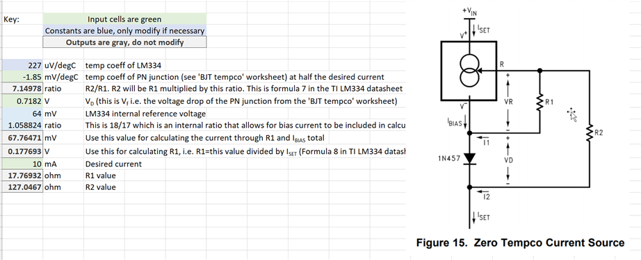

    An update... I read the datasheet thoroughly and set up the LM334 as a temperature compensated current source as described in the datasheet.  A IN4148 was substituted for the diode they used.  I came up with nonstandard resistor values so I put the closest values I had in.  The initial test was about 2% off the desired 10 mA current (not unexpected based on what was in the datasheet) so R1 was adjusted by adding another resistor in parallel until within 1%.  Voltage was varied over the range of interest and here are the results for the full length of test wire:
    Things look good above 2.5V input (the planned instrument will have at least 3V) but notice there is a slight rise in the measured current at 5V.  This may be due to temperature from increased voltage which the datasheet warns of or just increase of temperature as it heats up in time in still air.  I left it on for an hour at 5V and from that point on it was stable although I am unable to make measurements with the resolution I would like.

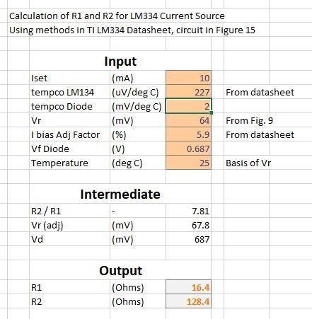

    One final post for the night...  I put the numbers into the spreadsheet for the IN4148 - Here is the resulting calculation:
    For R1 I am still using 17.4 Ohms so that is off a bit.  For R2 I took out the 33 Ohm resistor and replaced it with a 100 Ohm trim pot as the datasheet says to vary R2.  Then I fired up the circuit and adjusted R2 until the current was measuring exactly 10.00 mA.  The measured resistance for R2 was 130.5 Ohms and above it was 134 Ohms.  So a 3.5% change in resistance was needed to correct a 1.7% original error in current.  My feeling is that a trim pot is needed to insure better than 1% accuracy.  I am using a cheap trim pot but it seemed fairly stable.  The Newark site is down for me but it looks like you can get a single turn 50 ohm version with 100 ppm / deg C temperature coefficient for less than a dollar which I think would be acceptable.
    An observation on flexibility:  With the LM334  it would be difficult to change current settings to measure larger resistors.  It would be more straight forward to switch sensing resistors with a microcontroller if using the op amp approach.

    shabaz over 7 years ago in reply to fmilburn
    Hi! The TI chart rises as does the data in the table, I think maybe the chart I drew may be confusing things, it was just showing Vf (not tempco) just so we could see how the selected Vf would also change depending on what current setting was used.
    Hehe we thought alike. I too wrote a spreadsheet : ) Still, I'm glad we can compare now, because mine had an error, but I've just now corrected it after seeing and testing with the values in your screenshot : )
    The settings I've put in there are the current ones I'm playing with (I chose a tempco and Vf that would hopefully be close enough for either manufacturer 2N3904. I'll locate some resistors and start paralleling them tomorrow, to get as close as I can to these figures.
