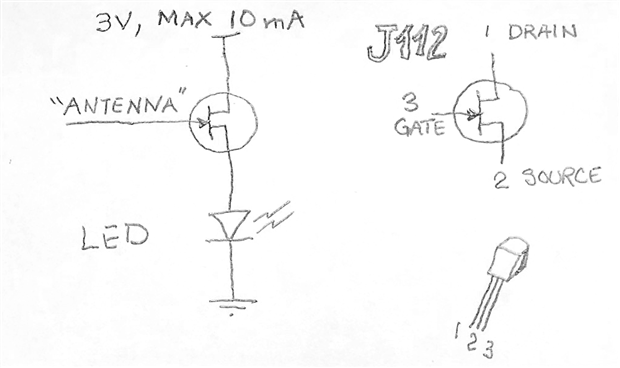

In a recent element14 Essentials on Static Control, shabaz said this:  "A 2N3819 + meter or LED makes a nice simple charge detector too : )"
So, I thought I would try it.  I don't have a 2N3819 but I do have a J112 N-channel JFET.  The circuit is shown below:
Power is supplied by a bench power supply set to 3V current limited to 10mA.  The "antenna" is a 5-inch long piece of wire.
So how does it work?  A JFET has extremely high input impedance - hardly any current flows into the gate - it is voltage controlled.  Current flow from drain to source is determined by the voltage differential between the gate and the source.  The drain to source current flow is highest when the gate to source voltage differential is zero.  As the gate to source voltage differential becomes more negative the drain to source current flow decreases.  At the pinch-off (sometimes called cutoff) voltage the drain to source current essentially ceases.  In the detector circuit, the gate/antenna becomes negative relative to the source and the FET turns the LED off gradually as the statically charged object comes closer.  I demonstrate it in the following 40-second video:

    shabaz over 5 years ago +4
    Hi Frank, Awesome results! It's definitely a fun experiment too. Great diagram too by the way!!

    Good experiment and demonstration. The drain to source current flow is highest when the gate to source voltage differential is zero. Although this is obviously nit-picking, I think you'd find, if you tried…

    fmilburn over 5 years ago in reply to jc2048 +3
    Good points and thanks for the comments... I originally used the word "positive" instead of zero. But one of my references stated the gate should not be biased positive so I changed it to zero. Your explanation…

    It has been a long time since I took college physics.  But your first description of “redistribution of the free electrons in the wire, so that there's a greater concentration down the gate end" immediately clicked with me.  I didn’t write about it in my post but I did experiment a bit to see how much my hand influenced things (not so much) versus charging up the mechanical pencil by rubbing it in my hair and moving it in close.
    One thing that occurred to me when I was doing the experiment was that It would be possible to determine the voltage the FET was seeing between the gate and source due to the static charge.  It would first be necessary to generate the Ids as a function of Vgs curve.  Then using the current out of my PSU I could determine Vgs from the statically charged object at any point in space.  That would allow me to demonstrate the inverse square law. At least I think it would, I didn’t try it. The geometry of the antenna would probably influence things which would be interesting.

    jc2048 over 5 years ago in reply to fmilburn
    I couldn't find anything in my textbooks.
    I'm no academic, and my physics is a bit dodgy at times, but perhaps we might describe what you've got as an irregular capacitor. For the 'old' physics models, that us engineers use, you'd be looking at a text on electricity and magnetism, and specifically electrostatics, electric fields, and capacitance.
    The eraser is one 'plate', with an excess of trapped charge, the wire the other, with charge able to move beyond the capacitor but only within the confines of the length of wire, so all to do with 'end effects' and little regular capacitor theory. It's really more about how the electric field arranges itself in space and then changes as the free charge in the wire drifts as a reaction to it. Trying to calculate anything with regular capacitor models would be horrendous - textbook examples of capacitance always consider very simple structures with lots of symmetry - so here you'd probably use finite-element methods, in a similar way as is used for the fields around an antenna, and rely on the ability of a computer to do lots of calculations very quickly, but to do that you'd need a 3-d model of the structure to work with, and it would have to be run through multiple iterations [dividing time into discrete intervals] with all the usual worries about accumulated errors and so on, until it reached an equilibrium.
    In practice it's much simpler to just do what you did and try it. Or think about it in a hand-wavy way, like I did, and imagine roughly how the electrons in the wire are going to behave simply from an electrostatic point of view. I did it backwards. You told me that the potential at the gate dropped, so a surfeit of electrons, driven down by the charge on the eraser, which in turn must be an excess of electrons. Simples! - as the interwibblers say [or maybe used to say - I don't make any effort to keep up].
    Keep in mind that the JFET will be prone to some leakage across the reverse-biased junction, so if you leave the eraser close to the wire, the gate potential will slowly change as charge leaves the wire. (Increasing the reverse potential will encourage more leakage.) But the JFET has a neat 'reset' mechanism - think what happens if you let the gate get back close to zero and then remove the eraser again.
    But, having said all that, a further thing to keep solidly in mind with any experiment like this, done in an inside environment, is the prevalence of mains fields. Your hand will distort those fields and it's quite possible that the effect you're seeing derives from that rather than the charge on the eraser. You would need to experiment further to show that it was the eraser causing the effect.
