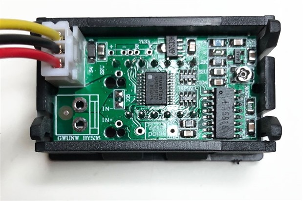

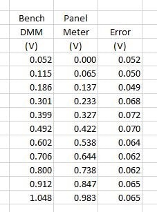

    Hi Shabaz,
    From you description, it looks like I ordered the wrong meter...  Could also have a particularly bad sample. I spent a fair amount of time trying to calibrate it again this evening without luck.  There is an offset I can't seem to correct and in any case it is not millivolt level accuracy.  These are typical results compared to my bench multimeter:
    This is the Aliexpress site:  https://www.aliexpress.com/item/GWUNW-DC-digital-voltmeter-BY536V-9-9999-10V-5-bit-high-precision-Voltage-Tester-Meter/3…

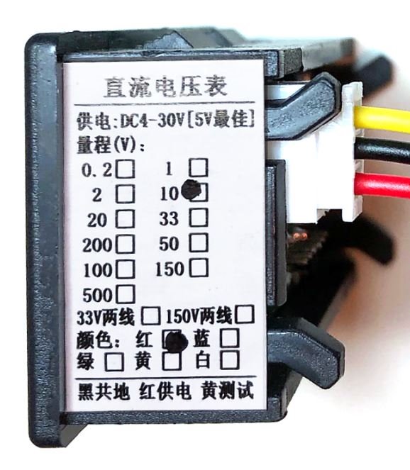

    The have a pretty decent picture of the back on the site, but here is a picture I took - it is clearly different than yours and I don't see the 6 pin chip or anything that would likely pass for an ADC:
    Here is the label:

    Interesting - just tested the ammeter and it was accurate all the way down to 0 mA with no more than 0.1 mA error so it will be acceptable for another project I have in mind.  I just ordered the same volt meter that Shabaz has so will test that out once it gets here.
  • fmilburn
    fmilburn over 7 years ago in reply to fmilburn
    Hi Shabaz,
    I received the meter today that matches yours and it works quite well.   I will check it out a bit more but when I make the next update I think I will use it so that no multimeter is required.   It is a shame I didn’t order that one to start with....
