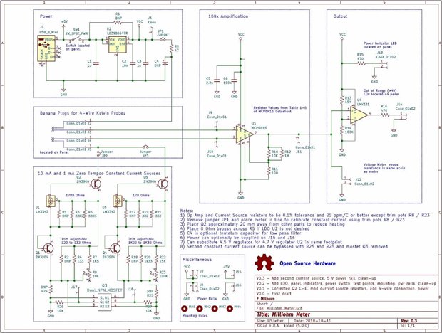

EDIT 24 Oct 2018  The schematic in this post contains an error.  It will be reposted after receipt of the PCB and testing.
I am developing an inexpensive but reasonably accurate meter for measuring resistance in the milliohm range.  The previous posts are listed in the related links at the bottom.  In this post the design for the working prototype is expanded to include a second current source for measuring resistance up to 400 ohm and provision made for future auto-ranging.  A new schematic and a PCB design are presented along with an update on meter options.
Revised Schematic
The revised schematic is shown below:

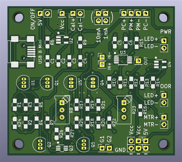

The added current source is identical to the first but designed for 1 mA current.  A dual N-Channel MOSFET with pull-down resistors is connected just above ground to allow selection of a source.  It will add maybe an ohm to ground.  There are jumpers and bypass resistors so that the second current source and MOSFETs can be omitted if desired.  This has not been incorporated into the working prototype so a second eye and comments on the design are welcome.  An additional 5V set of pins was added so a source other than the USB connection could be used as well.  Thanks for ideas and suggestions shabaz  image.
PCB Design

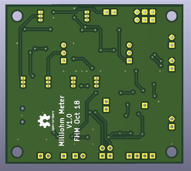

The PCB was done in KiCad (5.0.0) which is a new version for me and I am still finding my way around the changes.  The layout was done with ease of hand soldering in mind which led to what I consider poor routing so I may redo it and hope send it to the board house tomorrow.  There were a couple of unfinished wires when the renders below were made but those are finished now and it passes electrical check.

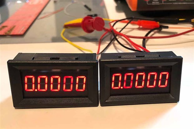

The panel meter I ordered from China came in earlier in the week but they were a disappointment.  Although they advertised 5 digit resolution they are not much better than 3 and show zero when down in the low millivolt range so they aren't much use for this project.  There is a zeroing procedure which I tried without much luck and a small pot which doesn't seem to do much.  I also ordered a ammeter but haven't had a chance to really test it.  It looks like I will be using patch cables and a multimeter for the display.

    Hi Shabaz, From you description, it looks like I ordered the wrong meter... Could also have a particularly bad sample. I spent a fair amount of time trying to calibrate it again this evening without luck…

    Hi Frank, Sorry to hear the panel meters were no good : ( I'll check the ones I have, in case any function better. (By the way from the back of it, if there is a 5 or 6-pin SOT-23, that should have been…
    shabaz over 7 years ago
    Hi Frank,
    Sorry to hear the panel meters were no good : ( I'll check the ones I have, in case any function better. (By the way from the back of it, if there is a 5 or 6-pin SOT-23, that should have been the ADC, some Microchip device for the better accuracy : (
    The PCB layout looks really neat, and I was surprised that both ranges fitted. Also it was nice to see jumpers/links to isolate sections for experimentation using this rev 1 board.
    I did look over the schematic and it seems good to me, but I'll spend more time looking at it closely later today.. PCB/schematic reviews after some coffee, to concentrate : )
