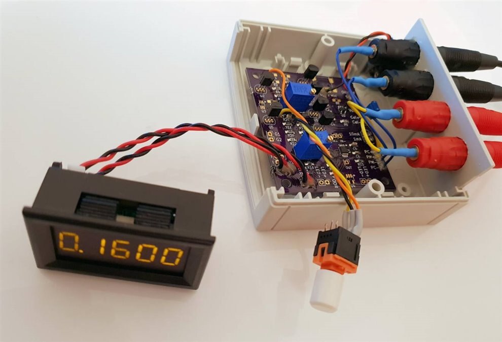

    Hi Frank, Some good news, and some uncertainty : ) The good news is that it is assembled, it was a breeze using the PCB. Also it is just the right size for the enclosure, it all fits hopefully : ) I've…
    shabaz over 8 years ago +6
    Hi Frank, Sorry to hear the panel meters were no good : ( I'll check the ones I have, in case any function better. (By the way from the back of it, if there is a 5 or 6-pin SOT-23, that should have been…
    shabaz over 7 years ago
    I started building this tonight : )
    I've soldered all the resistors and pots, and then trimmed to the desired resistance.
    Hopefully tomorrow I'll get the rest all soldered up, and try powering it up before putting it in the case!
  • fmilburn
    fmilburn over 7 years ago in reply to shabaz
    I was just discussing the project with my fellow geek friend this evening and told him I hoped you would have a chance to look at it soon.  Let me know your thoughts and upgrades and I will incorporate when I respin the board.
    shabaz over 7 years ago in reply to fmilburn
    Hi Frank,
    The good news is that it is assembled, it was a breeze using the PCB. Also it is just the right size for the enclosure, it all fits hopefully : ) I've yet to cut out the front panel.
    I used slightly different resistor values to you, for both the 10mA and 1mA ranges, in order to account for the PN junction Vf value at those currents, and the very slightly different tempco value at these two settings too. And it appears rock-solid, even without the enclosure, unlike the earlier attempt I tried to replicate, where I needed a bowl and waiting ages for it to settle. For the quarter of an hour, since switch-on, the display has been reading 0.1599 or 0.1600.
    The uncertainty/bad news is, that this value isn't correct : ( it should be reading 0.164 since there is a 164mohm resistance. The problem is that the current isn't 10mA : ( it is about 9.7mA (I measured it using the pins you have on the PCB for that purpose). At approx 9.7mA, the measured value of a 164mohm resistance would indeed be 160mohm.
    The error is not caused by resistor tolerance, this is way too large for that : (
    Also, when I switch to the higher resistance range, I see 0.97mA. So whatever mistake I'm making, it is the same for both ranges.
    So, I guess there is some misinterpretation of the datasheet formula : ( but I can't see what. I'll look more closely into that tomorrow.
    These are the values I'm using for the 10mA range which is giving me about 9.7mA:
    I can't just use the trimmer to adjust the current, since that would throw the temp drift cancellation out the window : (
    I guess I could just set the "Desired current" in the spreadsheet to something proportionately larger, and that will solve the problem, since I'm seeing the same ratio of error at 1mA as at 10mA. But still it would be nice to know why this is the case : (

    jw0752 over 7 years ago in reply to shabaz
    Hi Shabaz,
    I don't have the skills to make a suggestion but one thing that has caused me problems when using these meters in the fairly low input impedance for a voltmeter, Some of them are as low as 75K. I don't know if this is a factor for your tests and I could find no reference to it in the notes above. Just thought I would mention it.
    Hi Shabaz,
    I actually noticed something similar on mine and should have taken more notice...  This is taken from the comments I made above:
         2) The trim pot had insufficient range to adjust the current - had to reduce the resistance so R2 and R1 came in handy.
    This did not occur when I built the prototype on perf board.  I was using the same digital multimeter in both cases to measure the voltage.  Agree it would be nice to figure out what is going on...
    Frank

    shabaz over 7 years ago in reply to jw0752
    Hi John!
    Thanks for the suggestion. I'll check in more detail tomorrow, I can isolate the amplifier and meter circuit easily. The meter I'm using has 350k input resistance, so hopefully not loading the amplifier much. I think you'd enjoy building and testing this circuit by the way : )
    Hi Frank!
    Ohh that's interesting. Was the current lower for you too?
    If I cannot spot a calculation error by tomorrow, I'll plug in different values into the spreadsheet to scale the voltage up, and test that.. perhaps the datasheet is wrong : ( although it should have been spotted by now, since it is not a new part.. or maybe we've made some incorrect assumption somewhere : ( We could ask on the TI forum.
    Once working values are figured out, then maybe the trip pots are not needed in the rev 2 PCB at all, if you're planning to release a future revision.
    There are some ideas (mainly cosmetic) below, but the current rev 1 PCB is very usable, it accommodates most things, I felt the PCB design is extremely flexible.
    1. The trimmer pot component outline seems slightly offset to the actual Bourns pot physical outline
    2. Change R9 to be 10 ohm (reduces the volt drop)
    3. Change C4 to be 1uF (to add a filter)
    4. Add 100nF decoupling near U4
    5. Might be better to space out the pins for the TO-92 package, for the transistors. But no real need, so if there isn't space, this suggestion should be ignored. For the LM334, the spacing is fine.
    6. It wasn't clear where to obtain power for the panel meter. The connection marked +5V was used, since the panel meter prefers that voltage or higher. But the +5V connection is before the power switch, so if I had used a power switch, then the panel meter would have stayed lit (I didn't solder a power switch).
    7. Maybe have an option to use a DC power jack instead of USB (i.e. have both footprints perhaps, or just pins for soldering flying leads). For my version, I didn't solder a USB connector, but used a DC connector soldered on flying leads.
    8. Shield of USB connector should be connected to 0V perhaps. Would make a nice place to clip a scope or meter 0V connection.
    9. Maybe no need for jumper JP2 and JP3, and alow a SPDT switch to be wired to a new connector at R24 and R25 and ground.
    11. The labels that are on the PCB should also be on the schematic, because it was confusing understanding which ones related to which part of the schematic, e.g. Cal+ and Cal- are not marked on the schematic; they are marked as JP1 on the schematic
    12. Change the kelvin connection labels to Hcur, Hsense, Lcur, Lsense or similar perhaps, maybe on underside of the PCB.
    13. Add a 0-ohm resistor in the connection between the op-amp and the comparator, so that it can be desoldered and isolated for testing (i.e. still have the meter connected, but not the comparator circuit)
    14. Maybe no need for the power LED, since the panel meter will be lit.
    15. Possibly change U4 to LMV7271MF (it is pin-compatible, the footprint can remain the same). I have not tested this yet, I've left U4 currently unpopulated.
