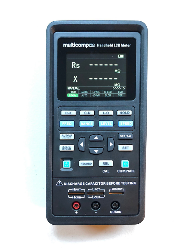

The LCR meter came nicely boxed and undamaged.  The meter has a nice zip up case that contains 2-wire test leads, a short circuit shunt, Type-C USB cable, and power adapter.
This is a large meter.  I was surprised at how large.  Very large image  It feels sturdy and substantial.  It takes it a short while to boot up and then there is a rather faint beep.
Before going further note that this is a rebranded Hantek 1833C.  I was able to determine this by querying *IDN? with SCPI.
Front
The display is a 2.8 inch TFT LCD that looks nice with white lettering on a dark background.  The primary and secondary functions are easy to read although the viewing angle is not as good nor is it as legible as some of my other meters. Still acceptable though.  The backlighting is adjustable and good.  The display also shows other parameters in a smaller font that is still legible provided one is no further away than they might be while reading a book.  It is hard to photograph and the actual display is of even contrast and looks nicer than my attempt to capture it below.
There are lots of buttons and a keypad.  The buttons are squishy, not clicky.  Rather than go through them in great detail, here is a link to the user manual: 3154931.pdf (farnell.com).  A greatly abbreviated overview is given below.
The top row of buttons allows the user to go straight to commonly used display modes and to hold the current reading.  As an example of mode, the R-X button will display resistance as the primary parameter and impedance as the secondary parameter.
The second row of buttons allows setting of:
  • frequency from 100 Hz up to 100 kHz
  • manual measurement range
  • RMS voltage level of 300 or 600 mV
  • fast (4 Hz), medium (2 Hz), and slow (1 Hz) measurement speeds
The upper white button to the left of the arrow keys allow the primary parameter to be automatically or manually set (resistance, capacitance, inductance, and impedance).  The white key below it sets the secondary parameter (reactance, dissipation factor, quality factor, phase angle, and equivalent series resistance).  To the right of the arrow keys the black button allows measurement to be in either series or parallel equivalent modes.  The set key allows language, display brightness, boot state, and the beeper to be set as well as displaying device information.
The arrow / cursor keys allow navigation through the row of parameters shown at the bottom of the display.  These can be used to achieve the same results as using the buttons.
Just below the arrow keys are the power switch, record button (records min, average, and max when in a manual mode for the last 10 tests), and the REL and COMPARE keys which are used to calibrate the instrument.  The COMPARE key can also be used to compare components to expected nominal values within a user selected range of "good".
Hurray!  This meter has real 4-wire / Kelvin capability plus guard in addition to the standard jacks.
Credit: User Manual 3154931.pdf (farnell.com)
I found that when inserting small capacitors into the Kelvin slot it was possible to insert one leg incorrectly and get a bad reading.  In that case it might be best to use the alligator clips that come with it although they aren't 4-wire. I'd like to fit some Kelvin probes to the meter but Newark does not list them.  I intend to make my own.
