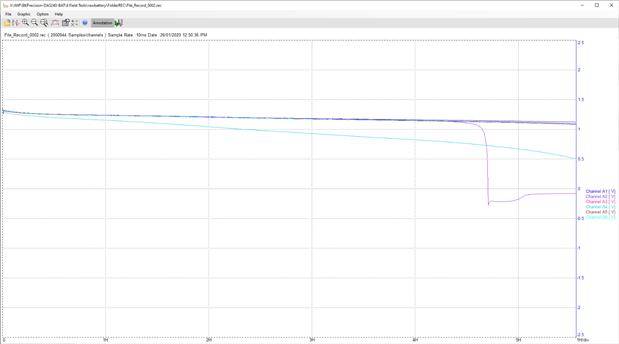

Battery life was tested with three different scenarios – logging with one channel enabled at the maximum sample rate and screen dimming set to one-minute, logging with all channels enabled at the maximum sample rate and screen dimming set to one-minute and logging with all channels enabled at the maximum rate with screen dimming disabled, screen brightness set to maximum and Wi-Fi connected.
With screen dimming enabled, the results came in at 24 hours and 20 minutes for a single channel and 24 hours and 50 minutes for all channels, representing a significantly (62%) greater time than the datasheet’s claim of 15 hours.
Without screen dimming and using maximum brightness and Wi-Fi connection, the unit managed just 12 hours and 51 minutes. This is 28.5% greater than the datasheet claim of 10 hours, which is great news for those who intend to work on battery power alone and also means that the battery should be able to last longer in the recorder before its capacity falls to the stated values in the datasheet. In fact, most Li-Ion batteries will reach 80% (or slightly below) as they reach their stated cycle life, which would put the run time near the claimed 10-hour mark under this load.
In all low-battery scenarios, the recorder gracefully saved the log prior to shutting down and no data loss was incurred.

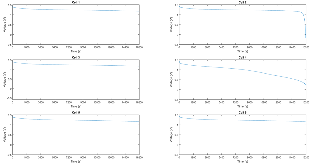

Logging Battery Cells During Charge and Discharge
One of the key advantages of having so many isolated channels is the ability to measure many voltages without the need to be concerned about common ground connections. The only thing you have to be aware of is the CAT I 100V safety rating.

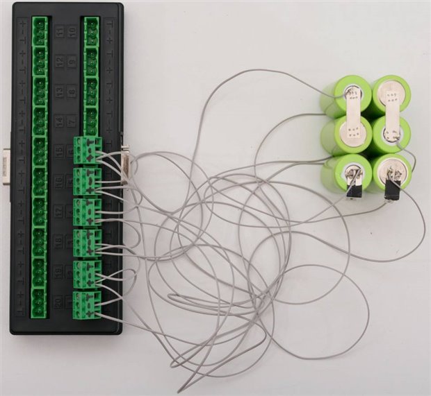

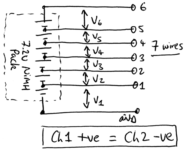

In order to demonstrate the flexibility, I thought it would be a good idea to perform some battery-pack based experiments. In the days of Ni-Cd and Ni-MH power tool batteries, it was common knowledge that such packs consisting of numerous series-connected cells often failed due to cell mismatch which would be exacerbated by running the battery completely flat. As a result, I decided to do some diagnostics on the Ni-MH battery pack from a three-year-old handheld rechargeable vacuum cleaner.

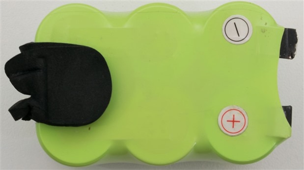

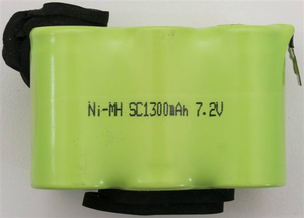

The battery comprises of six sub-C cells in series, for a nominal voltage of 7.2V and capacity of 1.3Ah. To monitor the battery while charging and discharging, I determined that there should be seven wires to the pack.

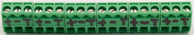

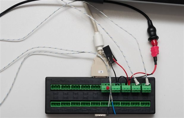

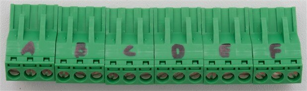

For my convenience, I used a permanent marker to label the terminal blocks for ease of connection. I then stripped some 28AWG ribbon cable and connected these to the terminal blocks in order.

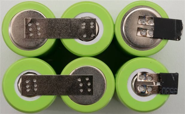

I removed the heatshrink from the battery pack, lifting the edges of the tabs and soldering the tap wires to the appropriate positions on the cells.
Battery charging and discharging was undertaken using a Rohde & Schwarz NGM202 programmable power supply. The data was logged using the B&K DAS240-BAT and analysed from the .txt export from the resulting log files using MATLAB.

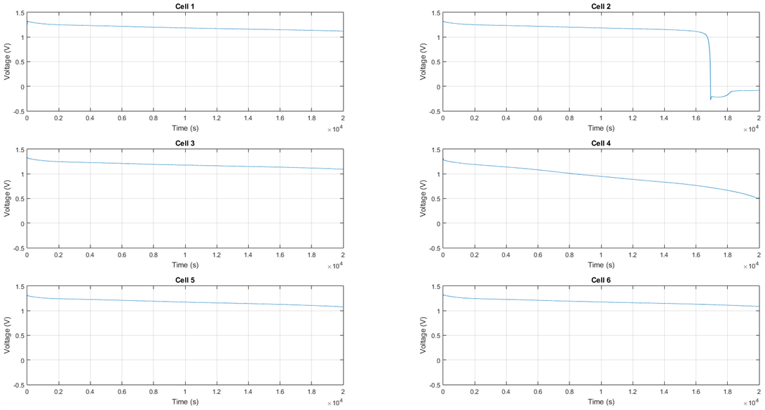

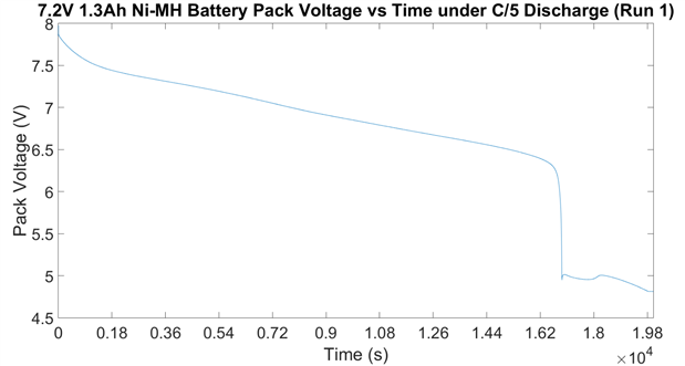

First Discharge
The cell was initially float-charged by the vacuum’s internal circuitry (likely, just a current limiting resistor). On a discharge, the overall voltage looks like the following graph:
This looks relatively normal, except for the “wavy” bumps after dropping below 5V. It is hard to properly diagnose the battery without more information about each of the cells.
Plotting each of the cells shows that Cells 1, 3, 5 and 6 are all hardly completely discharged with 1 and 3 being stronger than 5 and 6. Cells 2 and 4 are “faulty”, with Cell 2 having a severely mismatched capacity to the point of being reverse polarised during discharge. Cell 4 is a bit strange, seemingly having some form of voltage depression all-over which may be indicative of increased internal resistance. Two bad cells? I wouldn’t have guessed.

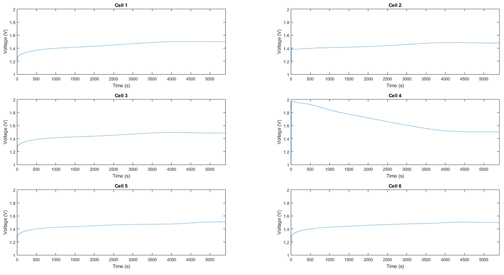

First Charge

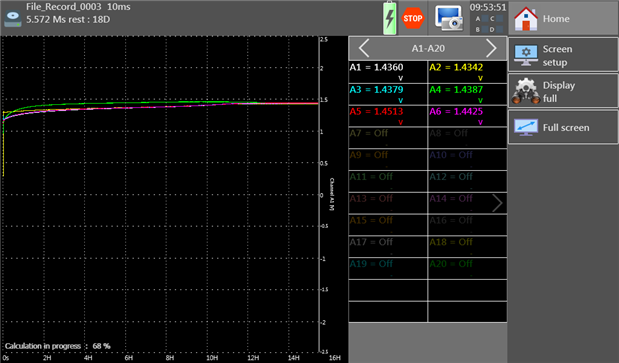

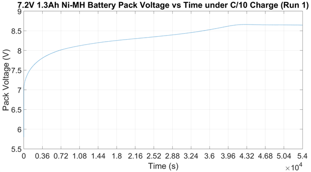

I decided to emulate the “float” style charge of the regular charger by charging at C/10. The resulting graph looks as follows:
This doesn’t show what happens to each of the cells, which we can find out with the B&K DAS240-BAT:
A look at this shows that the good cells are charging as expected, reaching full capacity an hour or two prior to termination. Cell 2 seems to show a rapid voltage increase from initial application of current, suggesting some internal resistance issue, but it reaches full charge at around the same time as the good cells. Perhaps this cell has some internal current leakage resulting in the reduced capacity. Cell 4 shows a curved but still rapid increase in voltage and what appears to be overcharge voltage depression (i.e. -dV).

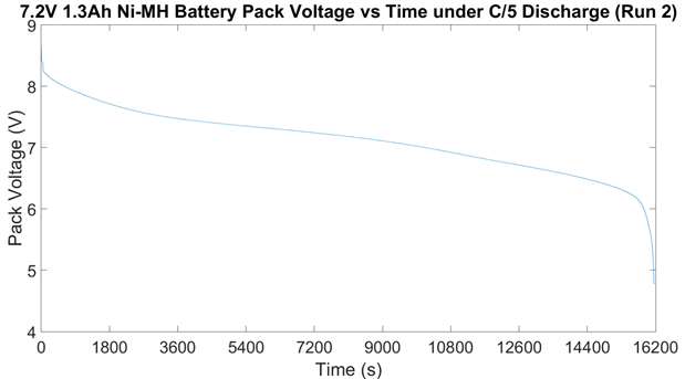

Second Discharge
After being satisfied that the charging was completed properly, I commenced a second discharge.
This one shows an overall voltage trend that looks surprisingly like a healthy pack, however, a look at the individual cell plots show that Cell 2 has just reached reverse polarity at the end of discharge and Cell 4 had reached very close to zero volts. This shows how the behaviour of the pack can very much be influenced by the “balance” of the charge in each cell.

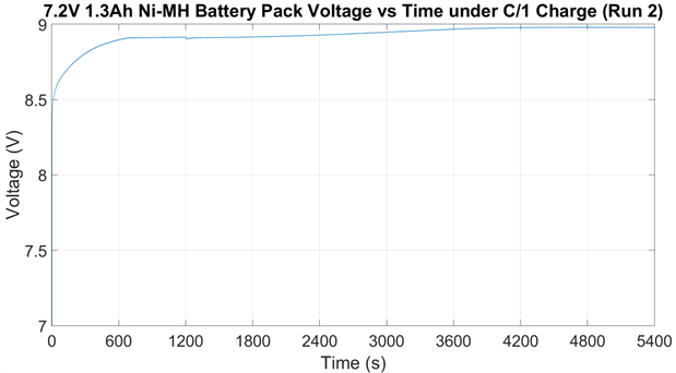

Second Charge
After that discharge run, I was hoping to charge the pack at a more rapid C/1 rate to observe a negative delta-V indication of full charge.
Unfortunately, having the voltage limit on the supply set to 9V, the pack became voltage-limited during charging likely due to high internal resistance. A look at the individual cells shows the healthy cells doing just fine, with Cell 2 reaching full charge early. Cell 4, however, due to its high internal resistance, ended up “soaking” up a lot of voltage initially, reaching close to 2V which may have caused further damage to the cell and unexpected chemical reactions. This is why for certain sensitive chemistries (e.g. Li-based), balancing series cells is mandatory.
That being said, the B&K Precision/Sefram DAS240-BAT proved its value in being able to monitor per-cell performance of a battery pack thanks to its isolated channels. The CAT I 100V rating does limit the size of battery packs it can be used with, however.

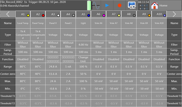

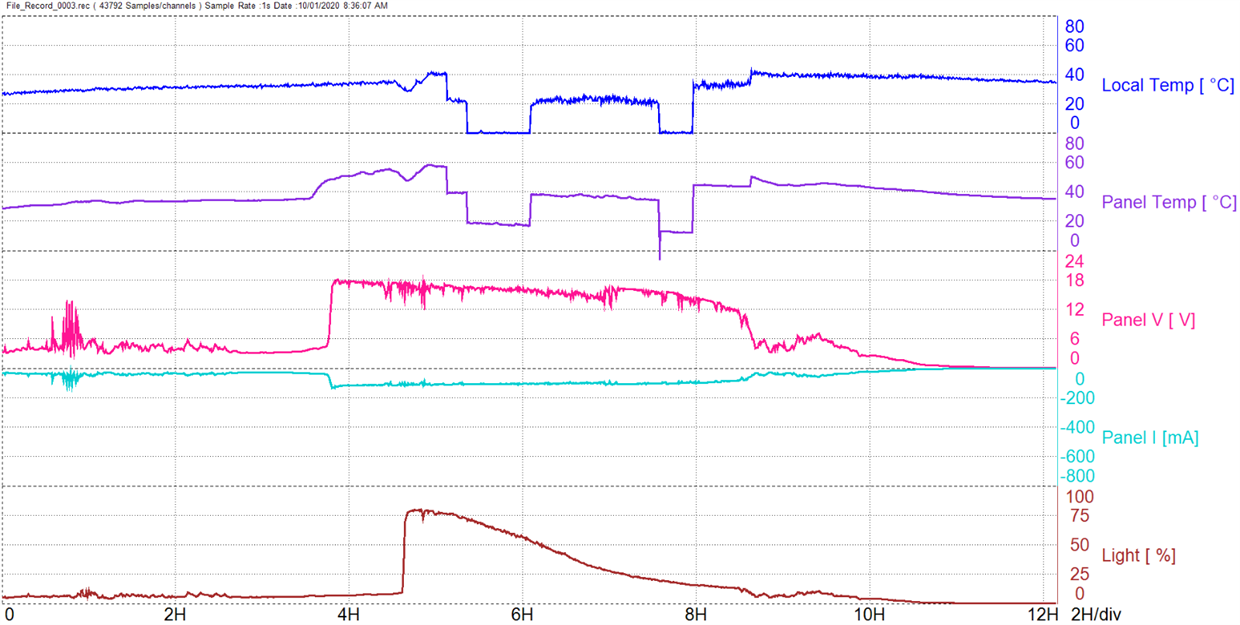

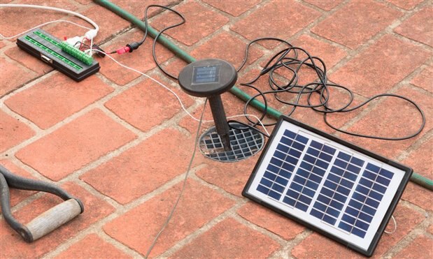

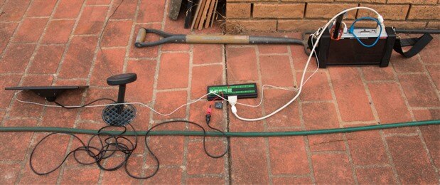

The next experiment I thought of literally involves operating the equipment “in the field”, or more precisely, in my backyard. Despite clear warnings in the manual in regards to temperature and direct sunlight, I decided to create a small rig involving a 12V (nominal) 3W solar panel, driving a relay coil as a load. The voltage would be logged on one channel, with the current measured over a small 1-ohm shunt resistor (converted back into current using a math-channel setting). To round out the sensor types, I dedicated two channels to thermocouples, both of the garden K-type variety. Finally, lacking anything spare that could be used as a brightness sensor, I went with a regular “low-intensity” type red LED as a photodiode, sans amplification, into the final channel which was calibrated to read percentage based on saturation using a 1000-lumen torch.
The unit was placed outside in the backyard, with the unit in a semi-shaded location, screen facing away from the sun in the shade (as direct sun would likely cause heat damage to the LCD). The channel interface was placed on the ground, thus liable to direct sunlight. One of the temperature channels measured the solar panel temperature, while the other was in the air near the channel interface to read the “local” air temperature.
As this was prior to obtaining a compatible USB Wi-Fi interface, I used a Mikrotik hAP mini as a Wi-Fi to Ethernet bridge, powered from one of the recorder’s USB ports to maintain network connectivity. Logging proceeded for the majority of the day, with shading dominating the early part of the recording.
The logged data was then plotted in SeframViewer with some changed settings to enhance readability.
Unexpectedly, the data seemed to show that the operational temperature range limit of 40 degrees Celsius is probably there for a reason – the thermocouple channel readings collapsed by approximately 20 degrees Celsius upon exceeding that figure and then further collapsed to zero (uncompensated), suggesting that there may be a limitation to the capabilities of the inbuilt reference junction compensation. As a result, I recommend complying with the datasheet specifications and not submitting even the channel connection module to temperatures above 40 degrees Celsius. The other channels seemed to read just fine, although attempting to rescale the Current in SeframViewer caused the units to be entirely corrupted due to a software bug. Likewise, issues with attempting to create a computed mathematical channel for power based on multiplying voltage and current values occurred, due to some strange interactions when using a channel that already has a function applied to it for a math channel. This has been reported to B&K Precision, with the hope of future improvements.image
It does show how the DAS240-BAT can be applied to reading multiple physical quantities quasi-simultaneously in the field, although it does show that the datasheet temperature limitations are probably there for a reason and combining or using more complex features may lead to unexpected operation and bugs in both recorder firmware and viewing software.

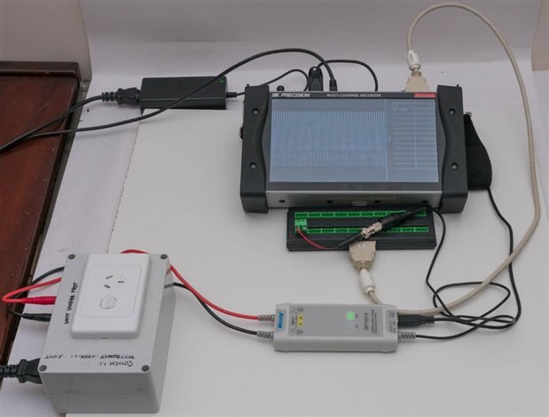

I used a high voltage differential probe to measure the 50Hz mains electricity with the DAS240-BAT.

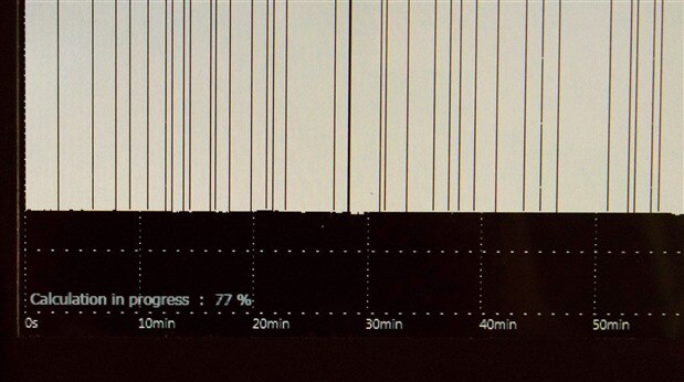

The unit did log the sine wave, however, the zoom on the unit itself is quite limited and the SeframViewer software uses no interpolation between samples, making it more difficult to interpret accurately (unlike sin(x)/x interpolation). Unfortunately, the DAS240-BAT does not seem to be capable of computing more complex mathematical functions on analog inputs – e.g. frequency or RMS amplitude. As a result, while high sample rates are available, the DAS240-BAT is still most suited to more “steady”, slower changing signals from sensors and transducers rather than AC signals.

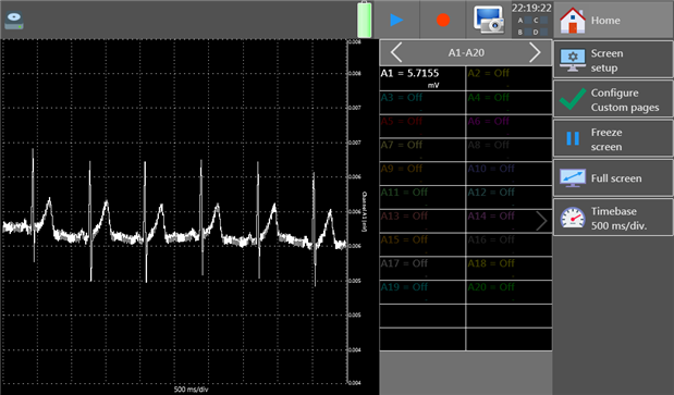

Logging Small Signals
Finally, one of the DAS240-BAT’s most unique capabilities is the ability to log very small voltages. In order to test this, I decided to turn it into a basic two-lead ECG by attaching one channel input to a two-electrode Polar band, normally used for fitness monitoring. As this is not a medical device, it should not be used for such measurements for your own safety – do not try this at home!
It definitely worked, with a bit of mains noise pick-up. The heartbeat is clearly visible, but the same limitations with regards to channel functions from the previous section applies.

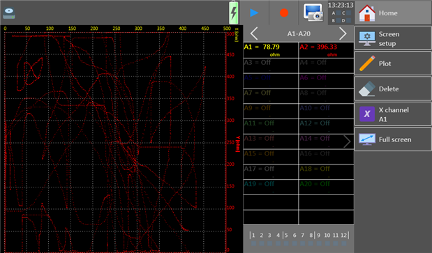

Extra Notes - Testing X-Y Mode, Resistance Mode and Calculations Channels
During this RoadTest, I had the bright idea to put in an entry for the element14 Project14 Holiday Special which featured the B&K Precision/Sefram DAS240-BAT acting as a modern etch-a-sketch, showing the use of resistance measurements on input channels using the inbuilt bias generator and X-Y plotting mode. The posting including video can be found here.
The DAS240-BAT has channel-based mathematics calculations (shown in Ch3) for handling sensors and transducers, so as to plot them in their native units. There are also math channels which allow to create traces based on mathematical operations on other traces. Unfortunately, during testing, it seems that combining the two features causes corruption to the source channels, resulting in incorrect results.
Otherwise, after creating the math channels, they must be manually enabled in the plot configuration so that they are shown, otherwise they are computed but not shown. Regardless, with or without these channels enabled, during logging, the “Calculation in progress” indication is shown in the bottom corner of the screen periodically, although with no observed ill effects.

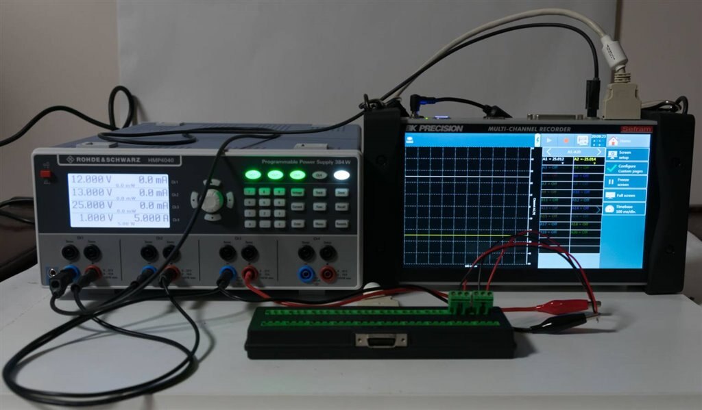

    Thanks for another interesting and comprehensive road test. There is one point I'm not clear on, in your battery test you refer to the voltage inputs as being isolated (as in isolated from each other)…
  • michaelkellett
    michaelkellett over 6 years ago in reply to Gough Lui +1
    Thanks - this might explain the low scan rate - every time it selects a new channel the capacitance of the whole acquisition system must be driven to the new common mode voltage - I wonder how well it…
  • Gough Lui
    Gough Lui over 6 years ago in reply to michaelkellett
    Sorry - you're right. I've fat-fingered a formula in Excel - instead of 20*LOG(x), I had 10*LOG(x). Whoops! That would have been power-decibel rather than voltage-decibel ...
    - Gough
  • michaelkellett
    Hello Gough,
    Thanks for doing that - it seems to work pretty well (much better than I expected) - I've looked at using the OptoMOS type parts in a design before but in the end we used conventional relays because we were a bit worried about the possible performance issues with the OptoMOSs. I'll look at them again in the light of this information.
    BTW - I think you may have understated the dB, certainly for noise or AC cross-talk I would always expect dB to be the power ratio as in 20 x log(V1/V2) which comes out at 146dB. It's not common to have a measure of DC cross-talk so perhaps it's uncharted territory. Maybe it should be expressed as ppm, (which gives 0.05ppm)  - it's very good any way !
    MK

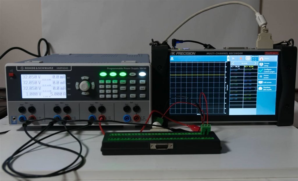

  • Gough Lui

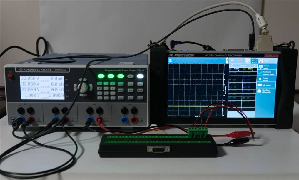

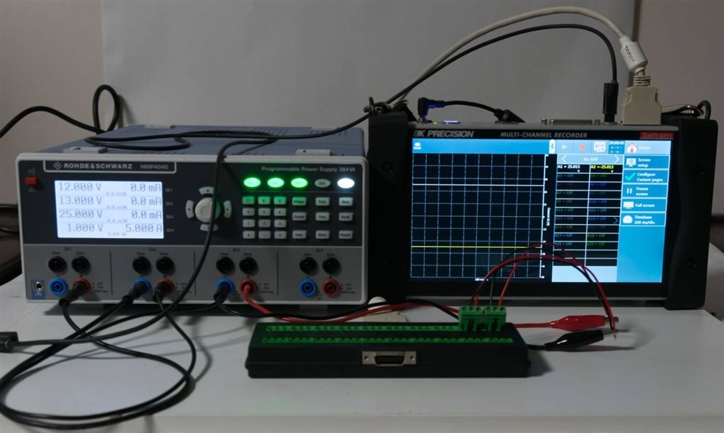

    Hi michaelkellett - sorry it took a day but because you asked so nicely and because I was interested, I performed a few experiments to try and learn more about the behaviour of the channels given common mode voltage.
    I started off with my three-quarter functioning Rohde & Schwarz HMP4040 (didn't need the hefty firepower, but heck, why not?) configured with the first two channels in series providing the common mode offset voltage which is then series into the third channel providing the signal voltage that is to be read on each channel. I prepared terminal input blocks on channels 1 and 2, set to 100V range and with the positive of one block twisted with the negative on the other. Banana to croc clips were used to do the hook-up into channel 3 (i.e. 25V into the negative connection of channel 1, 50V into the positive of channel 1). The zero volt earth comes from the negative side of channel 1 - this is hooked using a lead straight into the chassis earth on the B&K Precision DAS240-BAT as I measured continuity from chassis earth connection to mains earth, and through to the screening on the channel module as well. Thus it really doesn't matter where I hooked it up to, as long as it was an earth (could even have done on the mains earth terminal on the R&S just right next to the socket on Ch1), Maximum scan rate of 2ms was used. This achieves the set-up that we had discussed yesterday.
    Given a steady 25V common mode voltage, the readings were pretty solid - A1 read 25.012V and A2 read -25.014V.
    Suddenly disconnecting the common mode voltage by breaking the earth connection to the recorder (noting that HMP4040's outputs are floating with 150V peak to ground capability) results in no blip on the trace at all. The recorder absolutely didn't bat an eye at the jump of common mode voltage - now measuring A1 at 25.015V and A2 at -25.012V (well within noise).
    Being cruel, I dialled all the rails to the maximum 32.050V setting. This gives a 64.1V common mode voltage with a 32.05V signal riding on it. The DAS240-BAT doesn't seem to care - A1 reads 32.071V and A2 reads -32.068V, which is within its accuracy specifications. So far, so good.
    As for the question of what would the ultimate limit be - I suspect the 100V safety rating they claim will apply for channel-to-ground as well as channel-to-channel purely because all components need to be capable of withstanding the voltage. While the OptoMOS claims 250V switching capability, leakage is probably worse at higher voltages. Other components are probably not so critical, but what is will be the channel connection cable which is made up of many 28AWG conductors with the cable rated at 150V according to the printing on the jacket. Because I measured the earth connection potential is present on the screen, the insulation will need to be able to withstand the difference of any channel to the earth potential to be safe - so maybe 100V was chosen as a round figure for some safety margin and due to the maximum channel input measurement being 100V. I note some other loggers may have ratings of 300V or so from channel-to-earth, so this is a potential limitation of the cable connection system.
    While I had the set-up, I decided I should probably measure channel-to-channel isolation in some way. In the worst case, I'm pumping 96.15V into A1 with an open-circuit A2. Using the maximum scan rate (2ms), A2 reads 6.134V, indicating that the input impedance is not enough to discharge the capacitance of the set-up perfectly. If I reattach the plug, with twisted ends to short the input, the reading is "practically zero".
    How "practically zero" would be the channel-to-channel crosstalk figure. To try and assess this, I had to set A2 into 0.5mV range which incurs a sampling speed penalty - now the scan rate falls to 5ms. Measuring for 8000+ samples with the input to A1 off, and then 8000+ samples to A1 on, I could find the average voltage on A2 for these two states. Subtracting the average on voltage from the average off voltage gives the magnitude of the cross-talk which came out to be 4.924uV for a 96.15V input on the adjacent channel. As a ratio, this is about 73dB which is a respectable figure for a logger like this. I mean - we had to have one channel at the maximum range and one channel at the minimum range, and the cross-talk magnitude is less than half of the claimed accuracy offset term - i.e. 0.1% full scale +/- 10uV. I don't think this is going to be a problem in actual use, and perhaps the impedance of your voltage sources might cause bigger issues.
    Hope this satisfies your curiosity.
