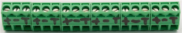

For my convenience, I used a permanent marker to label the terminal blocks for ease of connection. I then stripped some 28AWG ribbon cable and connected these to the terminal blocks in order.
I removed the heatshrink from the battery pack, lifting the edges of the tabs and soldering the tap wires to the appropriate positions on the cells.

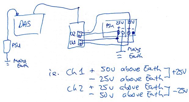

    There is one point I'm not clear on, in your battery test you refer to the voltage inputs as being isolated (as in isolated from each other) but I can't see any components in the device which would achieve this or find any reference in the documentation to maximum common mode voltage or safe voltage to earth. ( Let alone any discussion of common mode rejection.) It looks to me as if all the inputs share a common earth but that in some modes they operate differentially, but are isolated from the control system earth. (There seems to be a single small DC-DC converter in the signal acquisition section.)
    I'd be very interested in your comments on this.

    Dear michaelkellett,
    Thanks for the comment and great question indeed.
    It might be worth referring to the Teardown section in Ch7, specifically to the 20-channel input module itself. I haven't taken the time to trace the PCB clearly, but it seems that each channel has a dedicated pair of OMA160 and OAA160 OptoMOS relays. The units themselves claim to have a 250V rating on the switch side with 3750V rating between control and input/output, and are basically acting like a solid state relay, just that the control voltage is optically isolated. I believe this is where the voltage inputs being isolated from each other occurs, as the onboard CPLD in the channel module probably drives each pair active as the input is scanned. This essentially means that none of the channels share a common earth - in fact, continuity measurements show it to be open (which is why I even dared connecting the batteries in that way). The module itself also seems to have an additional OMA160 which is probably used for bus arbitration (i.e. to disconnect this particular 20-channel module from the measurement bus). This architecture probably comes about due to the expandability requirement of having up to 10x20 channel modules.
    I did mention that the datasheet is a bit light on details - they claim a 100V isolation, but I presume that is channel to channel *and* channel to earth which limits the applications somewhat. They did not supply any further information about this, but I suppose I can ask them about this. You are right, perhaps channel-to-channel isolation figures are good to have too, while CMRR really depends on the earthing. When the unit is operating off battery, it is essentially "floating" unless the earth jack on the rear is used. When it is plugged into the PSU supplied, the negative connection essentially passes into mains earth. The relays themselves claim a leakage current of 25nA with 250V applied, so I suspect the isolation is probably quite good.
    With regards to RF protection - I'd probably have to say, there's not much sadly. While the module interconnection cable is screened and the connector shells complete the screening, the channel modules themselves don't show any signs of protection as such. The casing is just regular plastic without any metallisation that you might expect if it was truly shielded. As with static discharge protection, again, I don't see anything in specific as the connections from terminal blocks go straight into the OptoMOS relays. That being said, as the switches themselves have a fair amount of resistance (which doesn't matter so much for voltage measurements), and the relays are used in telecommunications applications which are pretty harsh, I'd suspect the relays are probably tough. Whether it would survive a pounding from an ESD gun, I'm not willing to say.
    Hope that helps.

  • michaelkellett
    michaelkellett over 6 years ago in reply to Gough Lui
    Thanks - this might explain the low scan rate - every time it selects a new channel the capacitance of the whole acquisition system must be driven to the new common mode voltage - I wonder how  well it works if you alternate positive and negative common mode voltages of maybe 25V and try scanning at maximum speed.
    I have a special interest in this at the moment since I've been working on a reasonably accurate way of monitoring 4 isolated channels on a power supply (and by isolation I mean 250V VAC as a minimum at up to a few hundred Hz).
    MK
  • Gough Lui
    Gough Lui over 6 years ago in reply to michaelkellett
    Indeed, that might seem to be one of the chief limitations of any scanning system. It's worth considering that the switches themselves claim something in the order of 0.125ms on/off times, which in theory would be around 8kHz scan rate at the most, but that only covers current rise to 90% of the final value (or fall to 10% of the final value). The actual scan rate will be limited because the switches have on-state resistance of about 50-100 ohm in AC mode + 5pF of capacitance (which seems small). That is within the OptoMOS itself, but if we account for the 1m of cable the signal is driving, perhaps there's another 40-120pF there at a pinch. I suspect some time is lost because there are actually multiple switching operations which might be performed sequentially rather than simultaneously - the OptoMOS inside the DAS240-BAT, the OptoMOS of the specific module that is being addressed, then the pair of OptoMOS for the channel. So if they are done sequentially, to have some "guard band" time to avoid any potential for current leakage between inputs, I can definitely see how that could cut things down to 1kHz.
    As for the said experiment, I'm not sure I completely understand what you mean as the unit's earthing will depend on whether the AC is plugged in or not. Assuming it is, then the earth of the system is main's earth, but I suspect they threw in the Traco Power converter as a way to isolate the acquisition system's earth from the control plane earth so that it has even less influence on the operation. The measurements are basically switched on both legs, with the inputs to the ADC being pseudo-differentially (0V to Vref, up to Vdd of 5V) measured. But since the signals are basically being massaged by a bunch of instrumentation amplifiers beforehand, I suspect the CMRR and voltage range has been taken care of already before it hits the ADC. With the symmetry in the layout (at least to some extent), I suspect it is differential with no reference to earth whatsoever. Noting that, I suspect there would be no issue if the analog channel's negative input has an offset compared to the mains earth.
    If you would like me to perform an experiment, I'll perhaps need a little more detail - e.g.:
    • Whether I should have DAS240-BAT earthed via power supply?
    • Input DC supply from a power supply with negative side earthed to mains earth?
    • Channel inputs?
    I'm kind of imagining something like this is what you intended?
    - Gough

  • michaelkellett
    Spot on (with your diagram) - I was involved in a project with a similar (accidentally) layout and the issue was that the results were completely different if you put your hand on the case of the DAS or connected it to some other earthed device.
    Only bother testing it if it's fun/useful to you !
    MK
  • Gough Lui
    Hi michaelkellett - sorry it took a day but because you asked so nicely and because I was interested, I performed a few experiments to try and learn more about the behaviour of the channels given common mode voltage.
    I started off with my three-quarter functioning Rohde & Schwarz HMP4040 (didn't need the hefty firepower, but heck, why not?) configured with the first two channels in series providing the common mode offset voltage which is then series into the third channel providing the signal voltage that is to be read on each channel. I prepared terminal input blocks on channels 1 and 2, set to 100V range and with the positive of one block twisted with the negative on the other. Banana to croc clips were used to do the hook-up into channel 3 (i.e. 25V into the negative connection of channel 1, 50V into the positive of channel 1). The zero volt earth comes from the negative side of channel 1 - this is hooked using a lead straight into the chassis earth on the B&K Precision DAS240-BAT as I measured continuity from chassis earth connection to mains earth, and through to the screening on the channel module as well. Thus it really doesn't matter where I hooked it up to, as long as it was an earth (could even have done on the mains earth terminal on the R&S just right next to the socket on Ch1), Maximum scan rate of 2ms was used. This achieves the set-up that we had discussed yesterday.
    Given a steady 25V common mode voltage, the readings were pretty solid - A1 read 25.012V and A2 read -25.014V.
    Suddenly disconnecting the common mode voltage by breaking the earth connection to the recorder (noting that HMP4040's outputs are floating with 150V peak to ground capability) results in no blip on the trace at all. The recorder absolutely didn't bat an eye at the jump of common mode voltage - now measuring A1 at 25.015V and A2 at -25.012V (well within noise).
    Being cruel, I dialled all the rails to the maximum 32.050V setting. This gives a 64.1V common mode voltage with a 32.05V signal riding on it. The DAS240-BAT doesn't seem to care - A1 reads 32.071V and A2 reads -32.068V, which is within its accuracy specifications. So far, so good.
    As for the question of what would the ultimate limit be - I suspect the 100V safety rating they claim will apply for channel-to-ground as well as channel-to-channel purely because all components need to be capable of withstanding the voltage. While the OptoMOS claims 250V switching capability, leakage is probably worse at higher voltages. Other components are probably not so critical, but what is will be the channel connection cable which is made up of many 28AWG conductors with the cable rated at 150V according to the printing on the jacket. Because I measured the earth connection potential is present on the screen, the insulation will need to be able to withstand the difference of any channel to the earth potential to be safe - so maybe 100V was chosen as a round figure for some safety margin and due to the maximum channel input measurement being 100V. I note some other loggers may have ratings of 300V or so from channel-to-earth, so this is a potential limitation of the cable connection system.
    While I had the set-up, I decided I should probably measure channel-to-channel isolation in some way. In the worst case, I'm pumping 96.15V into A1 with an open-circuit A2. Using the maximum scan rate (2ms), A2 reads 6.134V, indicating that the input impedance is not enough to discharge the capacitance of the set-up perfectly. If I reattach the plug, with twisted ends to short the input, the reading is "practically zero".
    How "practically zero" would be the channel-to-channel crosstalk figure. To try and assess this, I had to set A2 into 0.5mV range which incurs a sampling speed penalty - now the scan rate falls to 5ms. Measuring for 8000+ samples with the input to A1 off, and then 8000+ samples to A1 on, I could find the average voltage on A2 for these two states. Subtracting the average on voltage from the average off voltage gives the magnitude of the cross-talk which came out to be 4.924uV for a 96.15V input on the adjacent channel. As a ratio, this is about 73dB which is a respectable figure for a logger like this. I mean - we had to have one channel at the maximum range and one channel at the minimum range, and the cross-talk magnitude is less than half of the claimed accuracy offset term - i.e. 0.1% full scale +/- 10uV. I don't think this is going to be a problem in actual use, and perhaps the impedance of your voltage sources might cause bigger issues.
    Hope this satisfies your curiosity.
