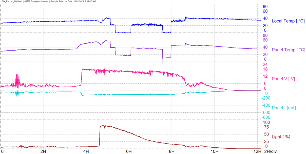

The next experiment I thought of literally involves operating the equipment “in the field”, or more precisely, in my backyard. Despite clear warnings in the manual in regards to temperature and direct sunlight, I decided to create a small rig involving a 12V (nominal) 3W solar panel, driving a relay coil as a load. The voltage would be logged on one channel, with the current measured over a small 1-ohm shunt resistor (converted back into current using a math-channel setting). To round out the sensor types, I dedicated two channels to thermocouples, both of the garden K-type variety. Finally, lacking anything spare that could be used as a brightness sensor, I went with a regular “low-intensity” type red LED as a photodiode, sans amplification, into the final channel which was calibrated to read percentage based on saturation using a 1000-lumen torch.
The unit was placed outside in the backyard, with the unit in a semi-shaded location, screen facing away from the sun in the shade (as direct sun would likely cause heat damage to the LCD). The channel interface was placed on the ground, thus liable to direct sunlight. One of the temperature channels measured the solar panel temperature, while the other was in the air near the channel interface to read the “local” air temperature.
As this was prior to obtaining a compatible USB Wi-Fi interface, I used a Mikrotik hAP mini as a Wi-Fi to Ethernet bridge, powered from one of the recorder’s USB ports to maintain network connectivity. Logging proceeded for the majority of the day, with shading dominating the early part of the recording.
The logged data was then plotted in SeframViewer with some changed settings to enhance readability.
Unexpectedly, the data seemed to show that the operational temperature range limit of 40 degrees Celsius is probably there for a reason – the thermocouple channel readings collapsed by approximately 20 degrees Celsius upon exceeding that figure and then further collapsed to zero (uncompensated), suggesting that there may be a limitation to the capabilities of the inbuilt reference junction compensation. As a result, I recommend complying with the datasheet specifications and not submitting even the channel connection module to temperatures above 40 degrees Celsius. The other channels seemed to read just fine, although attempting to rescale the Current in SeframViewer caused the units to be entirely corrupted due to a software bug. Likewise, issues with attempting to create a computed mathematical channel for power based on multiplying voltage and current values occurred, due to some strange interactions when using a channel that already has a function applied to it for a math channel. This has been reported to B&K Precision, with the hope of future improvements.image
It does show how the DAS240-BAT can be applied to reading multiple physical quantities quasi-simultaneously in the field, although it does show that the datasheet temperature limitations are probably there for a reason and combining or using more complex features may lead to unexpected operation and bugs in both recorder firmware and viewing software.

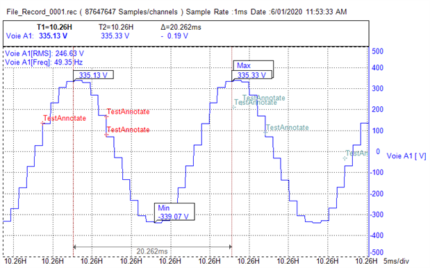

Logging Fast-Changing Signals
As the DAS240-BAT is capable of up to 1kHz sample rate across a single analog channel, I thought I should test it out with a fast-changing signal.
I used a high voltage differential probe to measure the 50Hz mains electricity with the DAS240-BAT.
The unit did log the sine wave, however, the zoom on the unit itself is quite limited and the SeframViewer software uses no interpolation between samples, making it more difficult to interpret accurately (unlike sin(x)/x interpolation). Unfortunately, the DAS240-BAT does not seem to be capable of computing more complex mathematical functions on analog inputs – e.g. frequency or RMS amplitude. As a result, while high sample rates are available, the DAS240-BAT is still most suited to more “steady”, slower changing signals from sensors and transducers rather than AC signals.

A simulated field test was also completed outside in the hot summer of Sydney, Australia on a day when the temperature was expected to reach 45 degrees Celsius. Testing of thermocouple and voltage inputs with scaling factors applied was successful, albeit with unusual results recorded when the temperature of the channel connection module exceeded 40 degrees Celsius, likely indicative of a limitation in the compensation capabilities of the reference junction. Software flaws in both the recorder firmware math channel handling of a channel with change-units applied, and in re-scaling of a channel with change-units applied were also experienced, suggesting the more complex functionality is as yet unpolished.

Testing of fast-changing signals using a high-voltage differential probe and mains electricity was able to demonstrate the 1kHz sample rate reconstructing the sine wave input, however, limitations in the sample-by-sample interpolation-free display made it difficult to analyse the results. Likewise, no channel functions were available to compute RMS amplitude, frequency or process AC signals in any other way. It seems more suited for analysing slow-changing near-DC type continuous signals.
