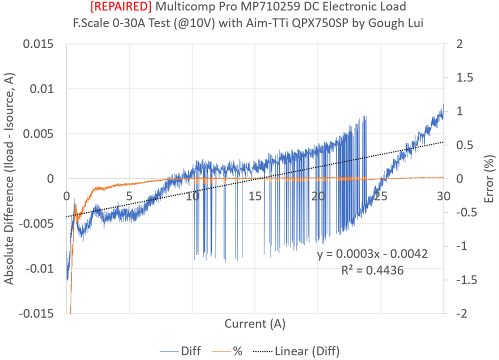

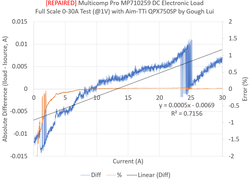

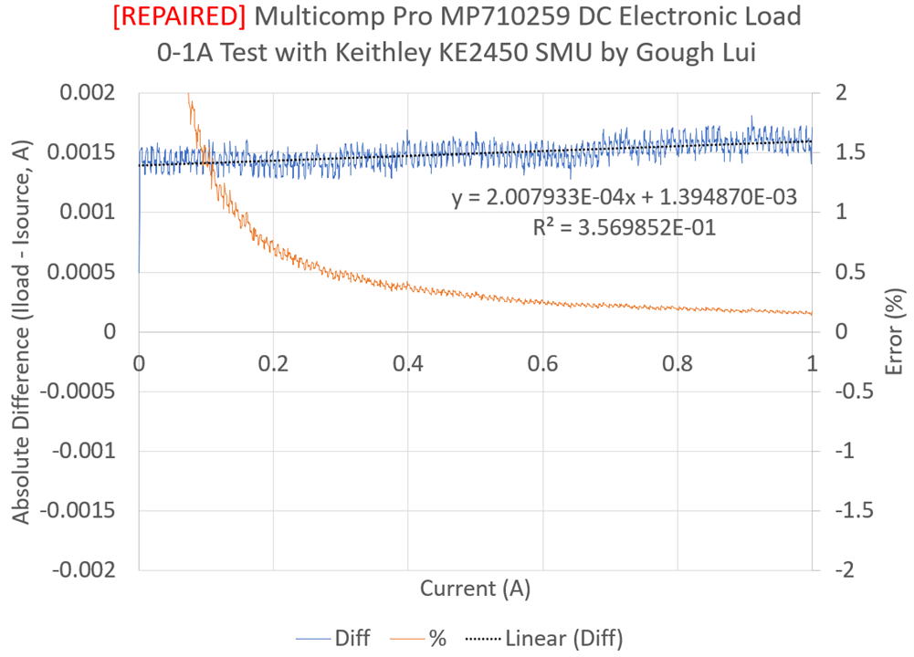

Checking voltage accuracy against my Keithley 2450 SourceMeter SMU across the full range, the disagreement reached a little more than 8mV at the worst and overall, below about 60V, it stays within 3mV. That’s not a bad result at all.
Checking current accuracy at low currents against the SMU showed it was pretty much dead-on accurate except for an offset of around 1.5mA. This would suggest the calibration survived.
Testing across the full 30A current with the Aim-TTi QPX750SP Power Supply, the errors were within 15mA which is acceptable given the QPX750SP reads out in 10mA granularity.
For an additional challenge, I forced the load to drop 10V so that it would test sweeping up to the full 300W and the results were no worse.
Based on this, I can only consider the repair operation a success, as these results are quite similar to the fresh, unopened unit.

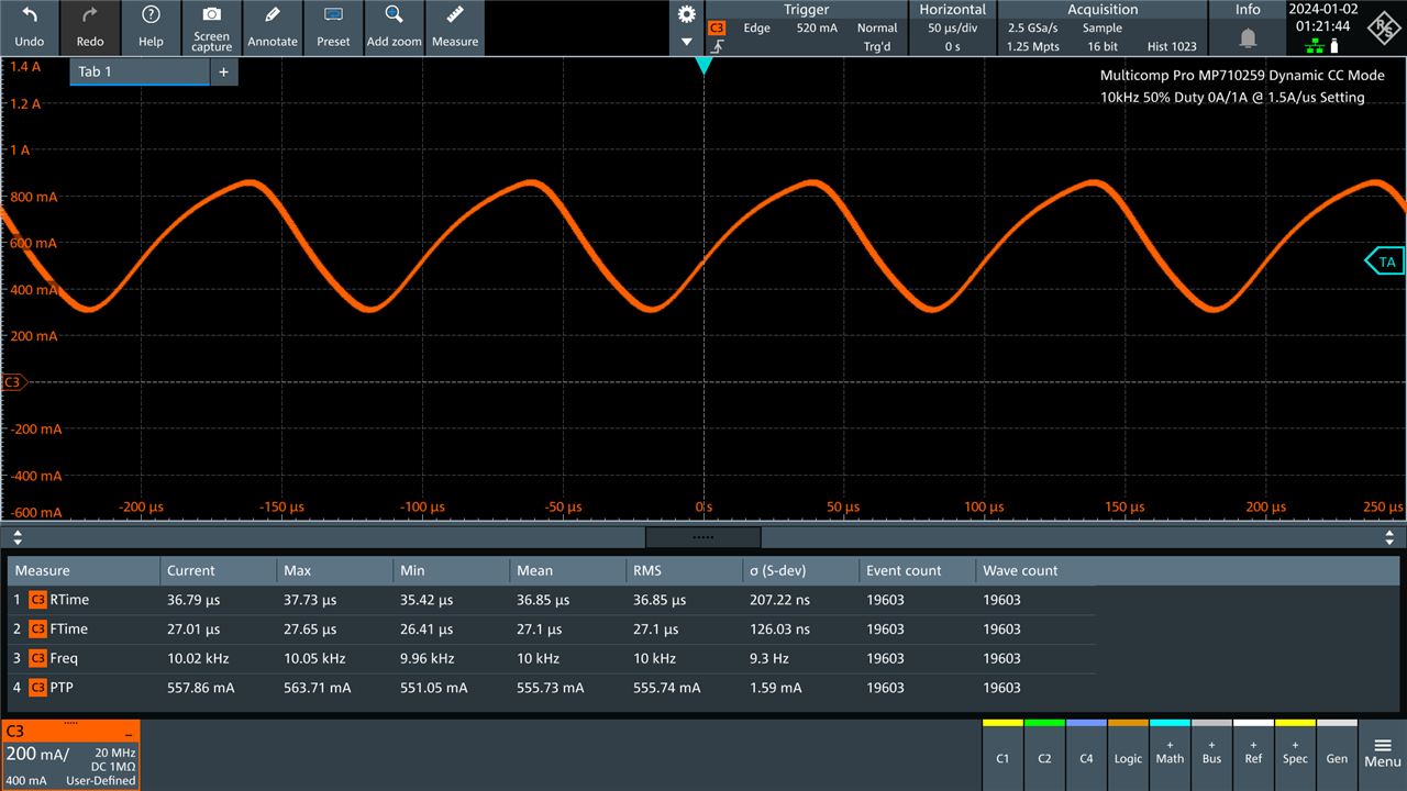

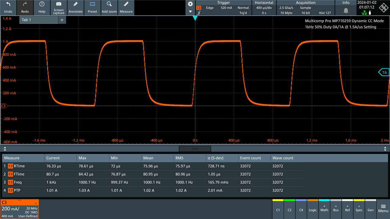

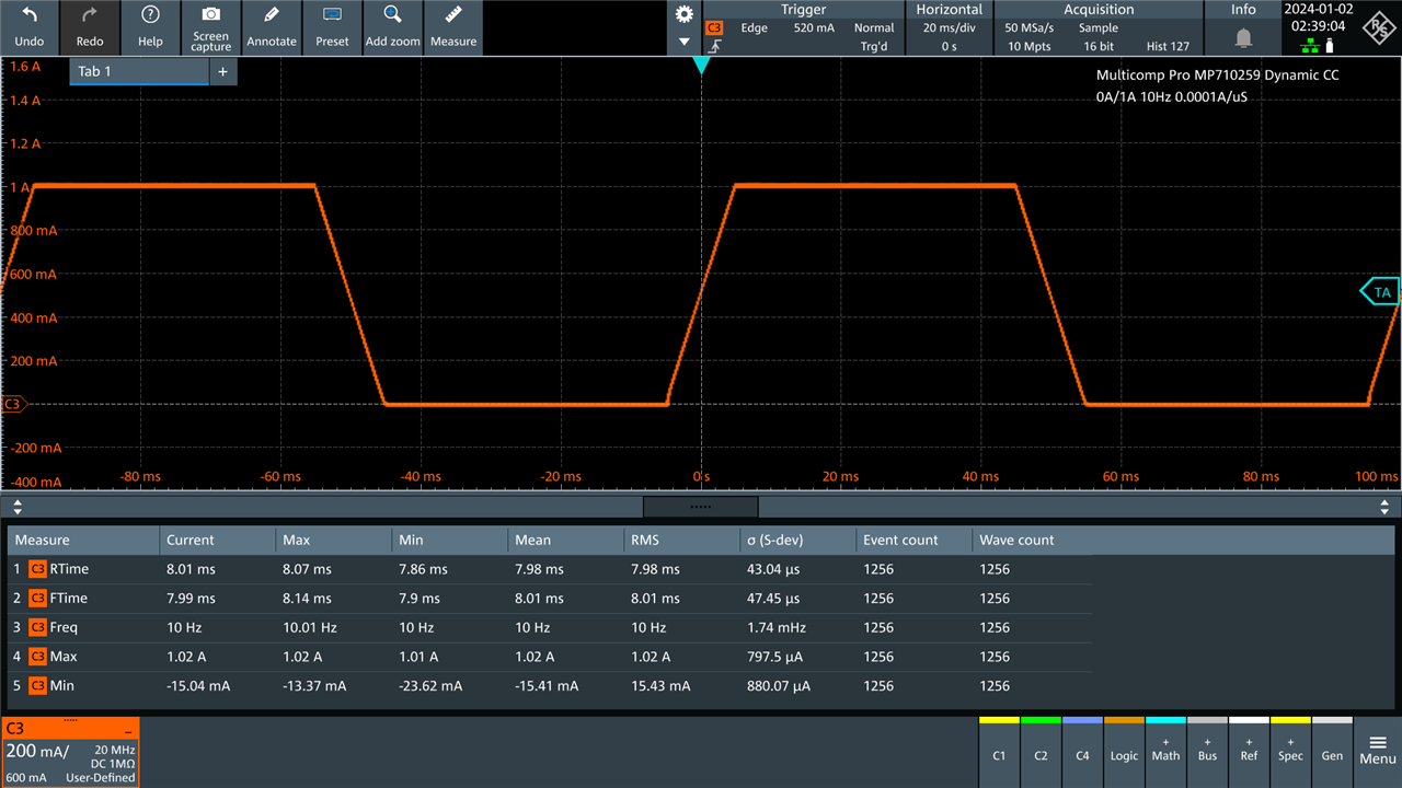

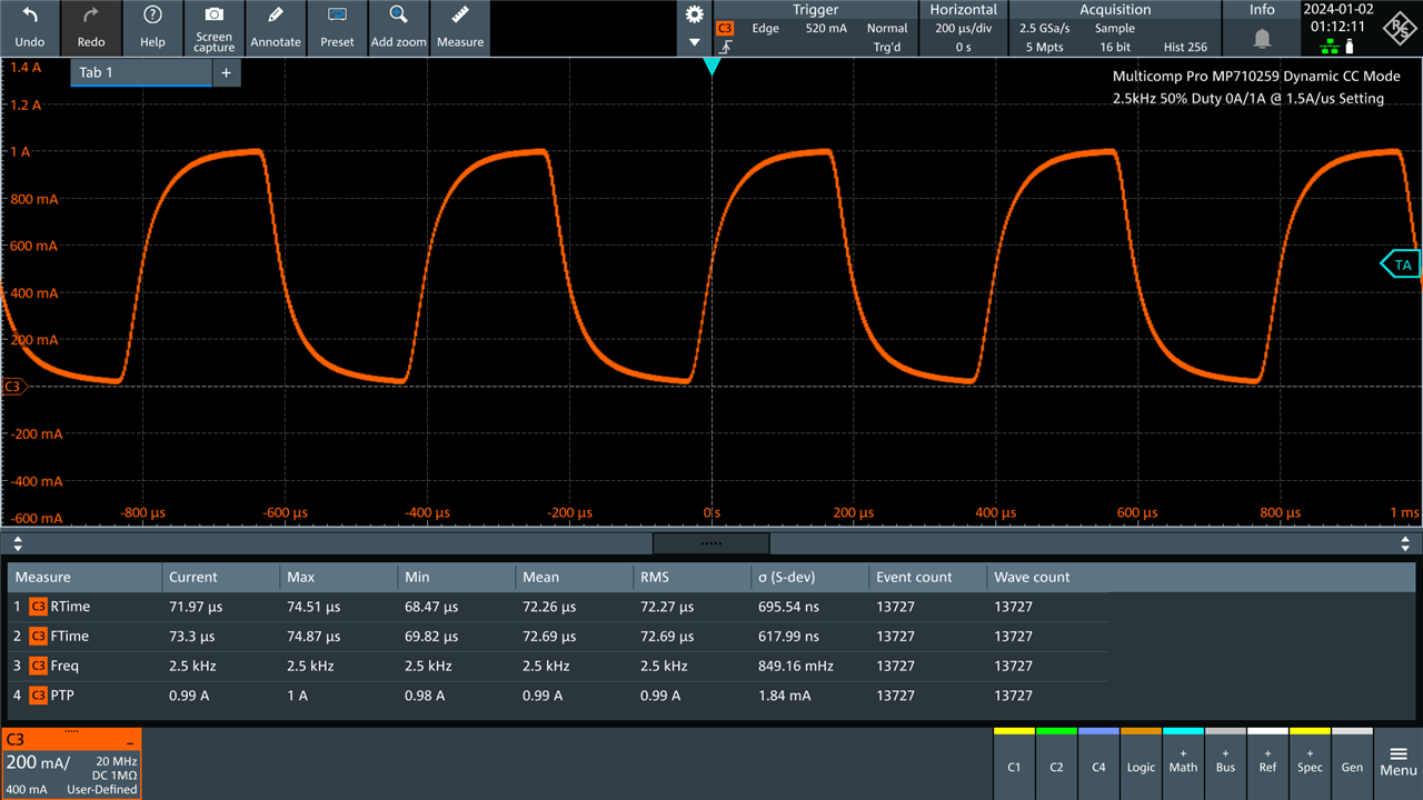

I used a resistor to measure current flow and a custom probe configuration so that the oscilloscope can readout directly in amps. In this case, 0A-1A transients at 1kHz at 1.5A/us slew rate shows that the load isn’t entirely under control, with some “curvature” of the slopes.
At 2.5kHz, I’m seeing something that resembles more of a shark-fin.

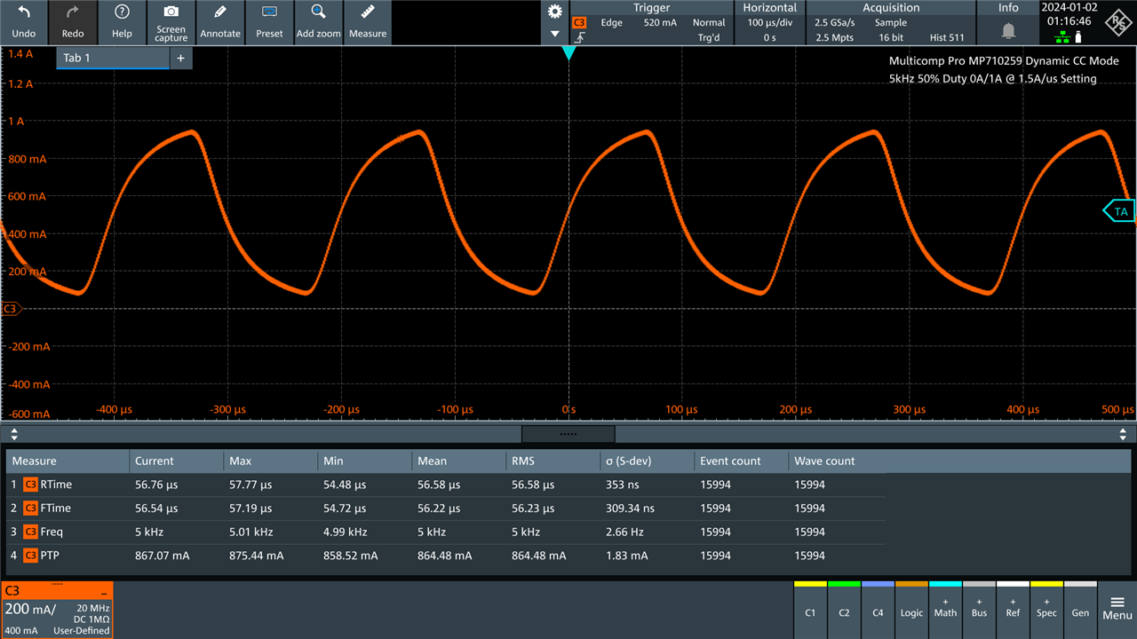

At 5kHz, it’s definitely not a square wave anymore …
At 10kHz, it can’t keep up even with 0-1A thus it results in this sawtooth instead. It’s not quite symmetrical either, suggesting that increasing load is slower than decreasing load. As a result, while the advertising brochure may say 10kHz, it will depend on what sort of current values you’re using.

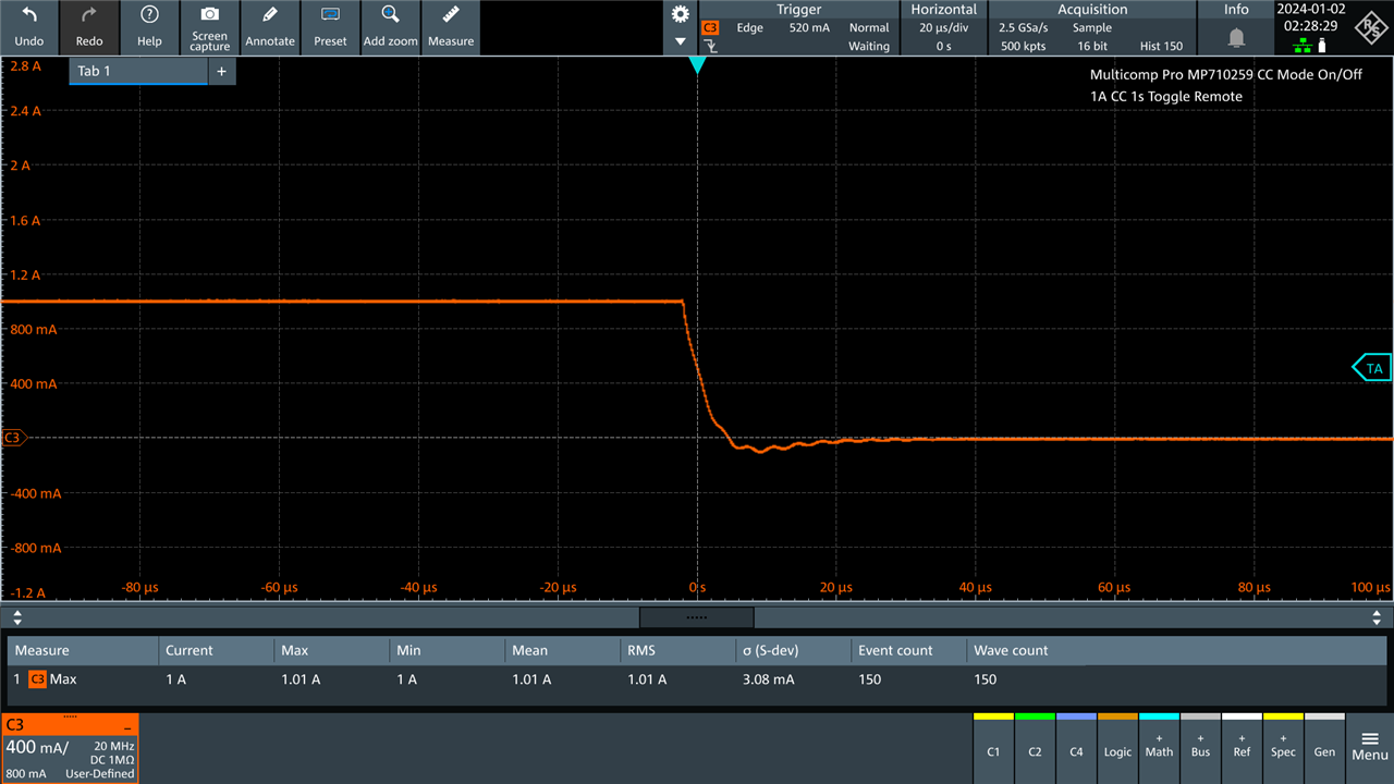

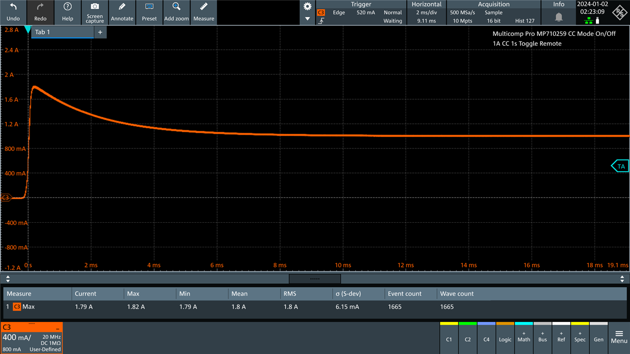

One unexpected shortcoming was that turning the load on or off results in an overshoot. In this case, selecting 1A and toggling the output on and off via remote SCPI repeatedly resulted in this stacked plot showing that the peak current reached an average of 1.8A, 80% higher than programmed, before settling towards the expected value by about 8ms. This is still “fast” by some standards, but is a notable result.
Turning the output off doesn’t result in much undershoot, as expected, as the load itself cannot “source”. Some of the observed behaviour may be due to the Keysight power supply’s regulation loop interacting with the load, however.
Choosing more gentle and slow settings, such as 10Hz and 0.0001A/us slew rate, the output is much better controlled. As a result, it’s probably quite suitable for running pulsed tests on batteries (as long as the pulses are not too short, but perhaps not quite fast and clean enough to stress out high-end lab power supplies (which I still find the B&K Precision Model 8600 to do well on, especially with its Imonitor output).
