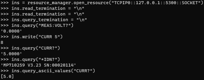

This section will look at remote-control, PC-connected operation of the DC electronic load. The use of the remote-control connectivity is a known source of frustration with this particular sort of load, so let’s see if I fare any better.
I did not test serial (RS-232) connectivity as it is very basic and therefore likely to just work, but also, because the computers I am using do not have native serial connectivity. Therefore, I would be using it through a USB-Serial converter anyway … so why not just use the provided USB?
For me, the USB connectivity just worked. On both a Windows 10 computer and a Windows 11 computer, it was a plug and play experience as the port was USB-CDC compliant and installed the default drivers for a virtual COM port.
It is detected with a USB VID of 0x0416 and PID of 0x5011 which appears to be a Winbond or Nuvoton product, although I’m not sure if this is truly the case or whether they just borrowed this VID/PID pair out of convenience as it seems Nuvoton is against the use of their VID in production.
The existence of an Ethernet LAN port is an excellent feature, as it allows for integration into a larger network of test equipment and easier sharing of instruments across computers. Ordinarily, branded products would implement things by standards such as LXI, but this product does not. When plugging it in, a 100Mbit/s full-duplex Ethernet link is established, but you won’t find any DHCP request or any communications with the load at all.
The use of the CD-ROM proved especially helpful, as I could either refer to the commands for communications or I could simply use their test utility to issue the necessary commands when connected over USB to configure the Ethernet LAN interface for use.
As far as I can tell, the default IP address the unit is configured to is 192.168.1.198 at port 18190. A user can enable DHCP by issuing “:SYST:DHCP 1” to the unit, however, this does not seem to behave as expected. This does enable DHCP and configures the unit to the DHCP address, but it doesn’t seem to enable a full-time DHCP client. I did not see the unit renew its lease and when switching to a different Ethernet network with a different subnet, it didn’t obtain a new lease even after power cycling. The only way to refresh it appeared to be to issue the DHCP enable command again, which is very broken behaviour. To get around this, it is safest to either configure a static address outside the DHCP lease pool, or to make a static binding for that MAC-IP pair so that no other device could potentially conflict.
The app’s discovery for the network appears to use port 18191, which is why the port of the load cannot be configured to this port number. However, as noted by the linked thread, it is broken as the broadcast address is incorrect and thus it never discovers any loads. It is easiest just to configure by USB for the first time, as a result. But even when configured, this utility cannot find the correctly configured load nor issue commands to it. As a result, one has to resort to other utilities to send commands to the load, as it operates using UDP rather than TCP.
By default, it runs on port 18190 and its protocol requires the sending computer to send on the configured port and receive responses on the same port number. I had issues getting socat/netcat to work both ways because of these requirements.
As a result, I decided to write a Python-based proxy program that would communicate with the load on a given address at port 18190, but serve it as a TCP connection on localhost port 5300 so that a traditional VISA could connect to it.
During testing, I discovered that the unit’s SCPI-like command set has a few interesting quirks – namely that all query responses will not provide just the value, but also the unit which breaks query_ascii_value calls. It is also insistent on having a leading colon on short-form commands (e.g. “:MEAS:CURR?”) but must not have them on long-form commands (e.g. “MEASURE:CURRENT?”). It is missing some common SCPI commands as well (e.g. “*OPC?”). As a result, I decided to make my proxy also do some translation work – it converts line endings, upper-cases all commands, adds leading-colons to all non-*-type commands, splits multiple commands, handles queries, translates between OUTP/OUTPUT to INP/INPUT (as this load only handles one variant) and translates function names (e.g. “CURR” -> “CC”). The program is listed below.

This program isn’t perfect – it cannot handle “chained” commands with semicolon characters, and the translation it performs seems to break all LIST, RCL, OCP, OPP, BATT, DYN commands for some reason. But the commands I care about work – and most of my programs written for the B&K Precision Model 8600 that utilise these basic commands just “work” given the proxy is running in the background and the VISA resource string is updated to point at the proxy.
I did debate whether to implement a dummy “*OPC?” command for better compatibility, but at present, I’ve decided against it for now. Perhaps I’ll change my mind later if I choose to improve it later. After all, this was a couple of hours work on a weekend evening aimed at saving a lot of work in touching up scripts to run common tests – an effort I still consider well worth the hassle.
But if you thought the quirks ended here, you’d be sorely mistaken:
It would seem that the Ethernet capabilities were retrofitted using a Wiznet solution, as one might find on an Arduino Ethernet Shield, for example. It doesn’t seem properly programmed – that’s an oddly non-random MAC and the host name seems to have two odd characters in it too. I suspect if multiple loads are connected to the same Ethernet network, there could be trouble as both may occupy the same IP address and/or confuse the DHCP servers. Now two devices with the same MAC on the same network occupying the same IP address may not be unusable as long as both uses different ports and the unit ignores packets to the ports which are not used (which I think it does). But this does complicate things and is not the normal mode of operation – it would be much better if they didn’t do these kinds of strange hacks …

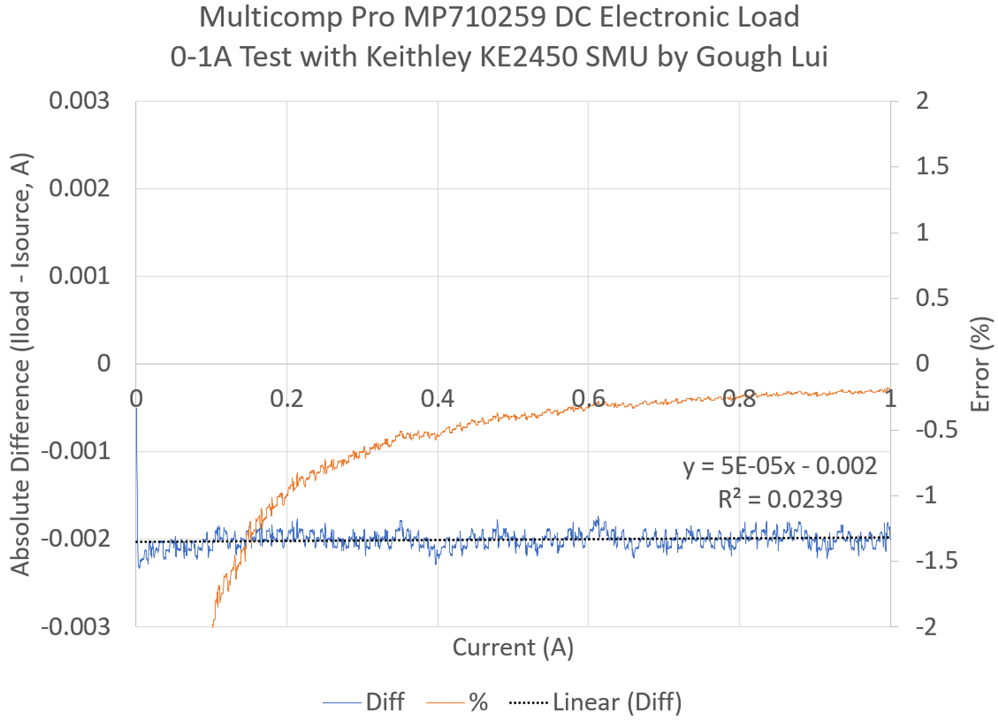

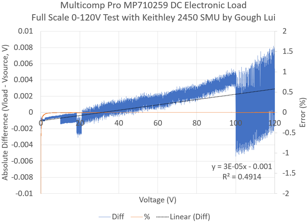

A load is no good if it’s not accurate. The key measurements a load must make are the voltage and current. This particular load appears to report what is on the display to the same number of digits (five full digits, in most cases). For testing, I took 16 readings from the load and averaged them to reduce the influence of reading noise and uncover its true measurement offsets. However, in most cases, it would seem that this is not necessary and the load is similarly accurate on a single-shot basis.
To test voltage, I used a Keithley 2450 SourceMeter SMU to generate a DC voltages in 0.5/5mV steps across the whole range.
All readings were within around 8.1mV of the value reported by the Keithley 2450 SMU which is the most accurate device in my possession. The increase in noise at 10V is due to the loss of one digit on the meter, while the bump at 18V is due an internal range change on the the load itself. The increase in noise at 100V is due to the loss of another digit. This result is extremely impressive given that the specification is 0.05% reading +/- 0.05% full-scale. Even just the latter term would put uncertainty at 60mV at 120V, or 9mV at 18V, which the load easily beat. This is especially surprising given the unit comes with no calibration certificate (which, usually, would not be a good sign).
Testing of current could only occur up to 1A for the 2450 due to the SMU’s limitations. Testing was performed at 0.5mA steps.
Do my eyes deceive me? As it turns out, I double and triple-checked and this result is right. In the 0-1A range, the load tracks the SMU’s measurement practically identically except for a 2mA offset (underestimation by the load). This error is both small but also so nearly flat that I had doubts as to the validity of the test.
While this may seem to support the 0.05% reading +/- 0.05% full-scale specification at first glance, as at 3A full-scale that would correspond to an error of 1.5mA. Unfortunately, this does mean that for the full tested range, the unit is out-of-spec except for at 1A load, as the 0.05% reading term contributes less than 0.5mV for currents less than 1A. I suspect the specification may be a bit optimistic here and this is the victim of an offset error, but it is easily compensated for if you know the behaviour of the unit. Perhaps better calibration would have helped.

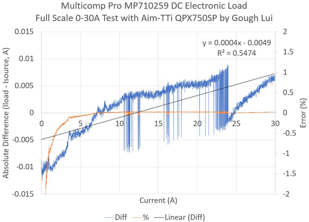

Concentrating on just the low-current values is a bit unfair for a unit that is specified for 30A, so I pulled out the Aim-TTi QPX750SP power supply to give it a full workout up to 30A. Unfortunately, as the supply is only capable of 10mA current setting resolution, the results are limited in their accuracy. I don’t have a meter capable of measuring such large currents, nor do I have an accurate shunt I could use at this time.
While the graph is a little messy, discrepancies are mostly within 10mA either side of zero. Given the setting and readback granularity of the supply is only 10mA, it should be interpreted that both the power supply and load are in agreement with the current across the full range.

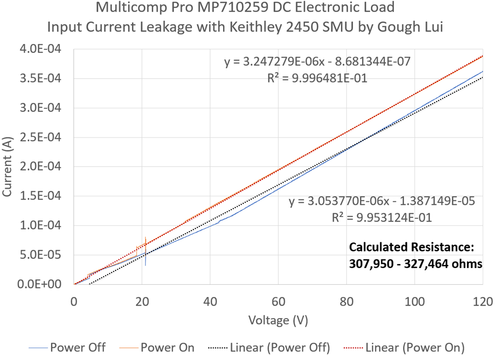

Input Off Impedance
A fact of many pieces of test equipment is that “off” is not truly off – that is, even when the output is off, a small amount of current may be consumed from the device under test. I measured the current flow as a function of voltage with the Keithley 2450 SMU both with the unit powered off and with the unit powered on.
The results suggest an impedance of about 300kΩ, which is a good result and is twice as much as the manual and datasheet suggests. Some of the bumps in the curve are due to SMU auto-zero and range changes, although the one at around 5V and 18V may be inherent to the load.
